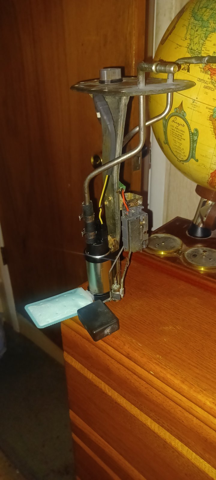

    20230324_183409.jpg I did mine with an oreilys fuel pump cause I was stuck and could not plan for getting Toyota parts. It was their best one for what it's worth. I rebuilt / reconditioned the parts and pieces on the hanger assembly bought a new fuel sock put it together and replaced in truck properly. Still Runs great after 8k.
