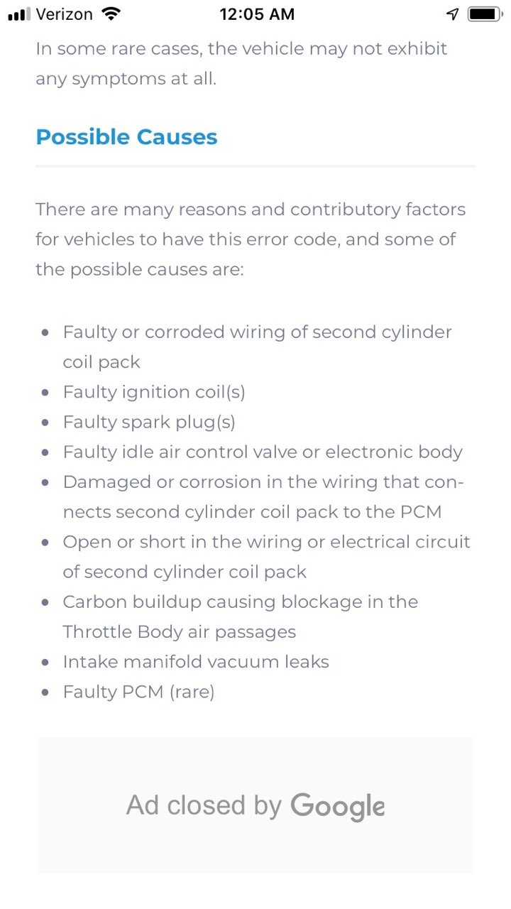

    So, the saga continue . Put a better scanner on the truck over the weekend. Throwing codes P0351-P0356 and it's throwing them 3x each for a total of 18 codes. Nothing else. I find it hard to believe all coils went out at the exact same time. I done a little digging and found several causes for this code and began working through the list. Truck will only run for 2 seconds at a time. Performed a spark test on one of the coils and I'm getting good fire. Cleaned the throttle body of all carbon deposits, looked and listened for vacuum leaks(no luck there, so far). I'm at a loss. Is there another sensor, camshaft or crank or anything, that could be causing me issues like this? This is the list of probable causes I found for this issue that I mentioned working through.

    Also, am I right that this model does not have an Idle Air Control Valve? All the info I found on this was for an 04. What exactly is this "Electronic Body" mentioned here? Saw the same wording a few times but nothing comes up on a Google search.
