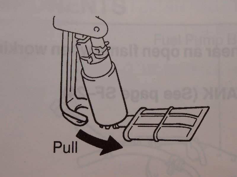

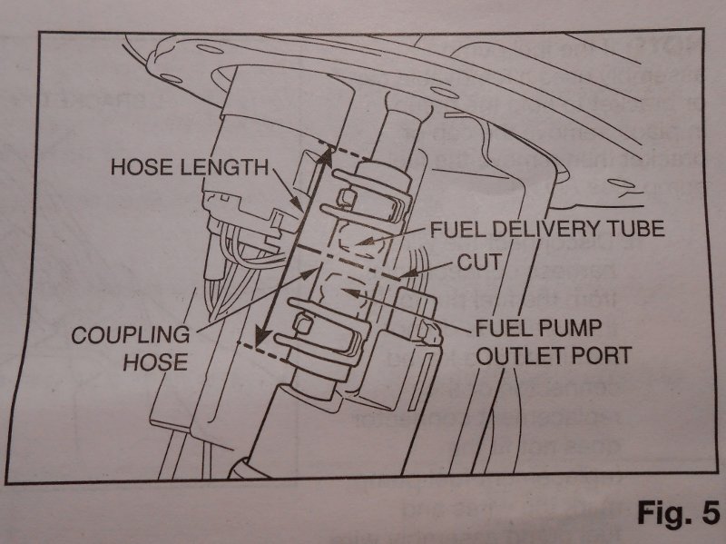

    I can't see any way the connector hose could have come off the pump nipple or the hard line unless the base of the pump came loose and swung away from the sender/pump bracket. There is just not enough space between the 2 nipples.
    Was the pump "in place" with the rubber "isolator" between the base of the pump and the bracket? I have seen one come loose when the bottom of the tank was "re-profiled" from rock contact.
    Proximity of the 2 nipples and hose.
    Only way to remove the hose is to tilt the base of the pump away from the bracket, release the clamp/s, then pull.
