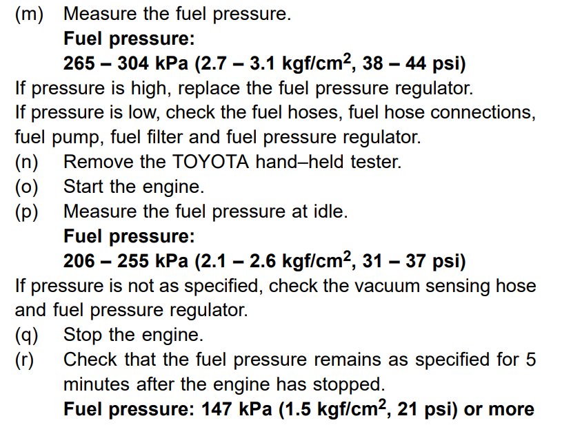

    It needs to hold 21 psi or more for 5 mins.

    The 2.7 ECM allows the pump when cranking (start signal) and/or when it sees a "cam position signal", crank position on the 5vz.
    The system should hold pressure, for a while.
    Below, substitute camshaft for crankshaft in the lower right (NE signal).
    It's a bit misleading in that the ECM will allow the pump with either input signal, it does not need both.
