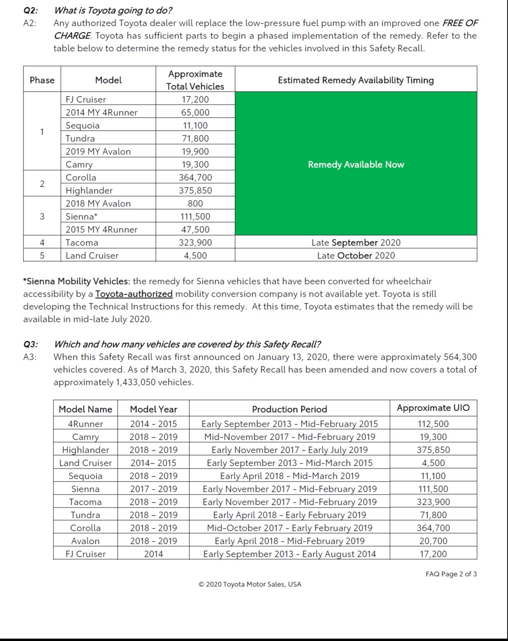

    I have a 2019 Tacoma TRD OR automatic. Bought new in San Antonio Tx . Aug of 19. Mine isn't on for recall. Is Toyota using different pumps for different models? Just curious on why i didnt recieve a recall notice or are all 2019 Tacomas affected?
  9. Sep 10, 2020 at 5:53 PM
    #449
    avi8or_co
    avi8or_co Well-Known Member
    Dec 15, 2018
    #275897
    770
    2022 Lunar Rock TRD Sport
    Pretty sure it’s vin batches...my 19 is an early build...10/18.. it’s included and the pump actually failed.

    It affects the early made 19 and late made 18s. Mine is stuck at the dealer for over a month with failed fuel pump.. both corporate and dealer say the new fuel pumps should ship in end of September

    It's not just the late '18's. My march '18 build is on the list, unfortunately.

    How late does the recall go? My 2019 was built 12/18.

    You need to go to the Toyota owners page (register) and enter your VIN to see if there are any recalls.

    You must likely have the Recal. Mine is 12/18 build and I have it
