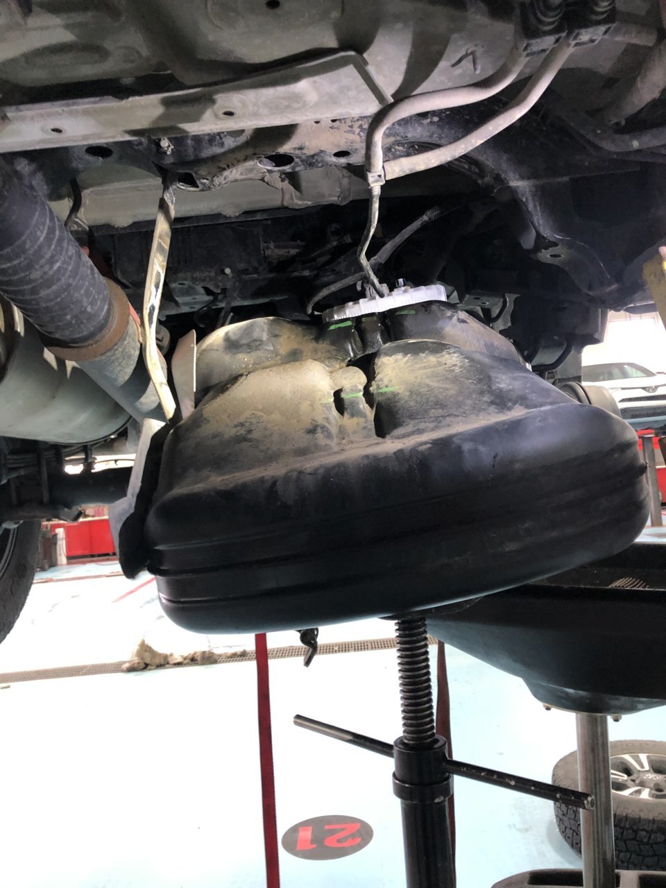

    Here we go, finally got the recall in my region.
    We've been doing sequoias, fj's, 4runers and siennas all by dropping the tank.
    The tacoma is a pain to drop, so we lower it half way.
    I've removed it once but this way proved to be the best and least intrusive. Only 1 evap line and 1 fuel line is touched.
    I've seen one other pic like this, and it makes waaaay more sense.

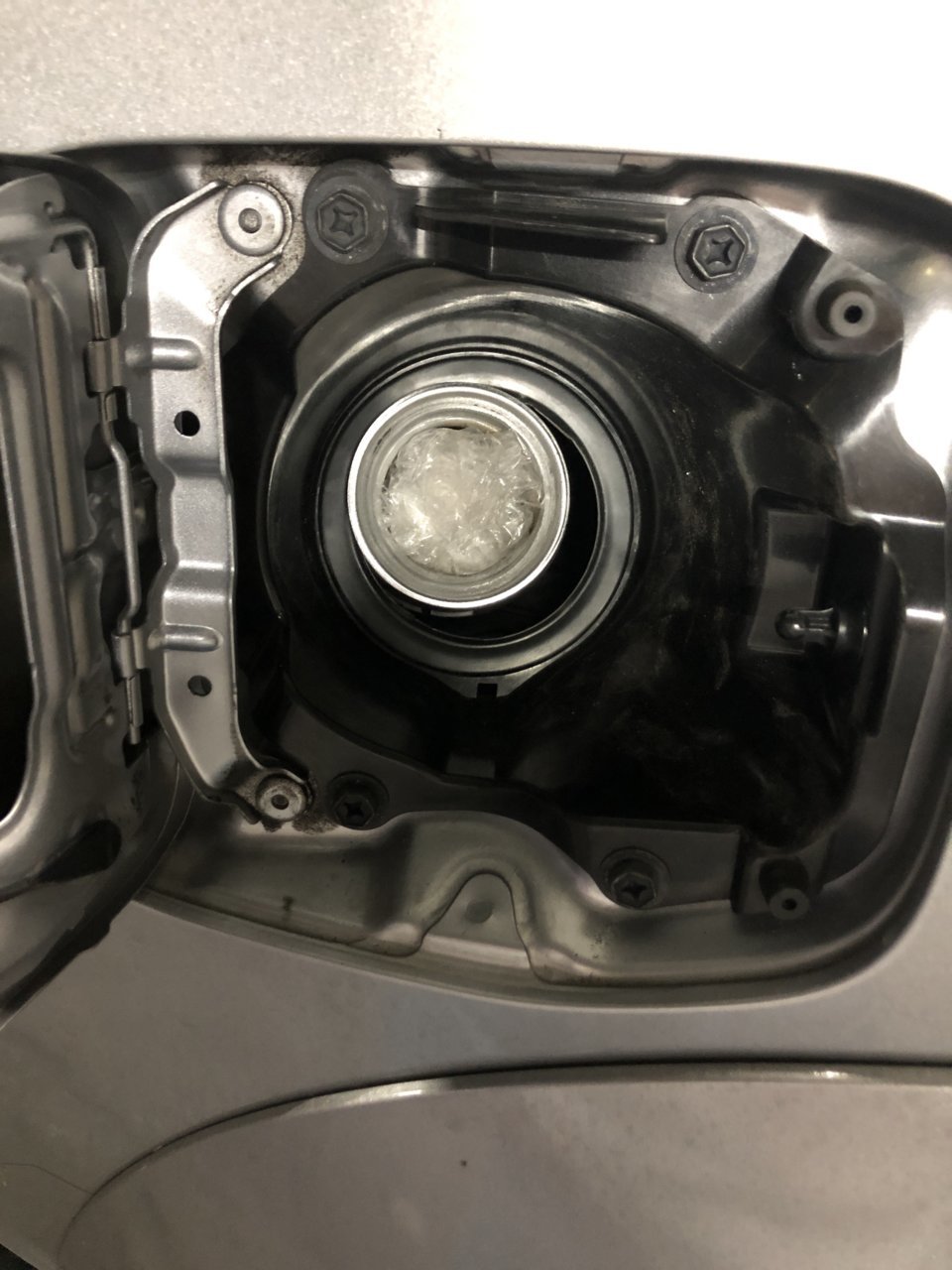

    Hey all, thought I’d add to the list of problems that have been added to our trucks after the recall.
    I had my fuel pump recall done in the beginning of November and noticed that the filler neck for the gas tank was misaligned a few days after the recall was done. I brushed it off and just man handled it back into place with the gas cap on which made it look like it was fixed, but a couple of days ago I went to get gas and lo and behold the neck is still misaligned.
    I’m gonna call the dealership I had the recall done at and hope they can get me in sometime soon to have this issue fixed.
