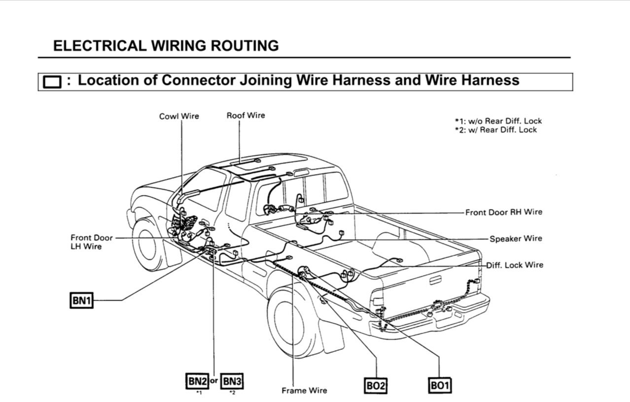

    A good spot to test is the connector under the left seat
    That checks every thing on the cab side is working correct.

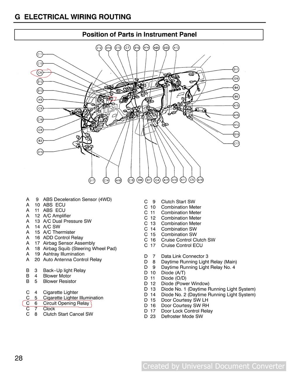

    I can’t seem to locate the Circuit Opening Relay

    I believe it’s under the dash. My power is out at home currently. And it a royal pain it a$$ navigating diagrams on a small phone. As soon as I get power back. I’ll post a diagram.

    My 2000 the circuit opening relay is in the dash almost above the steering shaft

    Here you go, what kind of problem are you trying to track down?

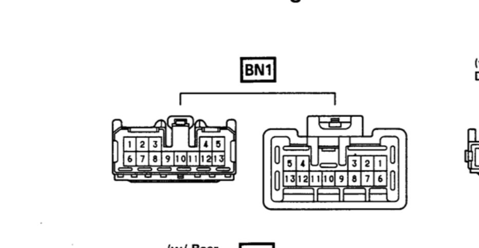

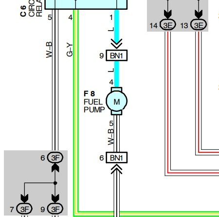

    Definitely sounds like a fuel problem if it runs on starting fluid, the easiest place to check for power going to the fuel pump is at connector BN1 under the seat.
    Pin 9 (Blue) is power going to the pump and Pin 6 (White/Black) is ground to the pump, you should see battery voltage between those 2 wires while cranking.
