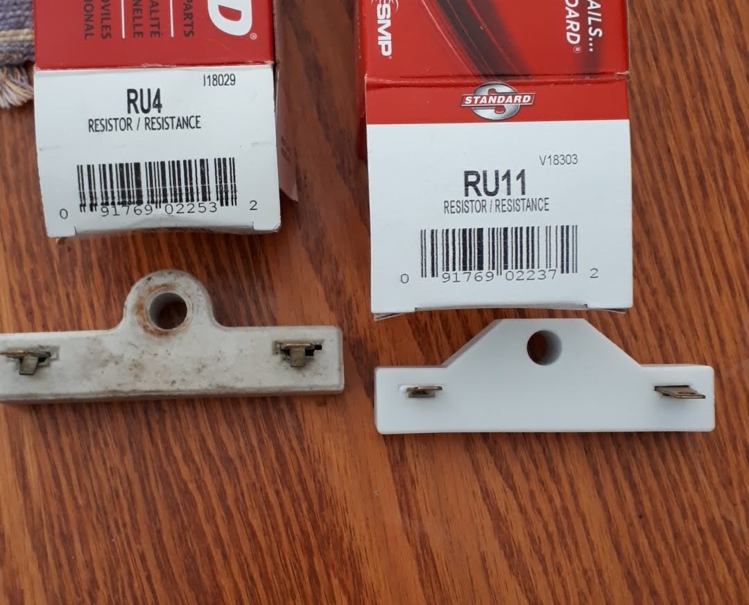

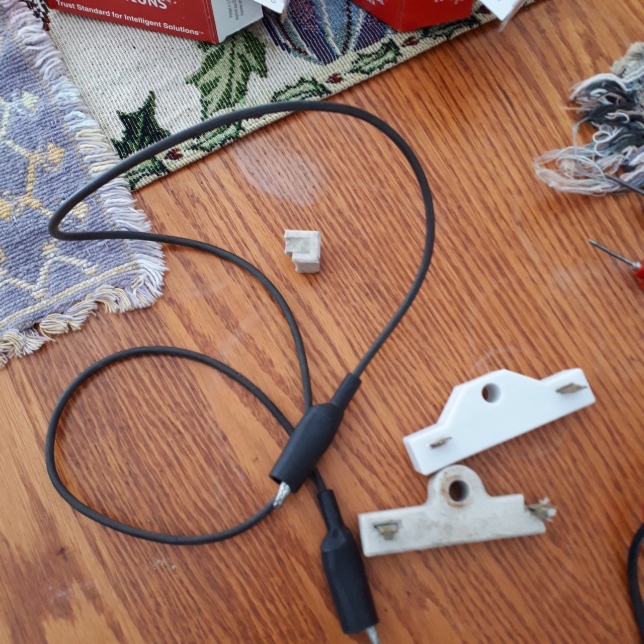

    20201231_115046_Original.jpg 20201231_113252_Original.jpg So, my original fpr died, hence the post I started.
    https://www.tacomaworld.com/threads/help-2012-taco-died.680981/
    After all said and done, mechanic jury rigged this Chrysler(?) ballast resistor, and everything worked fine for the last 4 months.
    Then last night that gave out, got truck going again with a jumper.
    I had already bought a spare resistor, and now the truck runs again.
    Hope this helps someone.

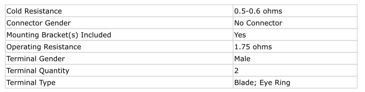

    I can’t seem to find the information on the stock resistor at the moment.
    But I’d like to know the the difference between your setup and the OEM.
    Here is the specs for the one you have pictured.
    @Jimmyh might know?
    And would this cause the pump to run too slow or fast?

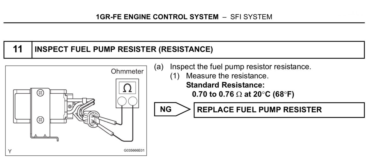

    I'm not sure of the specifications either. If I had one on my truck I would go out and measure it. Not applicable to the 2.7L four banger...
    But you are correct that if the resistance was too high the pump would be running slower than it should when the resistor is in the circuit.
    If I remember correctly the resistor is only about 0.7 Ohms at 20 degrees C. Not very much.
    0.70 - 0.76 Ohms is the specification.
    So with him running a resistor that is operating at 1.75 Ohms. More than twice the resistance of OEM resistor. Pump is definitely running slow with the resistor in the circuit.

    So to answer a few questions in one post: originally when this happened, the oem resistor tanked. Garage in hick town I was stranded in couldn't get the oem part, and tried this RU4 resistor that he'd had success with a year earlier on a Tundra. Oem was $177, RU4 ~$15, and worked, for 4 months. So being cheap as I am, went to get RU4, but no one had it, and showed me this RU11, which looked so close and does the job on test.
    But now reading your posts ( thanks to all for the insights), I'll see if I can return the unused RU11, but regardless get the proper oem resistor.

    Just to interject another thought. As long as the resistance is within the ratings 0.70 to 0.76 ohms and wattage rating any resistor should work fine. The problem is that we don't know what the factory wattage rating is.

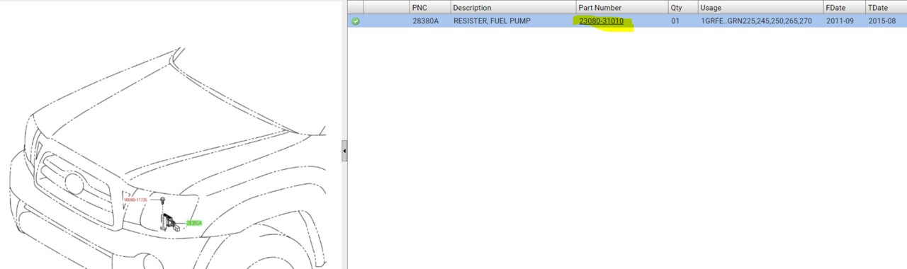

    I believe I found the specs
    Jimmyh and Marc70[OP] like this.
