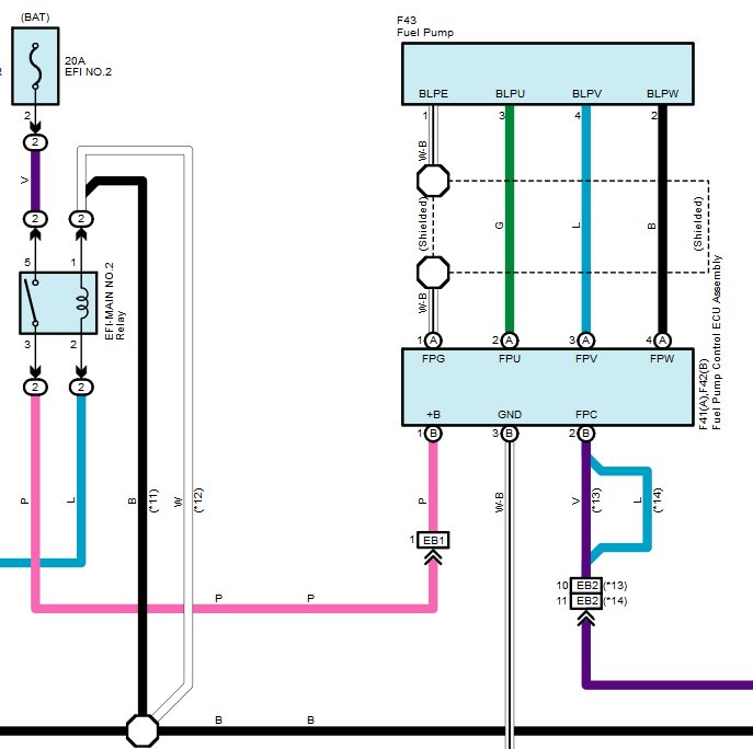

    [3rd gen] Toyota Tacoma fuel pump is a three-phase brushless motor.
    The older 12V fuel pumps are bushed motors, btw. The fuel pump sits in fuel, which provides cooling. If the pump stops working a tap with a rubber mallet would help 'bump' the position of the pump's rotor, so it would start spinning again.
    The modern fuel system (no return line) went with a fuel pump ECU. Speed is determined by the pressure sensor. The Engine ICU sends out a PWM signal to the Fuel Pump ECU. The Fuel Pump ECU is powered by that ignition relay, FPC - Fuel Pump Contor is a PWM signal from the Engine ECU, and creates the three-phase motor speed control. The FSM will point out the three wires to the fuel pump should all be around 1 Ohm resistance. Spec calls for 0.05 to 3 Ohm per phase.
    You could sneak a wire probe into the wiring between the Fuel Pump ECU and Fuel Pump to see what that frequency is.

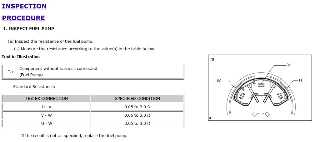

    I’m assuming the “G, L and B” represent Green, Light Blue and Black for color code of the wiring ?
    for shits and giggles , I’m gonna measure the resistance at the plug exiting the rail module and see how far off the resistance is at that spot. In theory, it should be close if the harness is ok.
    I may also attempt to check resistance between the shield and the frame. That I should have no resistance on if the shield of that wire is doing it’s job.

    243
    Pottstown PA
    No dice on the shield continuity. Without seeing internal schematic, hard to say if that shield is even stretched to ground ( though is should be for proper shielding)

    You probably already came to this conclusion, but putting ferrites on each individual motor lead is perfectly fine with PWM control. I design industrial equipment for a living, and we put ferrites on our PWM controlled BLDC motors all the time for to meet EMI requirements (most common for CE) with no demonstrable downsides. One ferrite per power leg, keeping each leg separate. The ferrites go either at the controller, or motor depending on where the noise is coming from. Now if the noise is radiating out from the motor itself, this won't help of course.
    I am also a bit interested in that shield. It's hard to tell how it's connected from that picture. If there is no shield continuity (as you indicated) then I doubt that shield is doing anything other than looking nice on a schematic... Of course there may be a cap somewhere in the shield circuit, which could make a continuity test fail. Like you indicated, internal schematics would be best to determine how the shield is wired. I would like to hope that Toyota knows what they are doing, but weirder things have happened.
