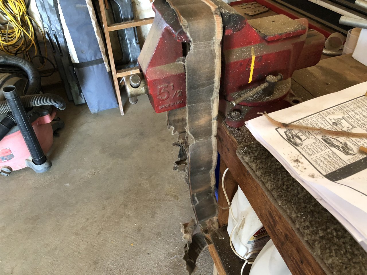

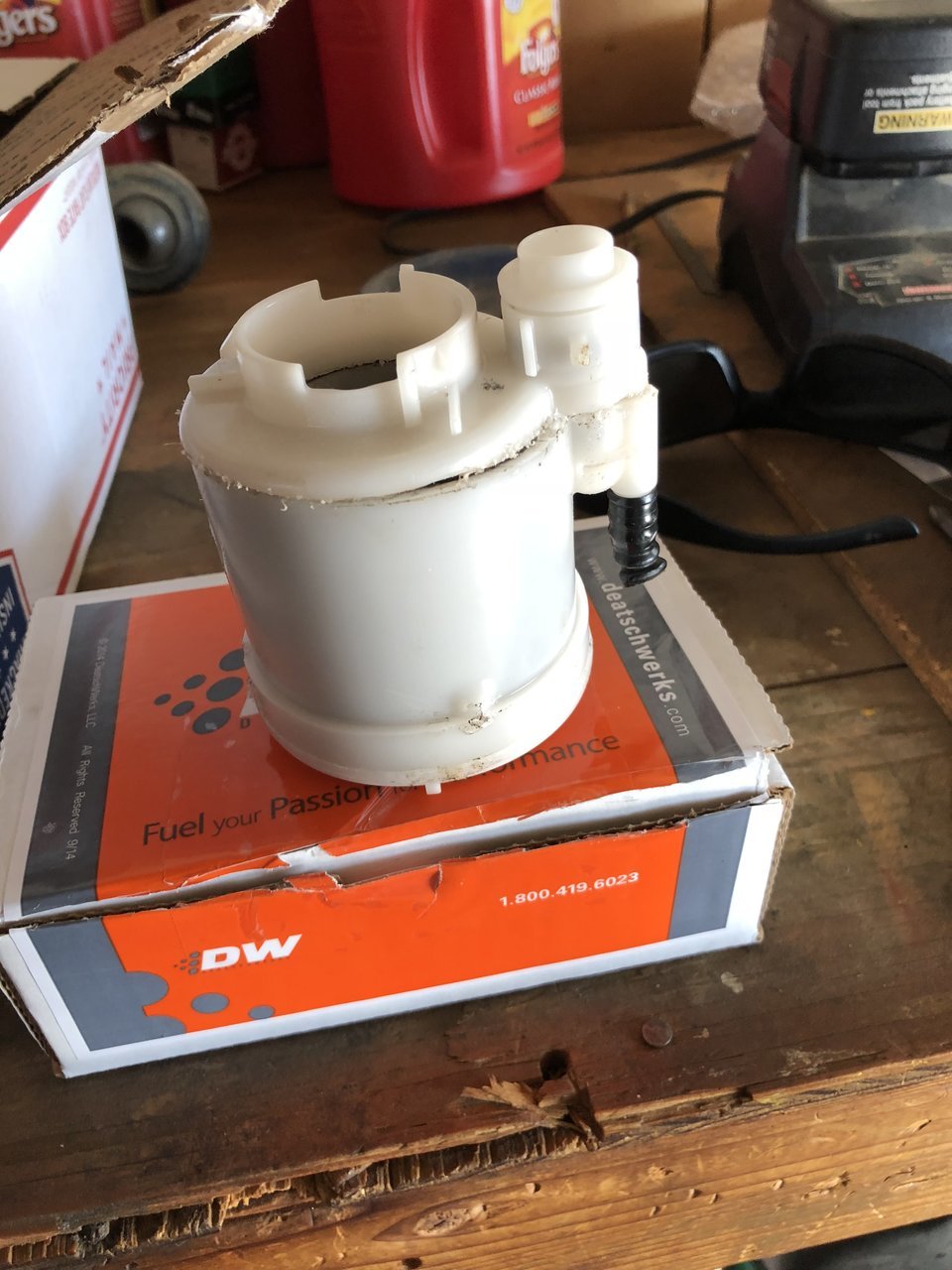

    It’s not the filter sock that is the issue. The actual filter is embedded into the fuel pump housing with no way to remove it with out hacking it up. See observations below:
    C0C3958C-1215-4394-9FFF-8E2ACB12B773.jpg 1BDB25D7-7384-4DA7-BF62-FB89FADD3F9E.jpg 5EF39758-2D34-471F-9325-4ECA2D9E5ACE.jpg
    That cardboard like material is the “filter”
