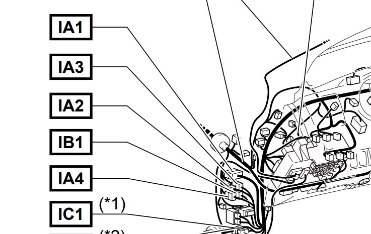

    Connector IB1 Pin 4 (Black/Red) behind the left kick panel is a common spot for a burnt pin.

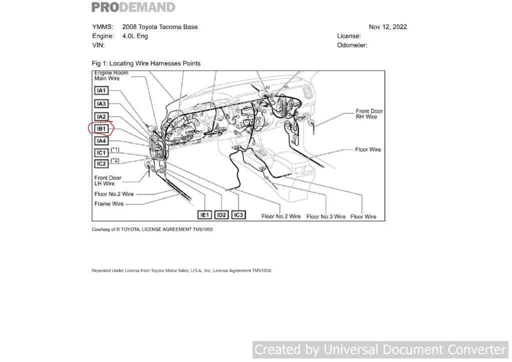

    See the picture I posted for it's aproximate location and the connector view.
    It has 18 pins and the Black/Red wire will be in Pin 4.
    If you post a picture of the connectors behind the kick panel I can probably ID it for you.

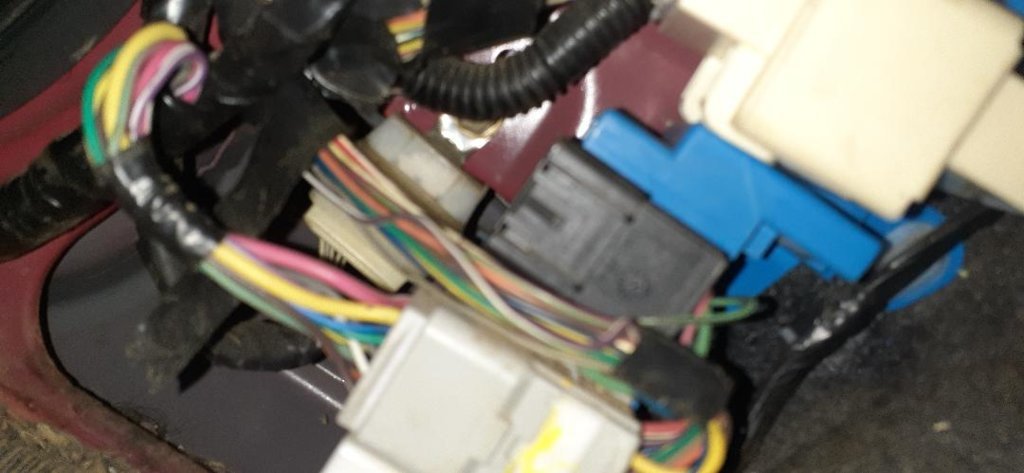

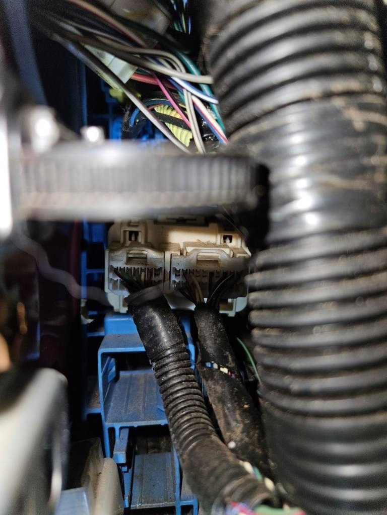

    Hard to tell perspective from that angle to label those but IB1 should be the 3rd connector from the top toward the dash side.

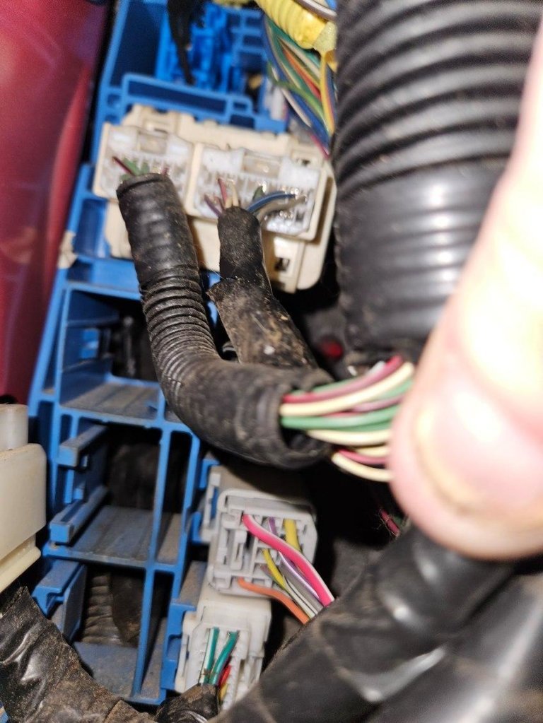

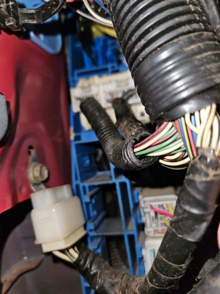

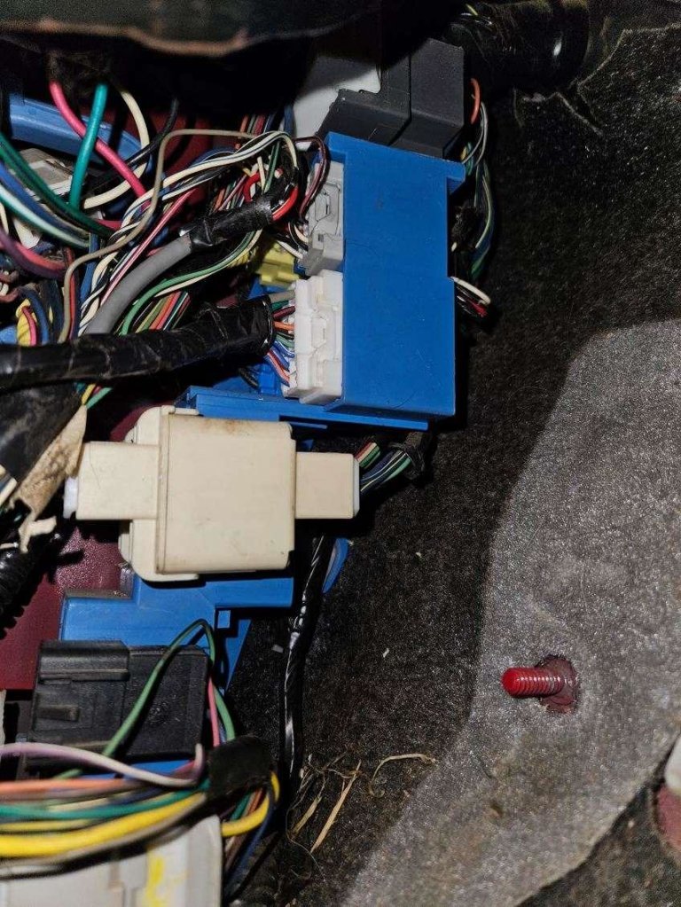

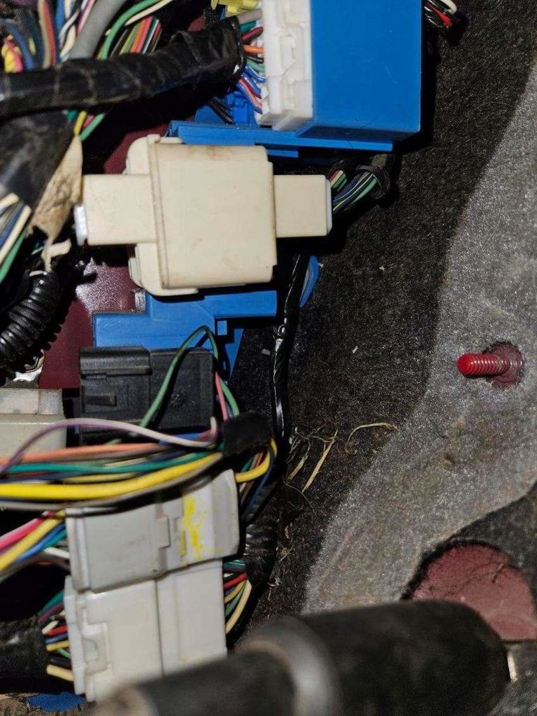

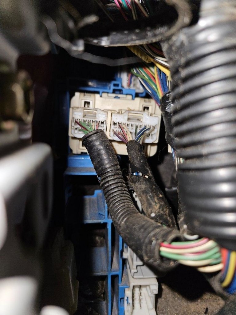

    Dm93[QUOTED] likes this.

    Maybe one of these pictures will help

    Pretty sure that's your connector and Black/Red wire right there (circled in red), I also see some aftermarket wiring shenanigans going on (circled in blue).

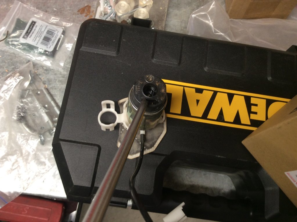

    So the picture I posted of the fuel pump has / needs an o-ring in that line connection. The new pump doesn’t come with that o-ring. If you didn’t at least transfer the old o-ring to the new pump, no fuel pressure.
