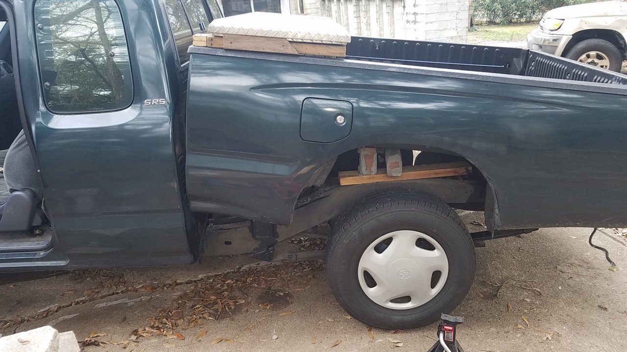

    Earlier in the year I changed both my fuel pump and filter solo by lifting the bed - far easier than dropping the tank. And have since done this with multiple trucks. That said, my method of doing it is very risky and honestly can't truly advise without heavy caution, since if you mess up the bed well may make you a chopped pancake haha.
    I will say though, I think my method is the easiest especially if you're not overweight. Because you can do it solo, don't have to realign the bed to the bolts (which require 2 people), don't have to remove your tool box or gear/junk from the bed (within reason), and is easier to do than dropping the tank.
    Procedure:
    First you undo your tail light wires (go ahead and also undue your negative battery terminal to be safe), and unbolt all 4 bolts that hold your bed to the frame.

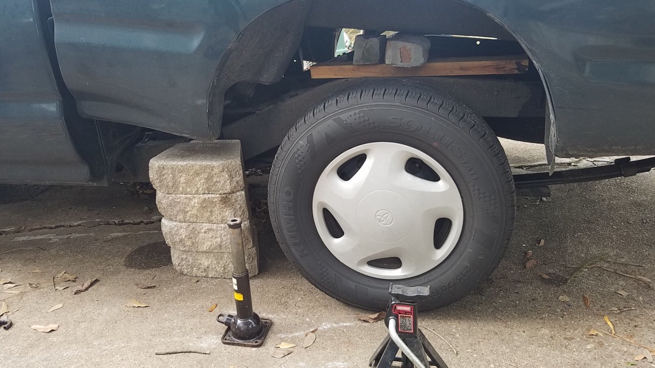

    Now the image below you see where the cinder blocks are? that is where your going to jack up that side of the bed block by block. Each cinderblock (or anything really) you raise the corner of the bed, you in tandem put a safety block where you see the wood plank in the image (do this on both sides of the truck). I recommend not doing what I did using bricks, and instead using something less abrasive like hard sturdy wood, since the bricks chafe whatever they touch whereas the wood doesn't. Be careful here as its imperitve you make sure each step up in height you jack up the truck it is safely "jackstand'ed" up with whatever materials you can fit in there. You mess up here, and the bed could slip and fall on you while your under there which is why what makes this method so dangerous. You can shake the bed a little to make sure its sturdy.

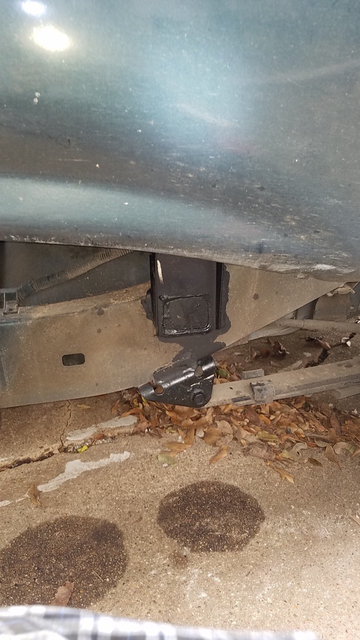

    See this darker wet part (in the image below) of the frame thats next to the edge of the leaf spring? This is the exact location I used to jack up the frame, as it is where it has the best amount of support, and spot to lift to make the bed go up horizontal, and not diagonal (which could cause the bed to rub up against the cab frame). Be very careful you jack it up here slowly making sure its very secure and wont slip off. You can also jacking it up from both sides to be xtra safe, but I felt fine just jacking up the one side - though for safety reasons I'd suggest doing both if at all possible.
    Below is how high I ended up lifting up the bed, and how much material I used to "jackstand" the bed up. You can go higher for more room to work if needed. Mainly jsut want to raise it high enough to get enough working room for your body size, and avoid having the bed touch the cab frame.
    Once you raise it up all the way you have it up to your liking, you remove the cinderblocks (in the first image where you jacked up the truck), and now you can get to working on opening up the fuel tank. That said there is more tricks you will have to overcome though which are also difficult such as unplugging the electrical plug that could be overly corroded and hard to take off in a tight spot.

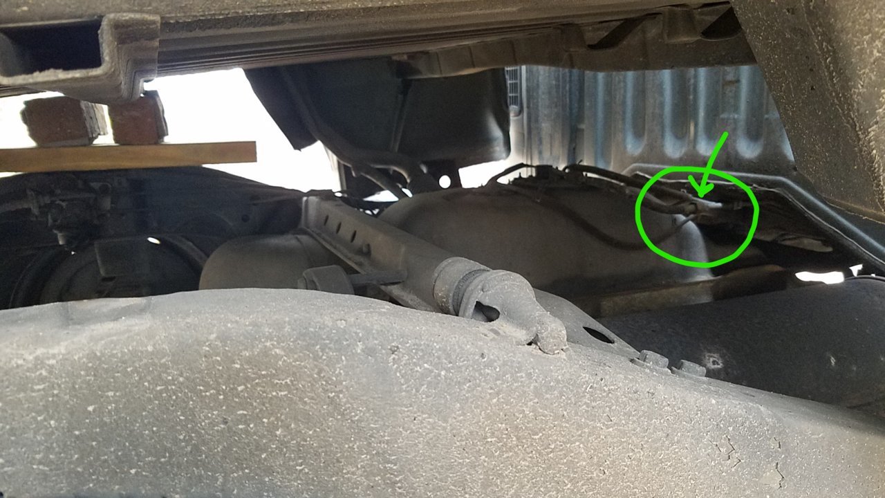

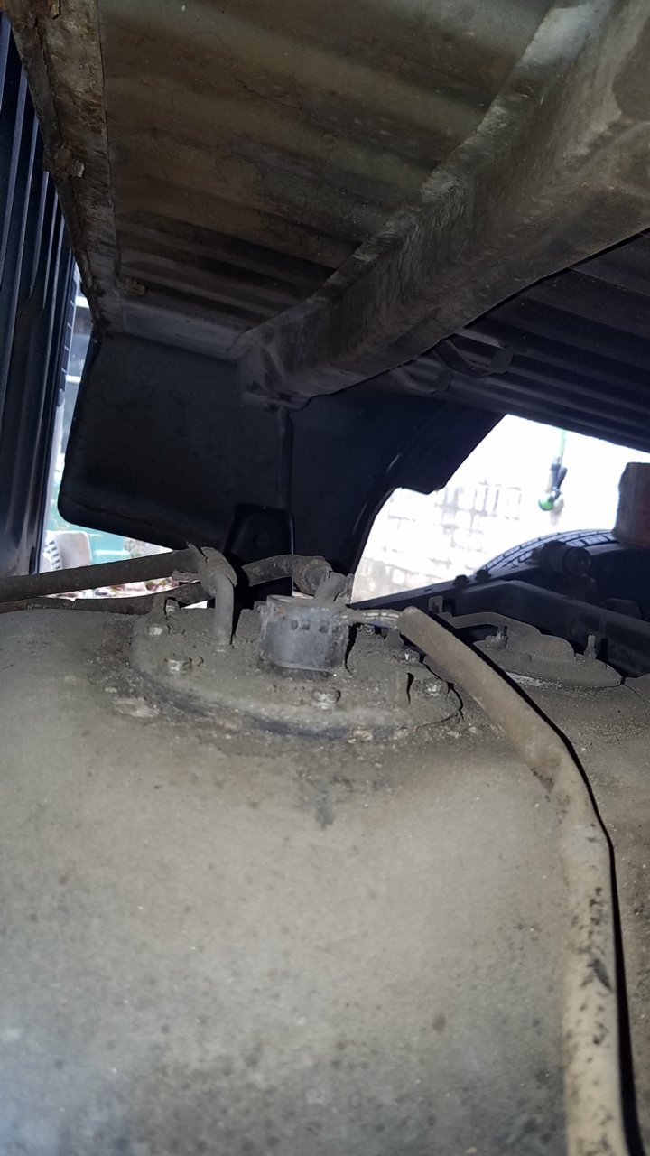

    also VERY IMPORTANT to fully lift out the fuel pump once you undo all the bolts you will have to untighten and disconnect one of the fuel lines below so you have more slack to completely pull the fuel pump assembly out of the fuel tank. DO NOT try to remove the fuel tank assembly out of the fuel tank without disconnecting one of the fuel lines. You trying to force it out in that tight spot may end up with you accidentally knocking something and causing the truck bed to collapse. Albeit its a little unlikely, but better safe than sorry.
    You can either losen the hose from the from either where you see the hoses in the 1st image below connected to the fuel tank cap, or further back where you can loosen it with a two wrench squeeze on the bolt via the arrow in the second image below (which i recommend you do this method as its easier to do if you ask me. Just be sure to wear eye protection due to loose gas and grim falling right on your face).
    Once you get the fuel assembly out, its pretty much smooth sailing in just replacing the pump. Also recommend installing a new fuel tank gasket as well, though isn't completely necessary given its in okay condition still.
    Now all you gotta do is put the assembly and cap back on, connect the fuel hose again, and slowly jack it down the same way you did while jacking it up (continually using supports as you jack the bed down). Good thing about this method is the bolts still will perfectly align to the frame so you can just install the bolts right back on without having to adjust the bed around. Once thats done and you can connect the tail lights and battery then you're good to go. Also don't over torque those small bolts holding the cap to the tank - they can snap easily so do it slowly in a crisscross pattern keeping in mind the gasket is getting squeezed with each turn which could be misleading in how tight it is you're torquing.
    Hope this helps, and if you decide to use another method, no worries and more power to you and best of luck haha. It is pretty easy though after you figure it out on the first go around.
