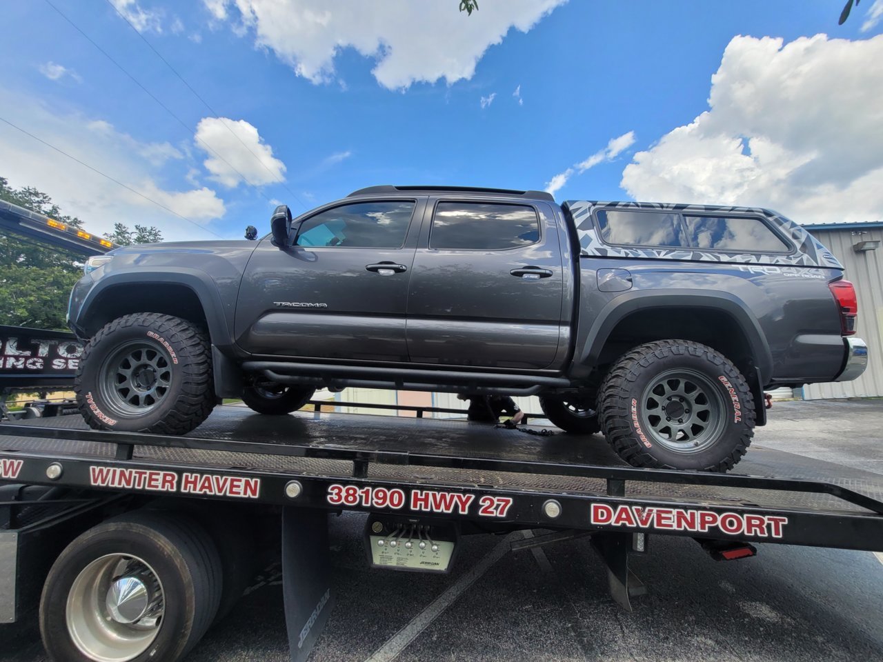

  9. Jun 12, 2021 at 2:25 PM
    TRD4X4TOY
    TRD4X4TOY Well-Known Member
    Dec 25, 2019
    #314154
    662
    2019 Toyota Tacoma TRD OFF ROAD
