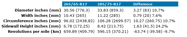

    I’m in Oklahoma and the truck originally had 285/75 r17’s on it from the previous owner so I’m wondering if that has anything to do with it? Maybe I need to reset the computer? I feel like I’m grasping at straws here. But I should at least be getting more than 250-270 per tank.

    Those tires are for sure gonna throw your mileage off a bit. Almost 11% larger than stock size. The extra weight of a tire that size will eat up your MPG’s pretty quick too.
