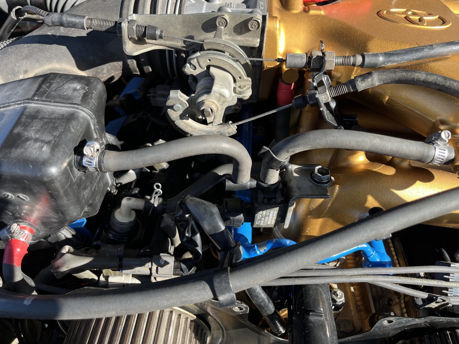

    I am putting my engine back together and am stuck. Where does this line go to from the fuel regulator. I think it was originally went to one of the plugs on the throttle body but both have been capped off. No other nipples are near by. Please help. Truck is a 1996 Tacoma 3.4

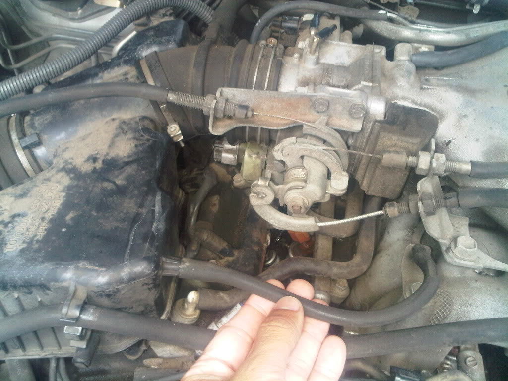

    here is where it is on the front

    189272d1501885158-3-4-no-fuel-pressure-r_9b16e2640772848bd5a25fa6dcf8c0df4a3e800d.jpg
    not my image, just for reference
    could always just run a tube up to the airbox but the solid line keeps it from getting damaged or in the way

    This so what mine looks like there is already something plugged into that nipple. Also thank you so much for your help

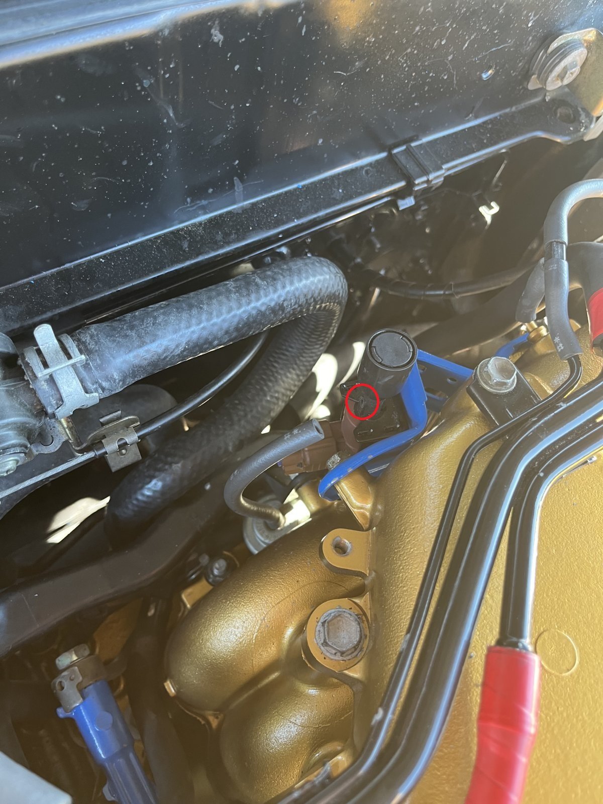

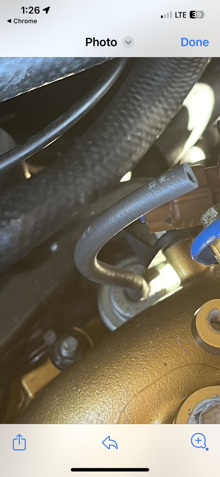

    It's less Tacoma and more mod
    It went here on your year, but your nipple snapped off.
    I have one of those I removed from my truck if you want it, or you can bypass it with little to no repercussions.

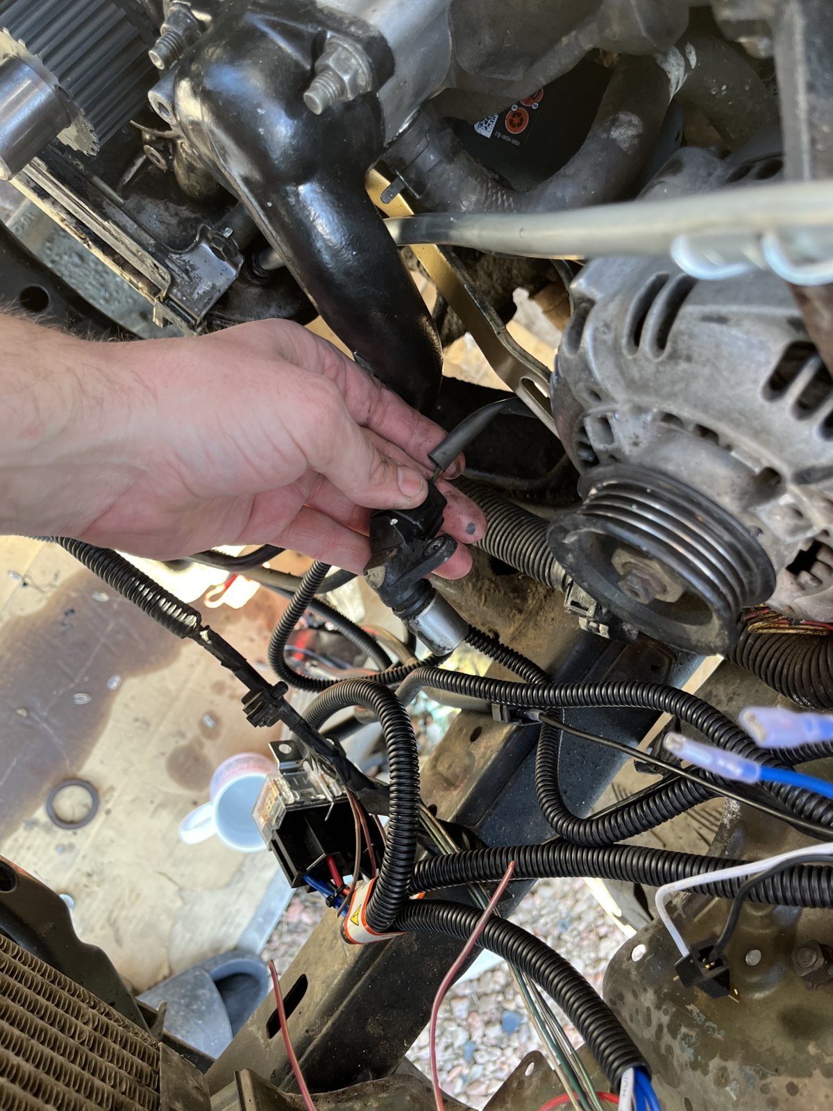

    Ahhh thank you so much!!! Massive stress reliever there. Again thank you. While I got you any chance you know where this piece screw in. Long shot I know but I’m gonna try. It was hanging right below the alternator

    That's your crank sensor, goes in a hole behind that water inlet down low at about 1:30 above the crank
