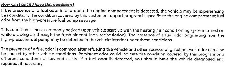

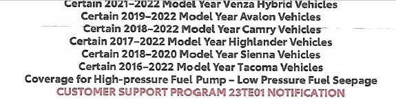

    Just recived a letter from Toyota support program, Notification # 23TE01 Fuel seepage from high pressure fuel pump, Noticable smell of fuel in or around engine compartment, List of cars.jpg Symptoms.jpg

  17. Dec 24, 2023 at 9:34 AM
    #17
    zenny
    zenny Well-Known Member
    Oct 22, 2016
    #200403
    64
    2017 tacoma access cab TRD Off Road
    Hi all I just received the 23TE01 notice from Toyota. I would like to know if the fuel odor mentioned is definitely/very noticeable in and around the engine compartment as well as inside the vehicle as mentioned in the notice. Or is the odor very faint or possibly not noticeable. I am concerned that I may have the problem mentioned in the notice but is not noticeable. The notice does not say how noticeable the fuel oder is. So for those that have said that you definitely smelled the fuel odor and took your tacoma in for repair, was it a definite..."Yeh I got a problem since I definitely smell a fuel odor." Thanks for your clarifications.
  18. Jan 2, 2024 at 5:46 PM
    #18
    TA2016
    TA2016 Well-Known Member
    Aug 17, 2015
    #162050
    4,098
    Oregon
    2016 TRD Sport AT V6 4x4 ACLB P&T Package Red
    Was your odor very noticeable or just a slight odor?
    Also, when is the odor noticeable (idling with the hood up, smell it in the cab while driving etc.)?

  19. Jan 3, 2024 at 6:40 PM
    #19
    zenny
    Oct 22, 2016
    #200403
    64
    Hi TA2016. Appreciate your reply. I do not really smell a fuel odor. That is why I was asking if the fuel smell is very and definitely noticiable in the engine compartment, especially when opening the engine compartment, and then also in the interior. This is why I am asking for replies from this great forum before and if I should take it in. The 23TE01 notice from Toyota does not really say that the fuel odor is definitely noticiable. Thanks again.
