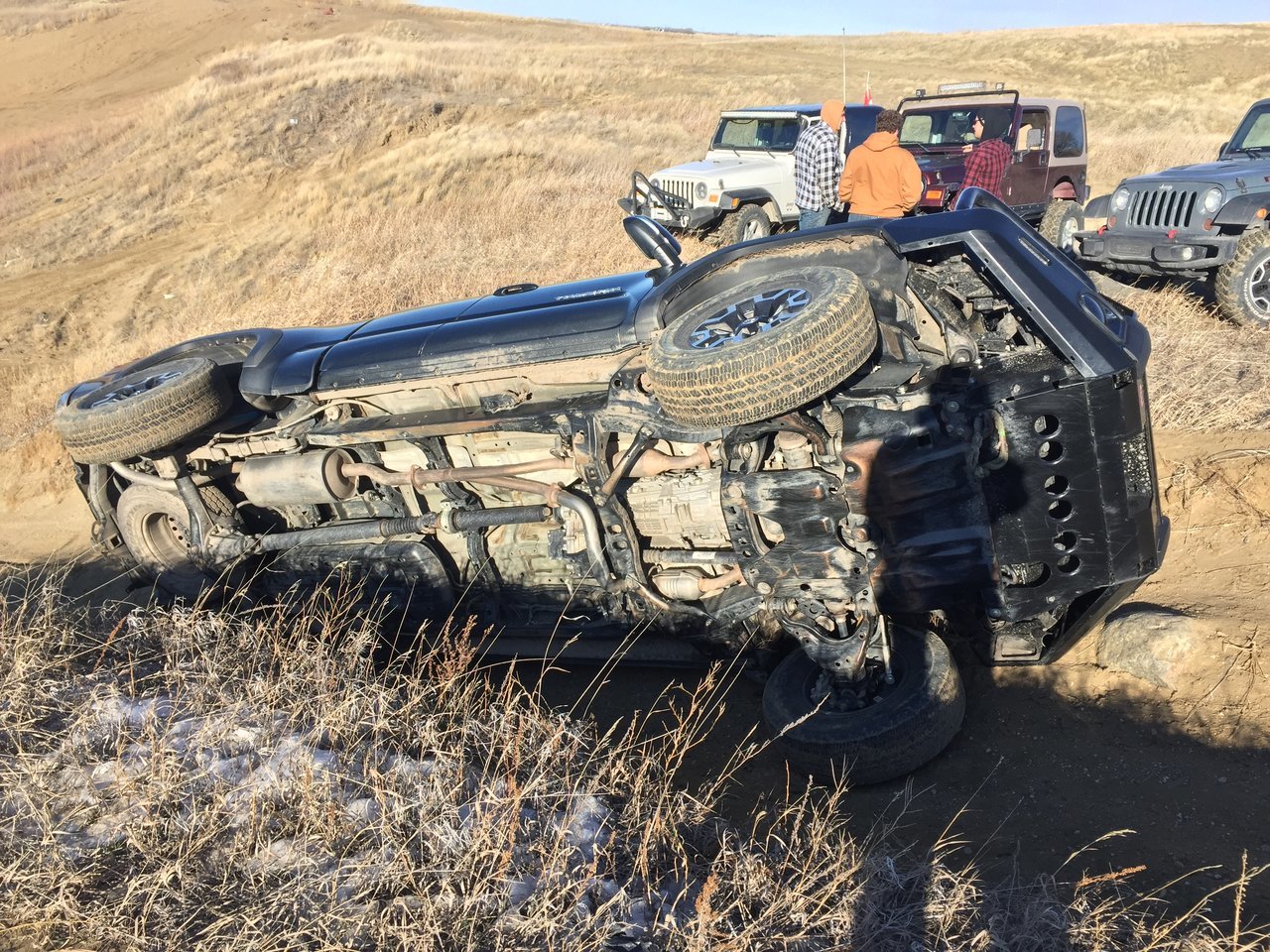

    What are the steps required to starting the motor after recovering the truck and getting it to flat ground?
    Thanks in advance.

    Pull the plugs and turn the motor over to make sure there is no oil in the cylinders

    I would say it "shouldnt" do this but better safe than hydrolocking it with oil and bending a rod.

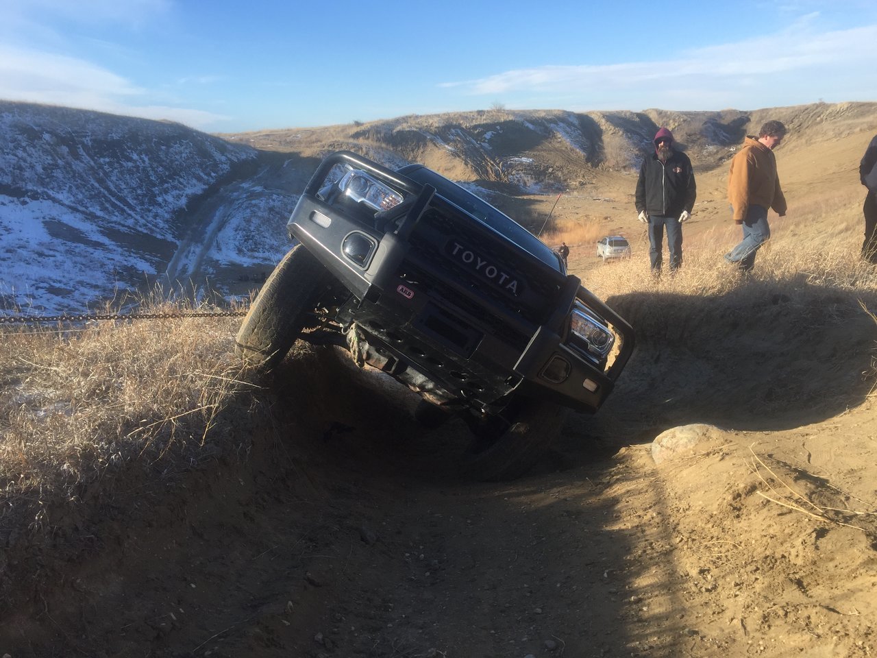

    Damn, ok well about 10 people were telling me to just let sit for a few minutes after recovering, check the oil level, try starting it...
    Starter engaged but didn't turn the engine over.
    Feeling stupid, Atrac bucked me over as I tried walking inch by inch up this ledge.

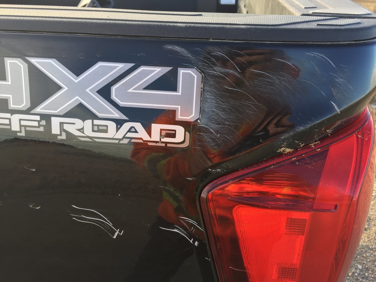

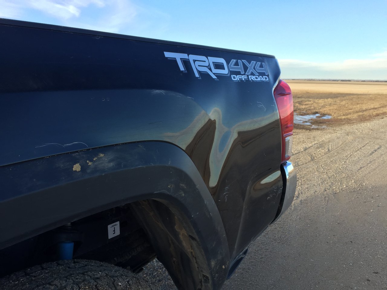

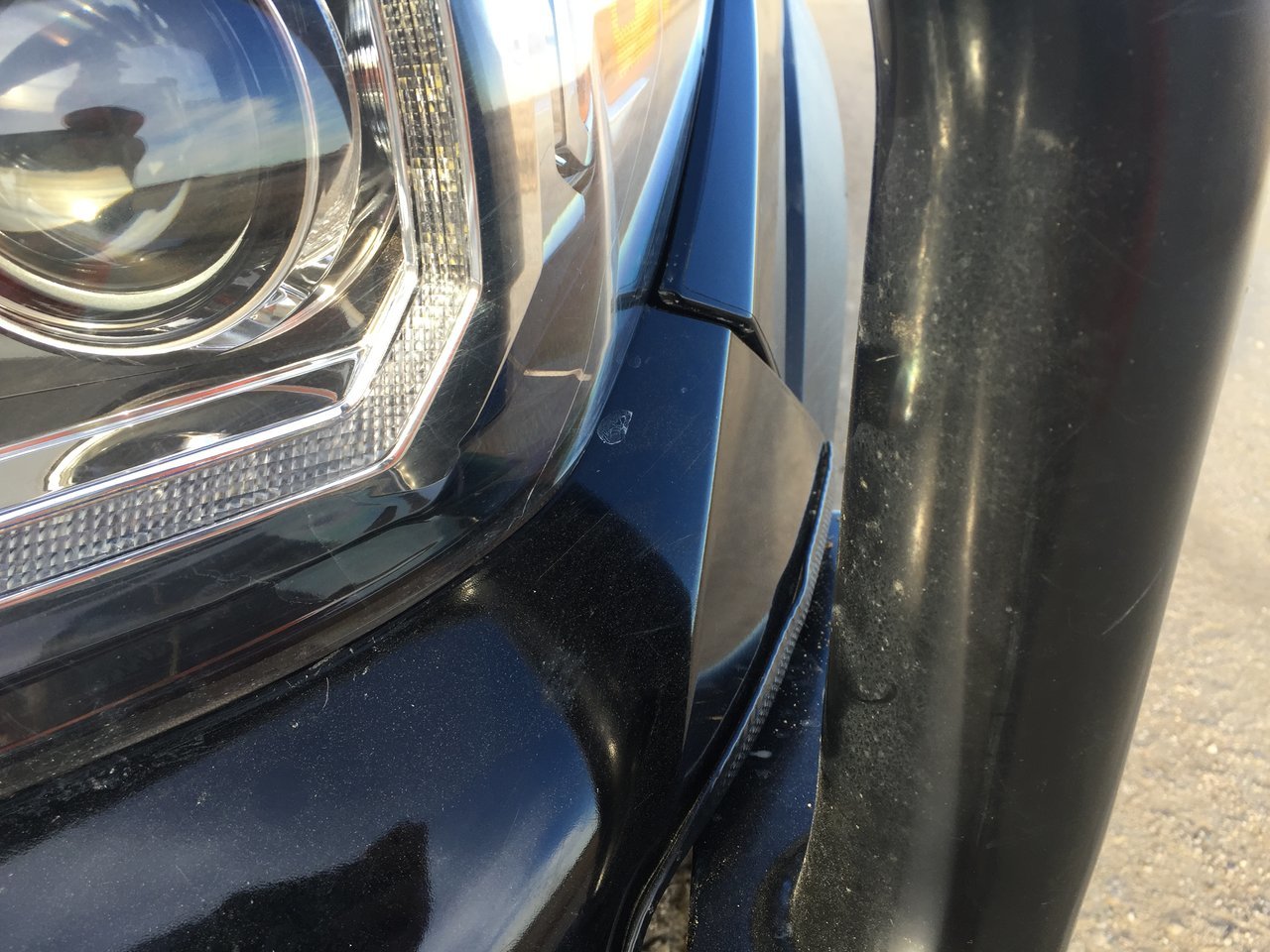

    Any damage?
    We are gonna need those pics too
  19. Dec 2, 2017 at 8:16 PM
    #19
    TurdGenBrah
    TurdGenBrah [OP] Well-Known Member
    Jun 8, 2017
    #221028
    72
    2016 Black TRD Off-Road ACLB Tacoma
    CB radio, ARB bumper, OME 886 coils w/ Nitrocharger shocks, TRD Pro grill
    This is the worst of it. I got real lucky. The ARB bumper kept the fender and doors off the ground by 1 or 2 inches
