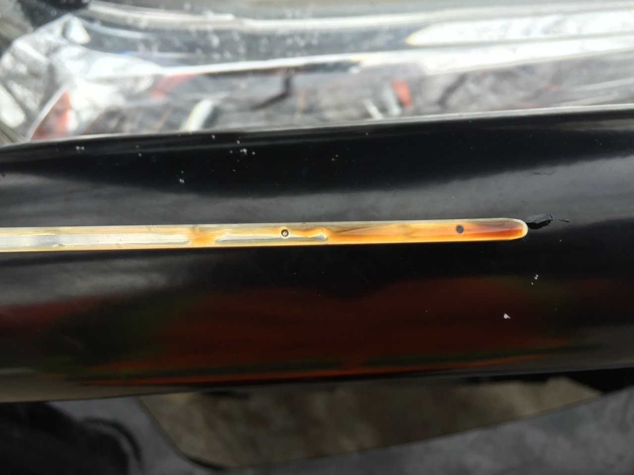

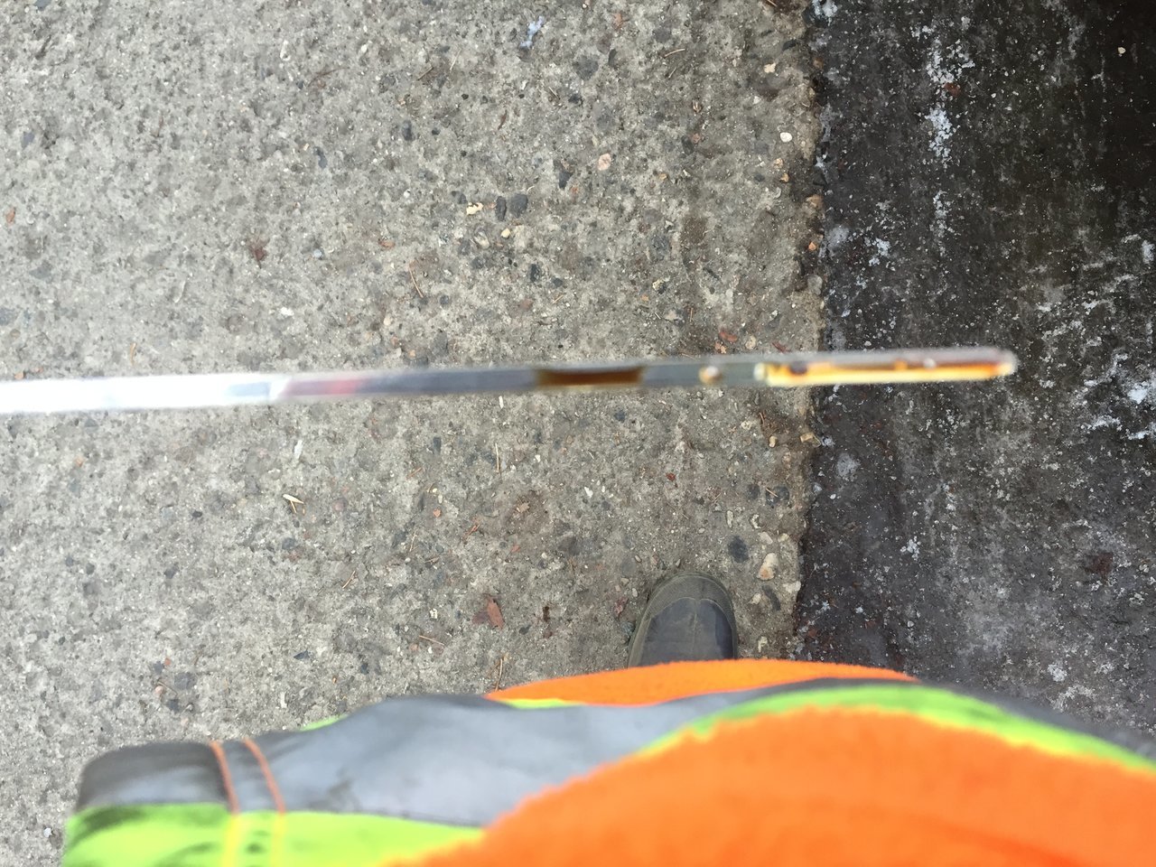

    Check the dip stick. If the oil is now in cylinders, then your oil level will be low. I thick you will find it normal.

    I took two samples, truck has been on level ground for 24 hours now.

    Unless you knew the level before the rollover you could have less oil now.

    ahhh you should be fine. Start turning that bitch over! The engine, not the truck :D
