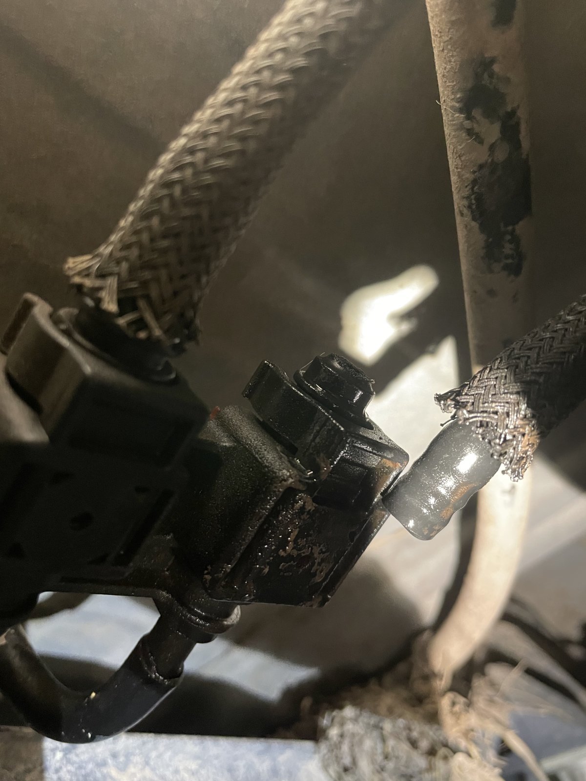

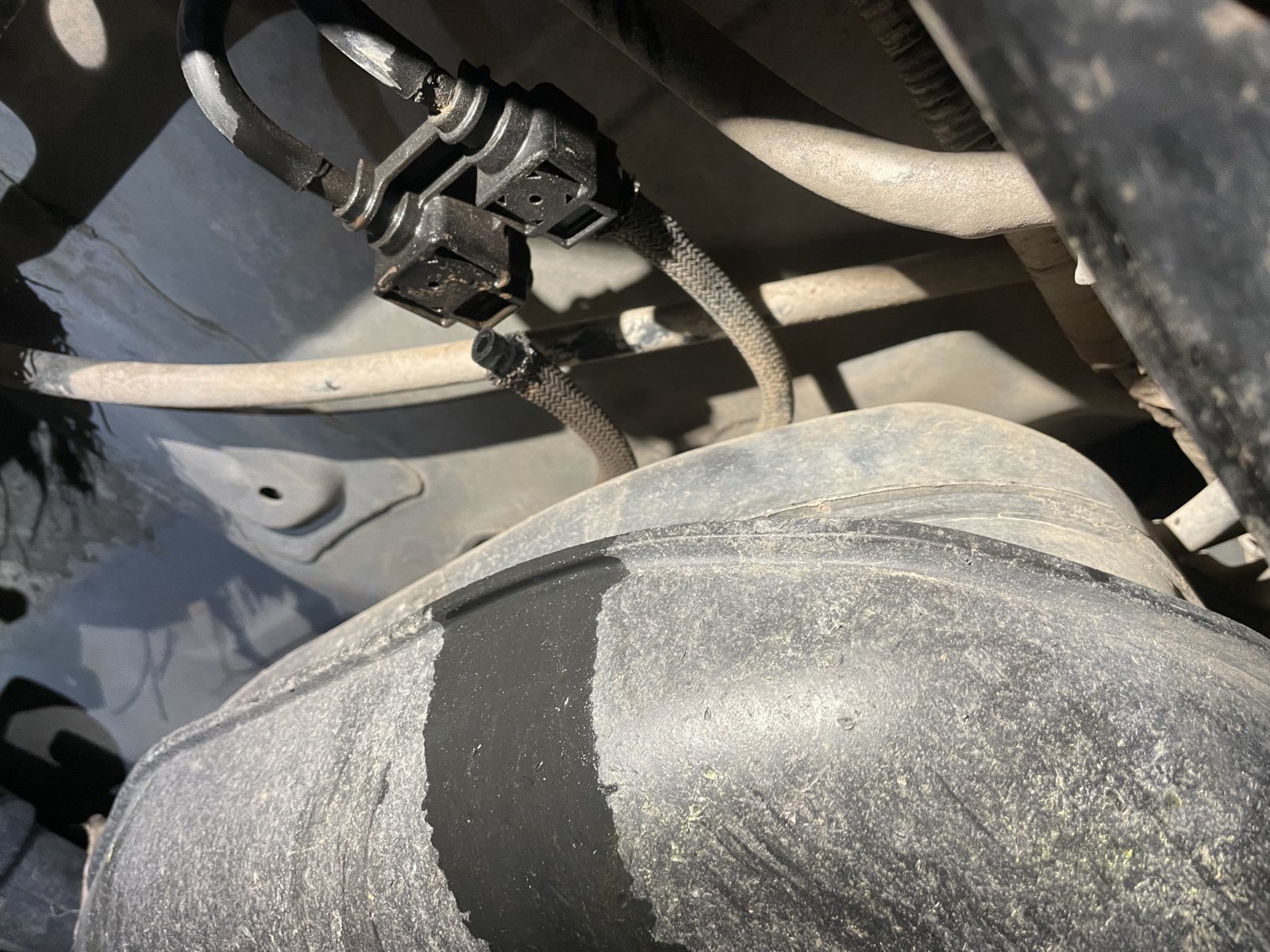

    Anyone know what this part is called exactly? It’s on the under side of the truck and it’s related to the fuel system as the line broke and gas is leaking from it.
    Looks like this line attaches to the box component through a nipple fitting the was snapped when something under breath hit it. Any help would be great can’t locate the details of the part
