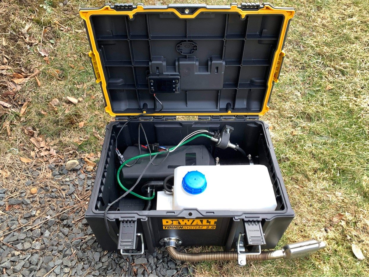

    Love my little heater toolbox thing I built. It is a PIA though to hook up and purge the diesel lines every single time though (especially when its single digits out..)
    That being said I feel better about diesel than gas. If you were to looking for a full time setup, I would think it would be easy enough to mount a few-gallon tank somewhere. Maybe run a breather line up front to avoid smell if thats a concern. Filling might be interesting though, depending on where it was mounted.

    I built a diesel heater in a dewalt tool box. Works awesome!

    Basically exactly what I did, except I kept the tank separate. Didnt want it to leak (which I know it will) and then stink up the hot air into the tent. How has it held up for you so far, as far as that goes?

    Haven’t had any issues with anything. If I did an external tank I’d probably just use a rotopax mounted to my bed rail and I’d just feed the fuel line into it at night.
