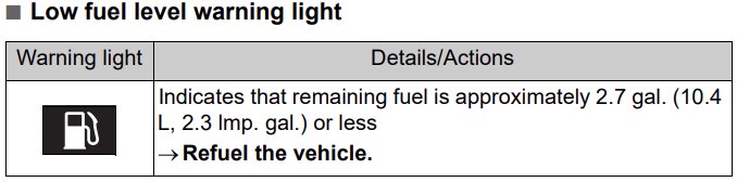

    Why can't folks read their manual?
    Page 76
    Running out of fuel
    When the vehicle has run out of fuel and cannot be started, refuel the vehicle with at least enough gasoline to make the low fuel level warning light (P.546) go off. (The standard amount of fuel is about 3.4 gal. (13.0 L, 2.8 Imp. gal.) when the vehicle is on a level surface. This value may vary when the vehicle is
    on a slope. Add extra fuel when the vehicle is inclined)
    Page 546
    Low Fuel Warning Light Details/Actions
    Indicates that remaining fuel is approximately 2.7 gal. (10.4 L, 2.3 lmp. gal.) or less
    Put these together and you initial low indication happens at 3.4gal remaining and your MTE/"out"/reserve is 2.7gal.

    And I'm explaining how it reads very accurately. MTE is based on 2.7g remaining at the point of "zero miles". That's why it's the 'reserve'. At an 18.2g tank, minus 2.7g reserve, you get... Drumroll... 15.5gallons, which happens to be the most common number cited here and on T4G when filling up at "zero".
    Expand that to when the icon changes color and you're first warned, you're now at 14.8gal... another number generally cited.
    For the rest of our friends outside the USA, that's a 69L tank, with reserve/KTE set at 10.4L (58.6L consumed) and low fuel light at 13L (56L consumed)

    They literally do this in writing within the manual. People need to stop being lazy? arrogant? And read the manual for the machine they purchased. Sure it has gaps of information, but so many questions posted here are answered by the manuals.

    Well, it's kind of right there in the Owners Manual...
    Granted, they don't explain the technical details of why, but in reality practically nobody cares. They see the light, they get gas, they continue on with their life. It's just (some of) the enthusiasts who frequent sites like Tacomaworld who lean towards overanalyzing stuff that even notice they're filling up with 15.5 gal instead of 18.2gal

    Let's not change context. Referring to the owners manual was in response to "Toyota could tell you how much is in the reserve"
    Toyota does tell us how much is in the reserve.
