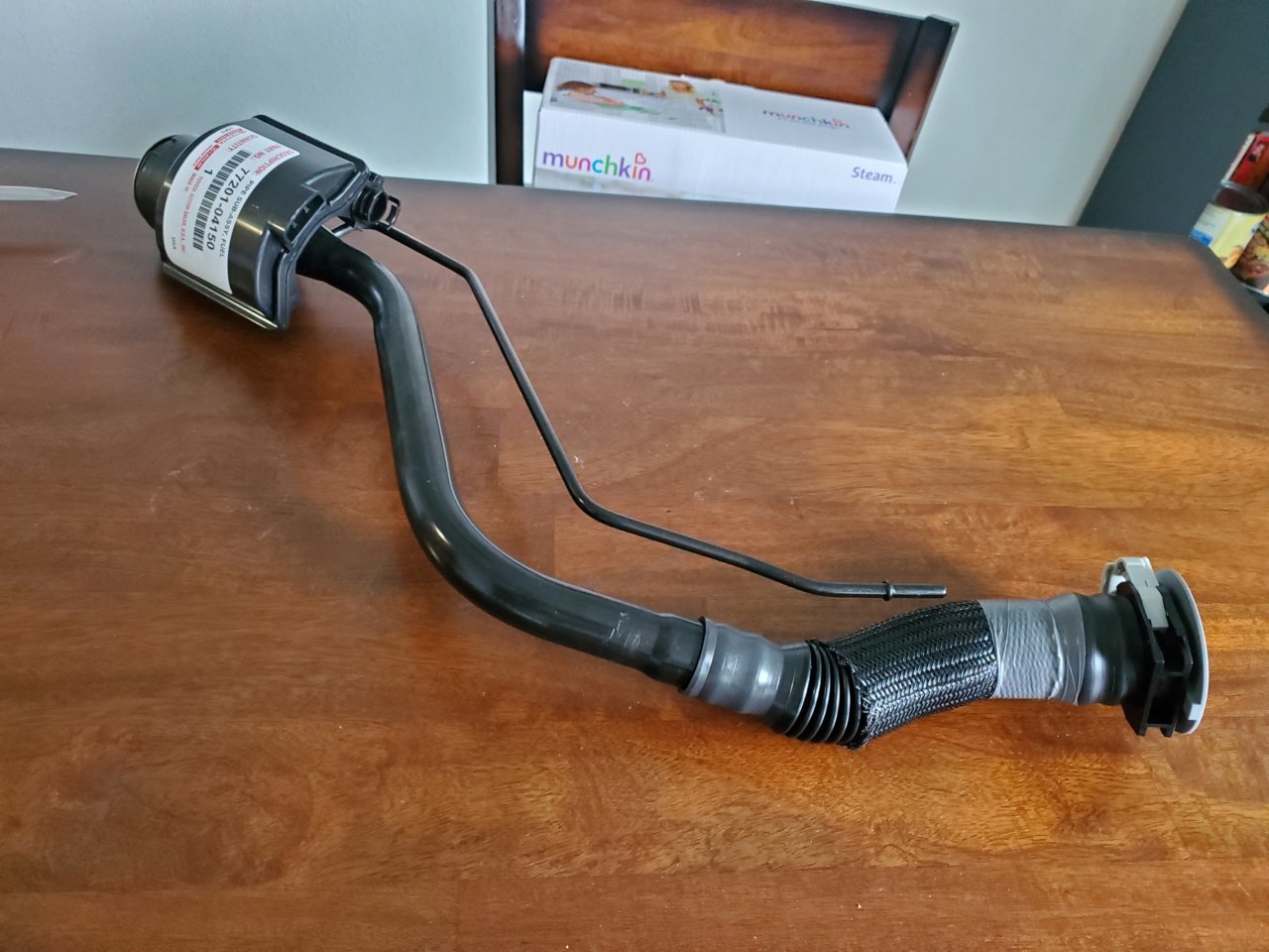

    I got in there a few days ago and attempted something similar. Even after removing the fender liner and fender support bracket, there is very little room to work with. The affected area of the hose is tightly sandwiched between the main longitudinal outboard frame member and the bed. Unless you have fingers like ET, you're not going to be able to do much.

    ^ this section with the plastic bellows is directly below the factory drain hole location on the driver's side.
    There is very little clearance between it and the bed so it is a tough spot to work and see, even if you remove the fender liner and fender support bracket. Effective temp fixes are gonna be tough without lowering the tank. If you're gonna go that far just replace the hose.
