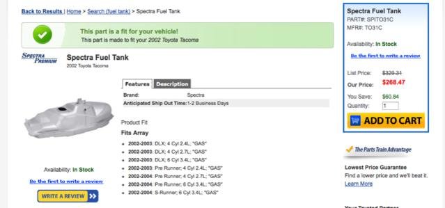

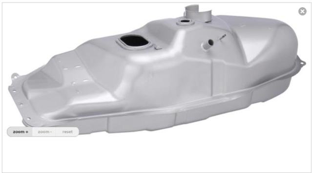

    Hi everyone,
    I'm new to the forum and trying to solve a fuel tank problem. The fuel tank and lower shield on my truck are rusted through and I can't afford new parts from OEM (~$800 for just the tank).
    I have feelers out for a used tank, but I'm wondering if this Spectra part is compatible ($270 new).
    First photo is the assembly in my truck, second and third are details on the Spectra tank.
    Thanks for your help!

    I'm going to say yes, it should work. All of the ports and holes look to be in the right places. If anything, see what their return policy is, and give it a shot.

    I put a Spectra Premium T031C (Rockauto part #) on my 2002 3.4L, it fit great.
    Don
