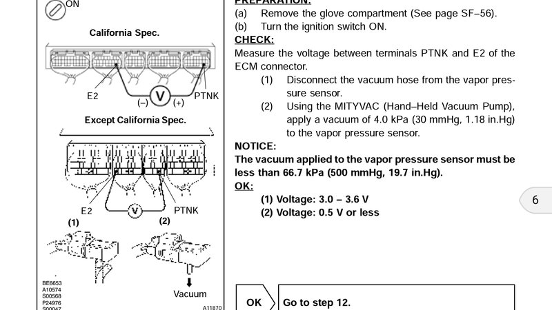

    So it seem my pressure/vacuum sensor, at the vsv, is bad. the appropriate pins at the ECU come up at 0v when the sensor is plugged in, and 5v when the sensor is disconnected. Issue with this is I can NOT find the part for sale, and I'm a parts specialist! Has anyone found this part for sale? Can anyone give me any leads?

    Looks like 89460-08020 from a Sienna is identical. Some really good info in second link, that thread is actually where I found the first link.
    http://www.yotatech.com/f166/p0441-p0446-p0450-p0451-251680/
    http://www.toyotanation.com/forum/6...ure-sensor-t100.html#/topics/678554?_k=ygxg2n
    http://www.yotatech.com/f132/vapor-pressure-sensor-270310/
    Looks to me like this sensor is interchangeable among many Toyotas. Now I'm seeing the Tundra one works as well.

    you 2 are awesome. I'm deffanitely going to do one of these suggestions.
    first thing's first. going to call intermotor's tech line tomorrow and see about getting 1 imported. if not, probably the used part as @cruiserguy says. if that's not available, i have those other model variations to fall back on. one way or another, i will get this thing going again!
