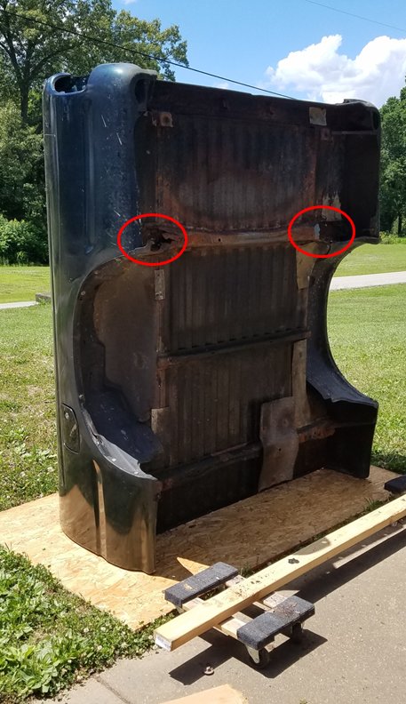

    Same as BartMaster, I have done it both ways and agree bed off is easiest,... but if you live in a rustbelt state, proceed with caution.
    The crossmembers tend to rust in the area where the nuts are welded in place for the bed bolts to attach. They will twist instead of loosening. You'll end up ripping the crossmember apart, as shown when I removed mine earlier this Summer.
