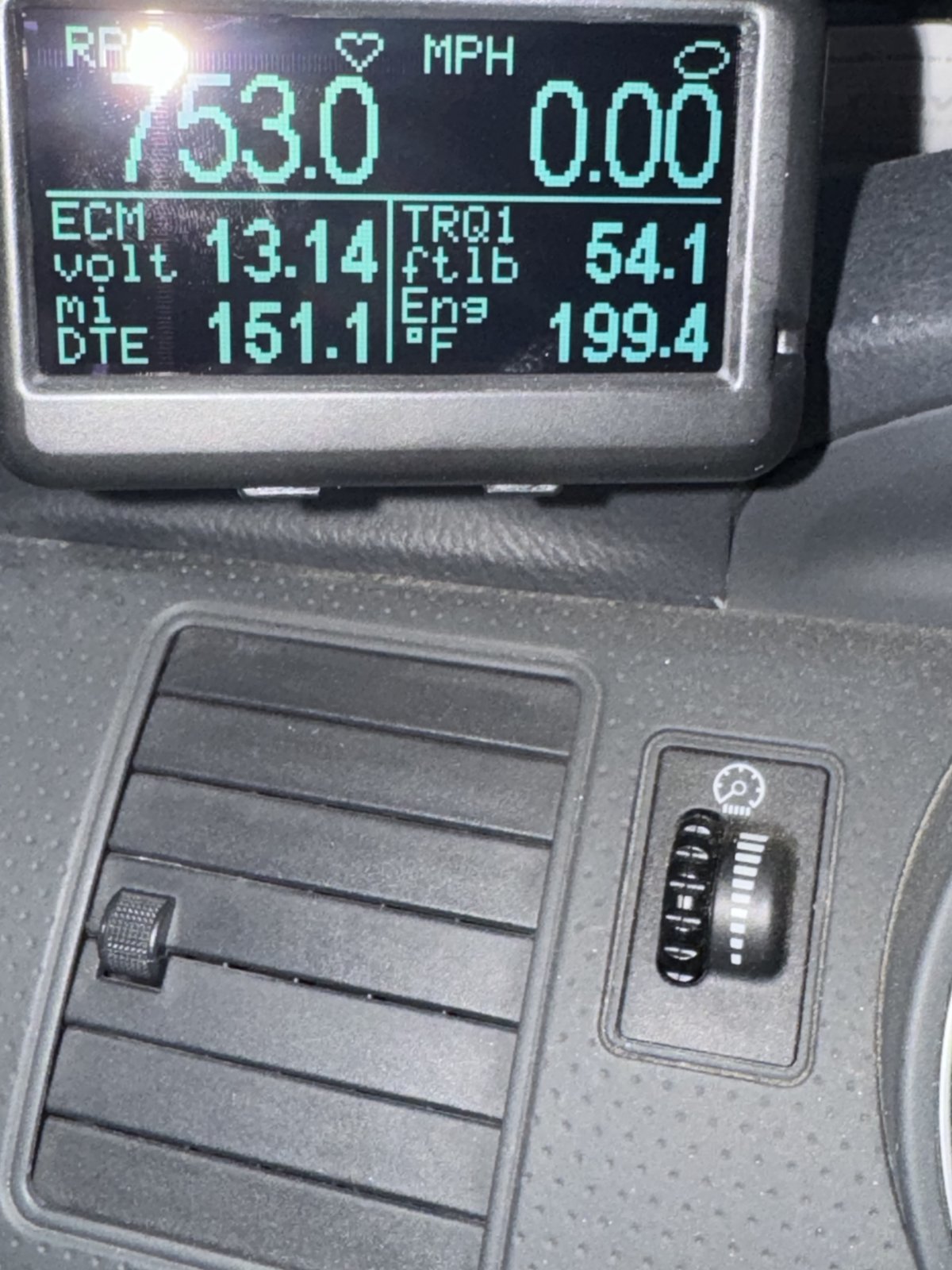

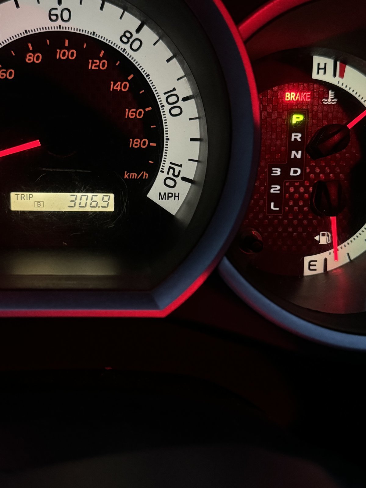

    Bumping this old thread. I entered 21.1 into the ultragauge on a fill up, but I’m almost on empty and it’s displaying dte 151mi. Trip meter is at 307 mi. That would put me at 458mi to the tank. That can’t be right? Needle is almost on empty

    The way the float is attached to the fuel pump is via an articulating wire arm that doesn't quite sit flush with the bottom of the pump. Additionally, there is quite a bit of dead-space around the pump that allows the fuel to slosh around without getting picked up by the pump. With all that said, it is unwise to run your fuel pump for too long while the tank is low on fuel because the pump is cooled and lubricated by the fuel in the tank. If you overheat the pump, it potentially could lead to premature failure of the component. Just keep that in mind when you're running your truck on E. Come to think of it, do you have to train the Ultragauge on your specific driving habit average MPG? I'm unfamiliar with the Ultragauge but the impression I got from your post is that this is the first time you put in 21.1 into the Ultragauge so maybe it has to do a few cycles before it can calculate your fuel mileage based on your driving habits. You may also have some leeches that are sapping your mpg such as underpressurized tires, roof racks, lifts, larger tires, additional weight, ect. Fuel mpg on your 2017 is 17 mpg in the city and 21 mpg on the highway. If we cut the middle and calculate based on 19 mpg it gives us a comfortable 400.9 miles to the tank. Your range based on fuel tank size would be 358.7 to 443.1. Looking at your current Odo based on where your needle is, you will fall within that range so in my calculated opinion, everything seems to be operating as normal.

    Thanks for that info. Yes this is the first cycle with the UG, I normally don’t run it down that low but wanted to see how accurate it was using the trip meter. I’m using in on my ‘13 regular cab base model which has a lowered suspension. So I guess with the needle that low you still have quite a bit of range. Thanks again

    You'll want to calibrate your Ultragauge gas mileage, if you haven't already.
    Has the gas light come on yet? 307 miles to a tank doesn't sound like good 5-lug mileage, so your UG mpg calculation might be a little optimistic right now.

    What was your trip mileage and DTE when you filled up?

    I might stop using the mpg also lol. I’ll check out the settings, when the low fuel light came on the odo trip meter was like 310, the dte was still over a hundred

    Yeah, so that's way off. The gauge thought you only used 67% of the tank so far (assuming total range was still 458), when really you had used 83%.
