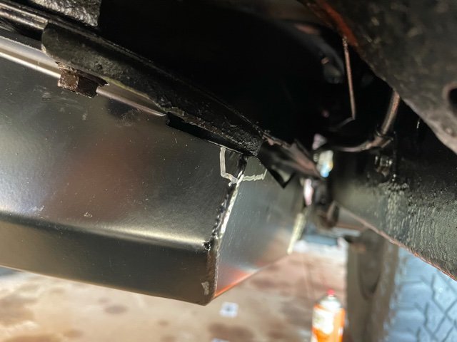

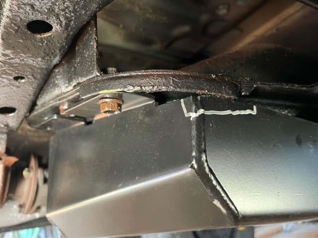

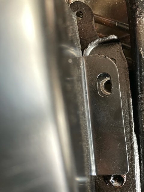

    I ended up getting one as well. I had to notch both front corners and elongate one of the front bolt holes so i could get the bolt in. I worked a deal with the vendor to where I would keep the skid and work it to fit a they refunded me 70% of the price. The welds look nice but they don’t have full penetration. They should plenty strong enough for light to medium of roading though.

    2002 Tacoma PreRunner 2WD
