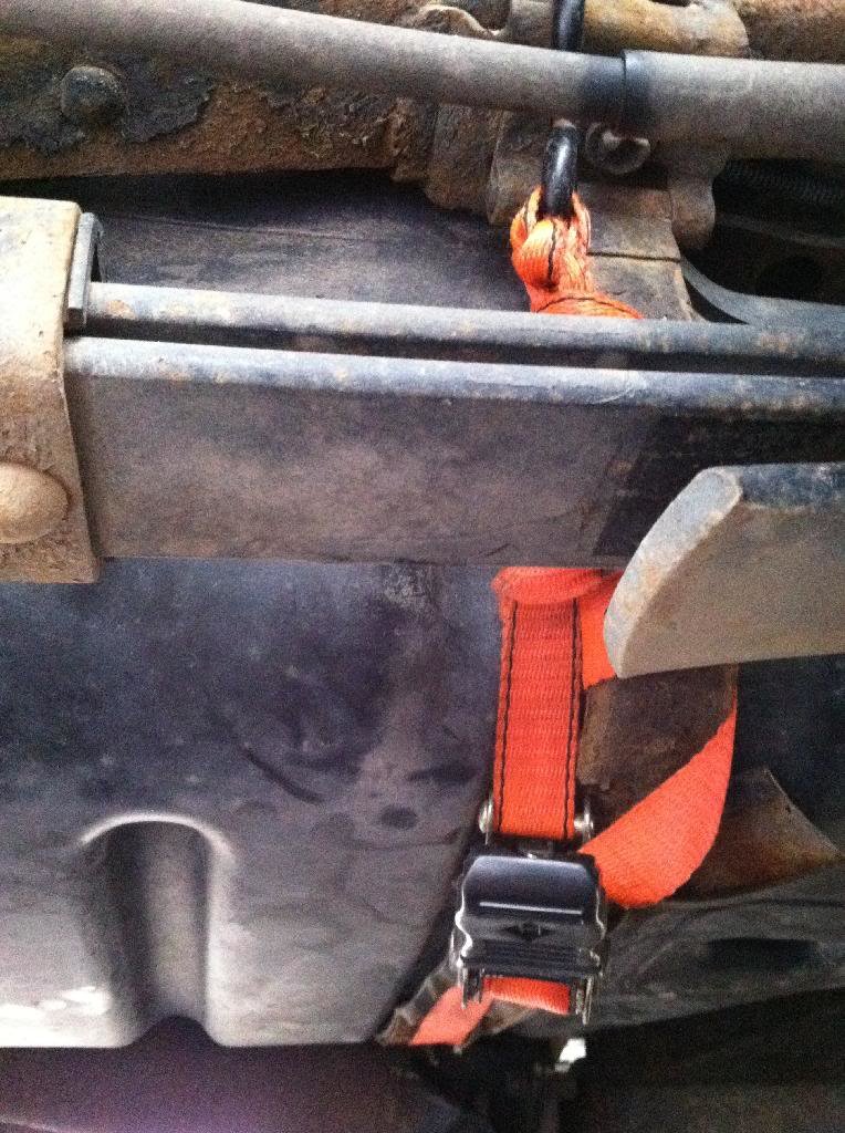

    i ordered new straps from toyota, they'll be here wednesday. i can use my fiance's car until she gets back from her work trip, but after that i'll have to drive my truck to work until Friday afternoon when i hopefully get a chance to put the new straps on.
    Here is my temporary setup until then:
    BBADBC3C-3510-41D0-BA9F-D1F95F538155_zps_5bf9349a88c1209818b8eb21cbaeb76dbc0b4f4a.jpg
    997E3635-5291-43BF-838A-D97044696E27_zps_6ca49e933bcb8c2a04233a5b0615469fb239aeae.jpg
