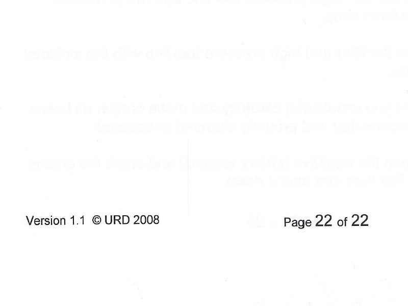

    Can only see the bottom of page 22. Would you be willing to email me directly if I gave you my Gmail address?
