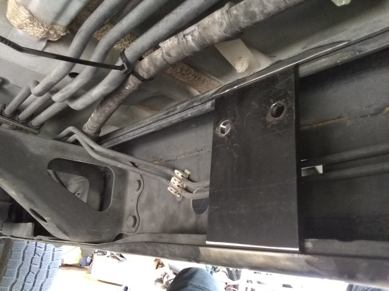

    Newest addition to Lucario Runner's fuel system.
    IMG_20190302_150838199.jpg IMG_20190302_200639050.jpg IMG_20190302_201011827.jpg

    Looks great! Hard to tell but is that protected by the frame rail?

    It sure is. As well as that 3/8" plate added a teeny reinforcement to the frame.

    Its outta the way and would most likely clear skids if one had one. I dont cause this is my daily.

    Pretty much in @Lucario Runner 's PreRunner build thread. He laid out what all parts he used.
    In my build thread, I bolted mine to the frame, as I didn't have a welder at the time. Where with his, I welded a plate to the frame.
