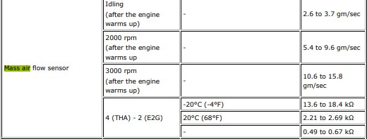

    check MAF performance based on this (without light, air, ac, etc)

    It’s reporting 0.302 lb/min which is converted to 2.3 g/s at 606rpm. Seems like it’s underreporting then. 9.2g/s at 2000rpm which is fine. And 15.12g/s at 3000rpm.

    It was the MAF sensor. Replaced a while back. Posting for the update.
