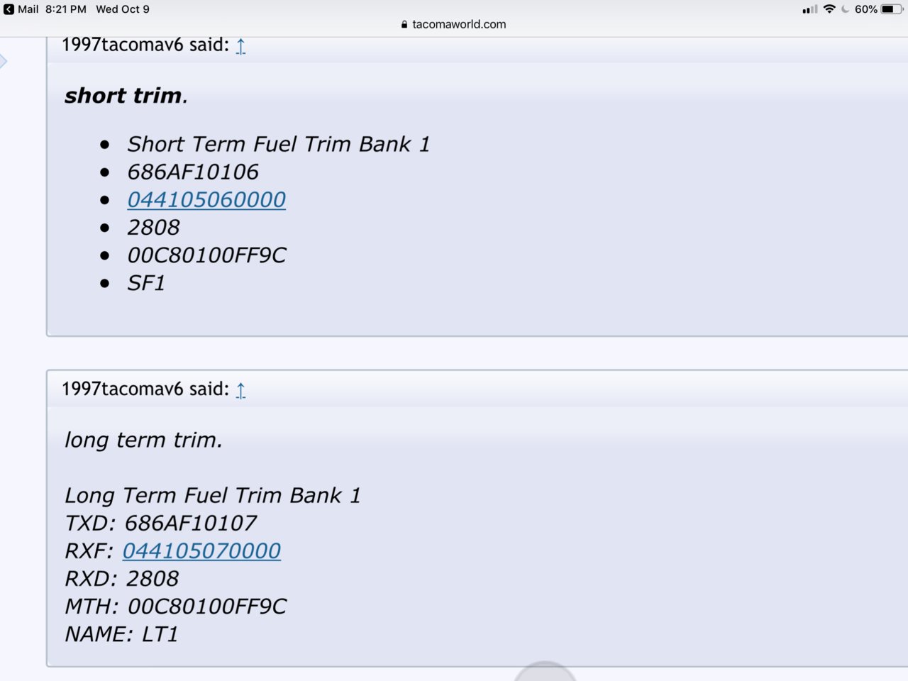

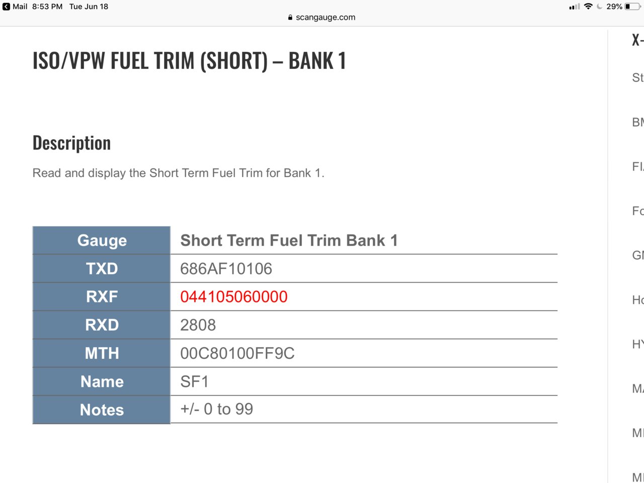

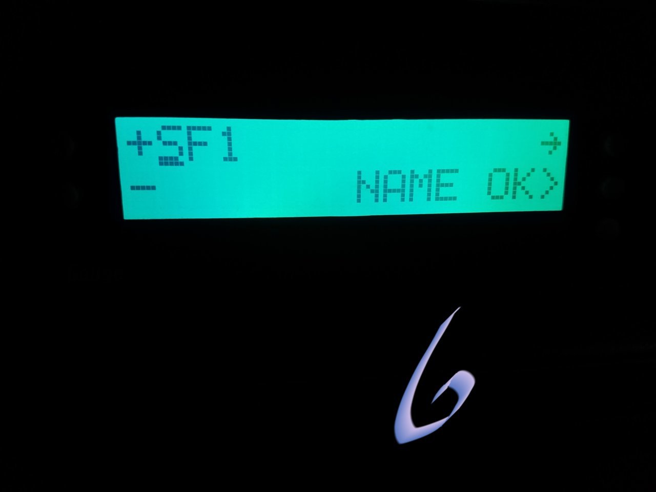

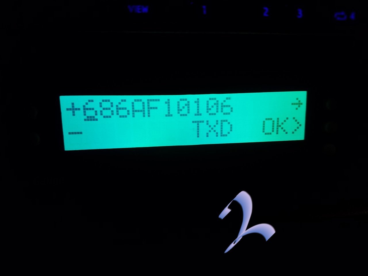

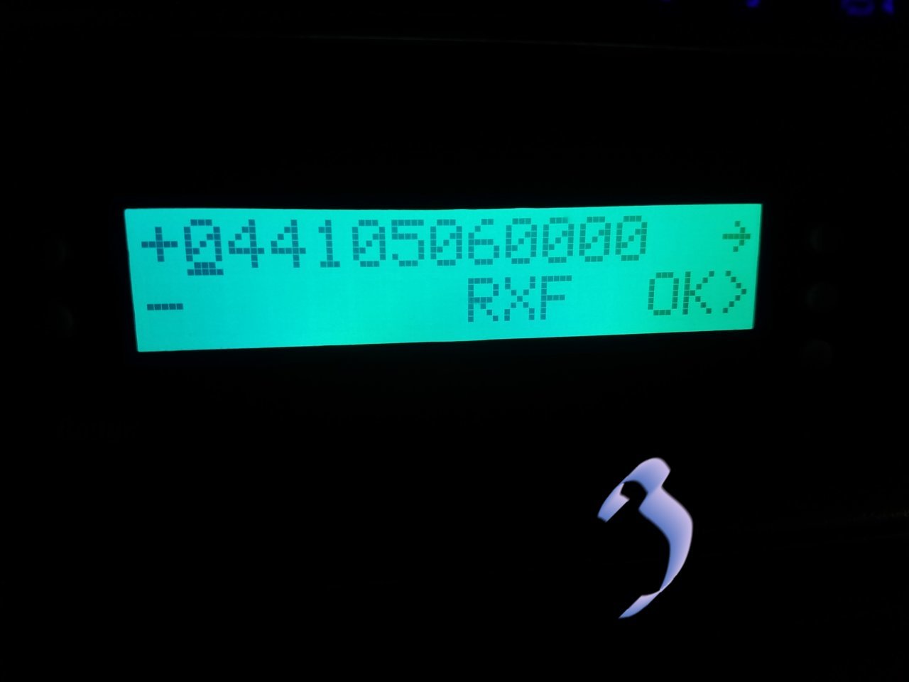

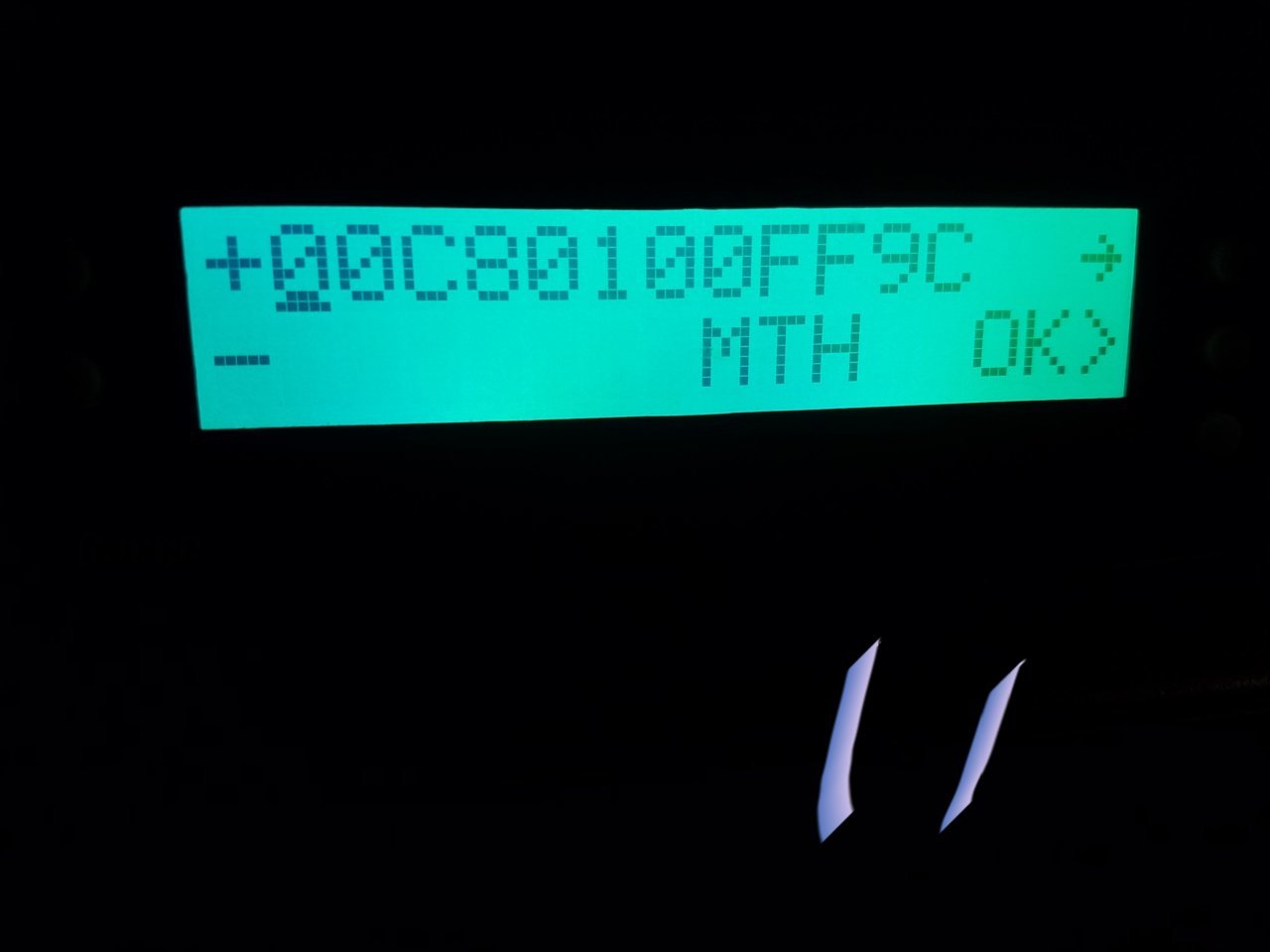

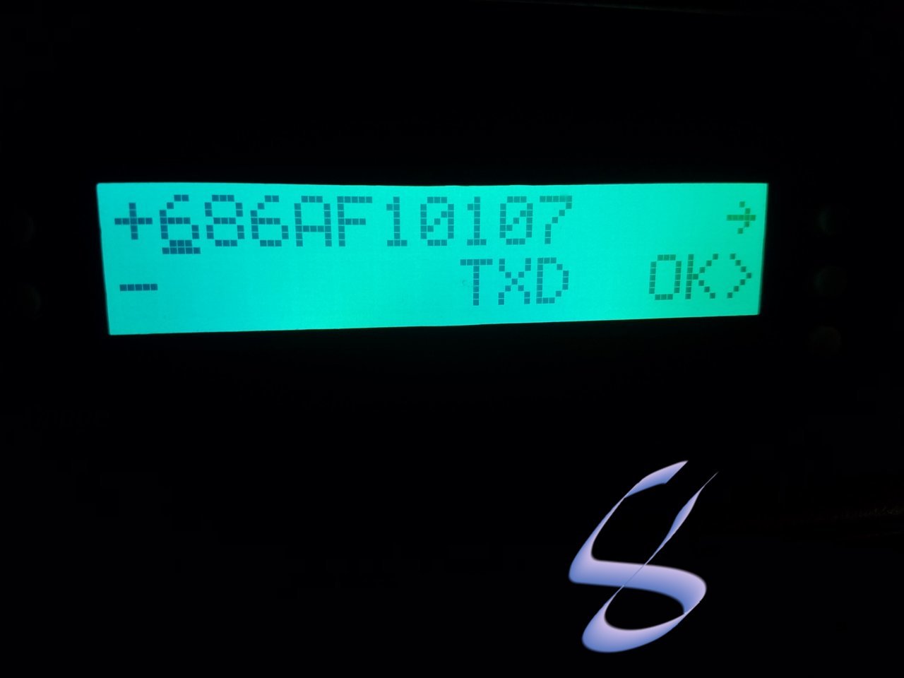

    The scanguage short trim fuel codes DO work for my 1997 v6.
    The codes are below
    • Short Term Fuel Trim Bank 1
    • TXD. 686AF10106
    • RXF. 044105060000
    • RXD. 2808
    • MTH. 00C80100FF9C
    • NAME. SF1

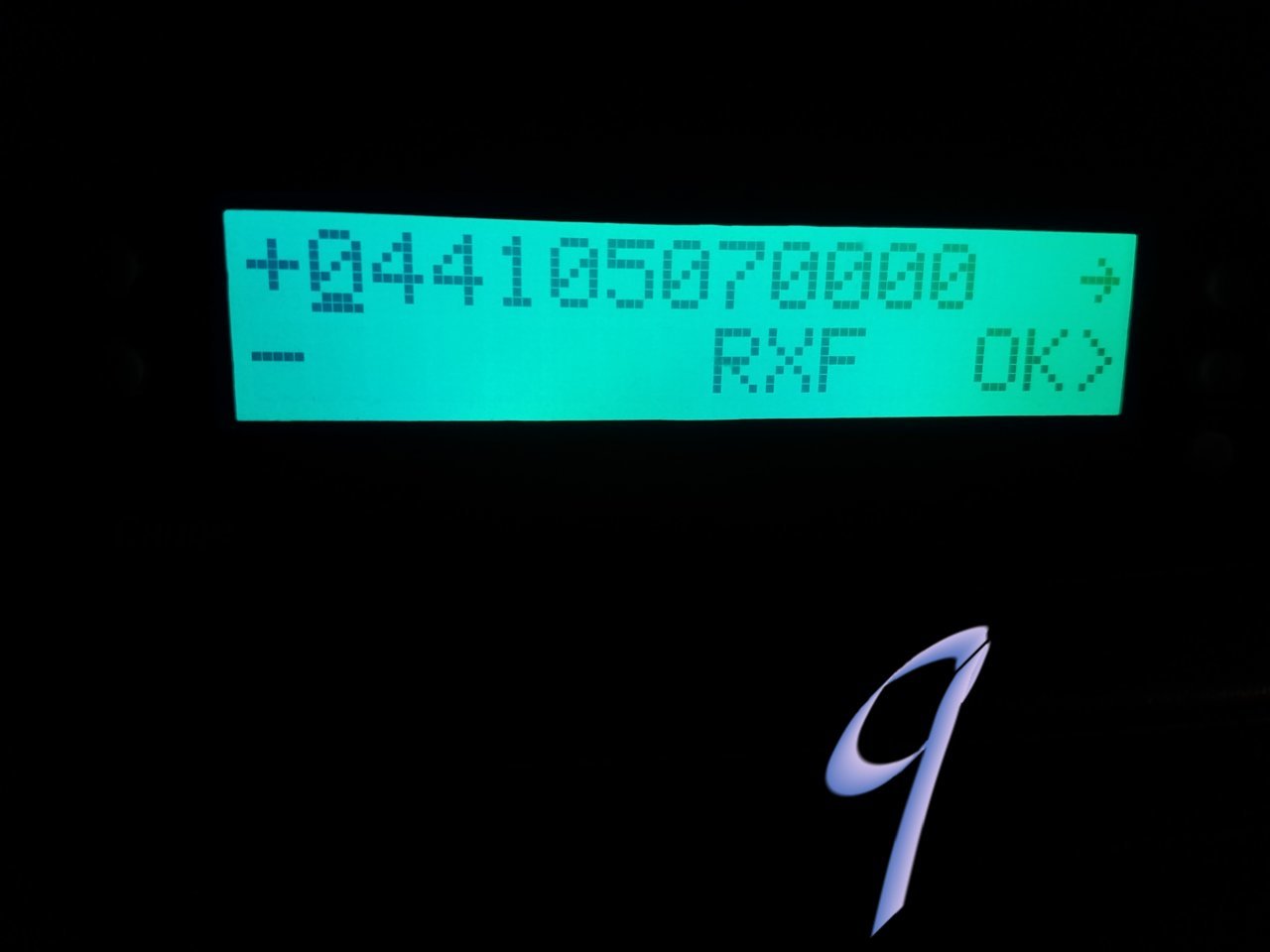

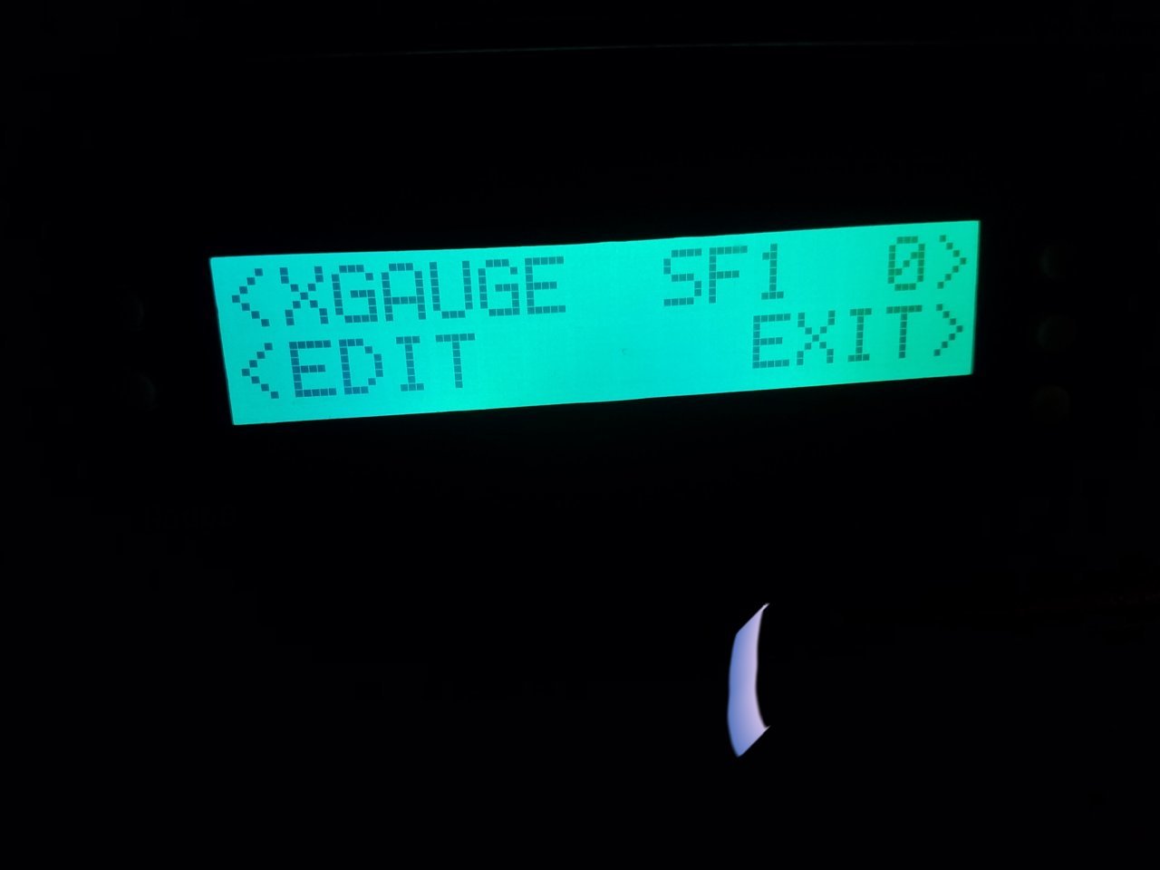

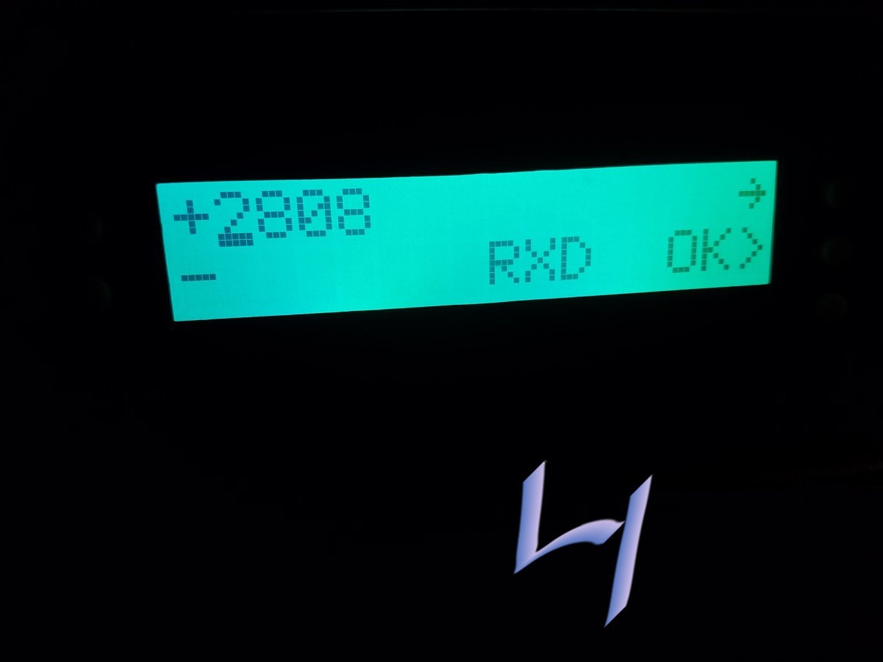

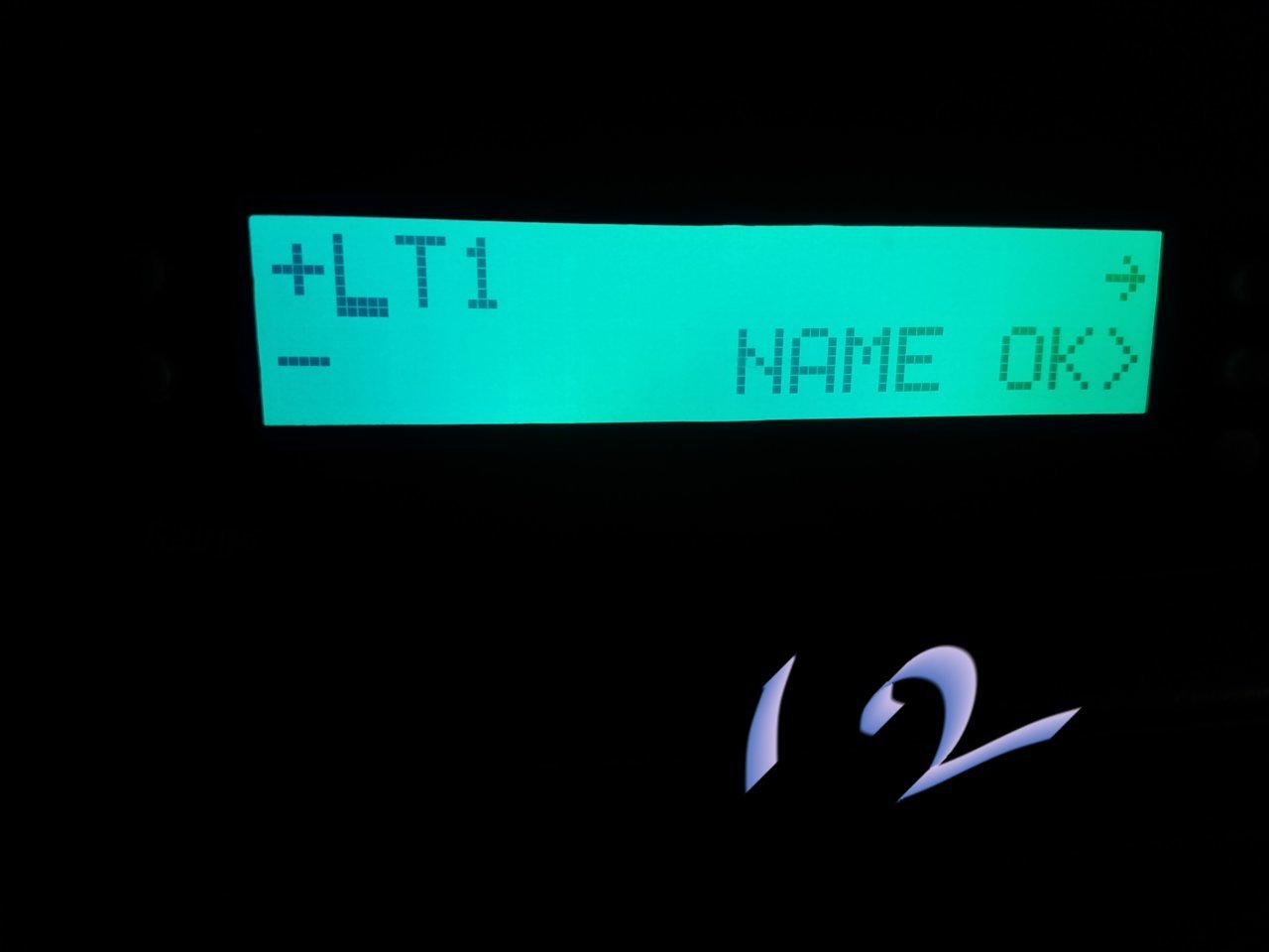

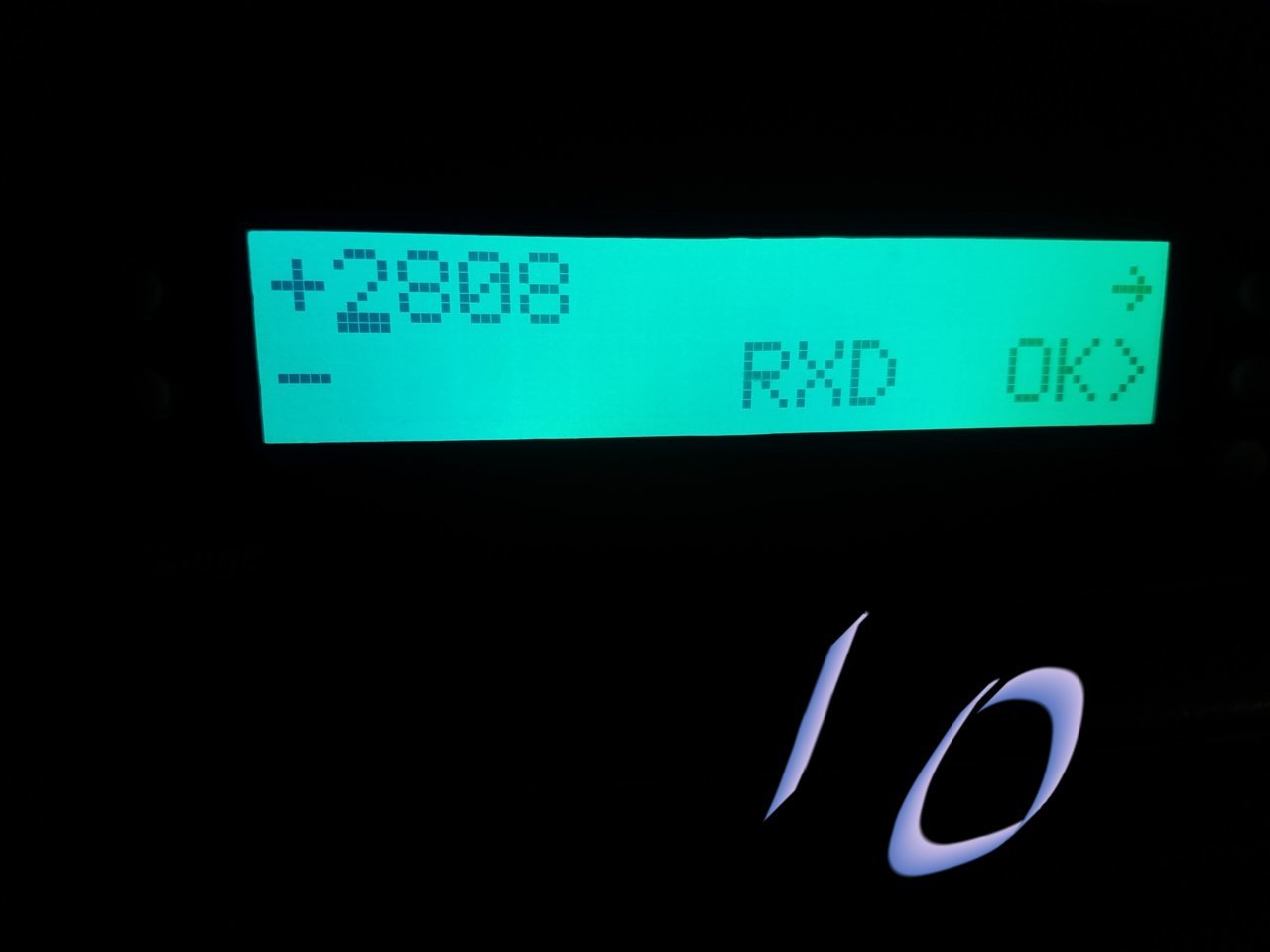

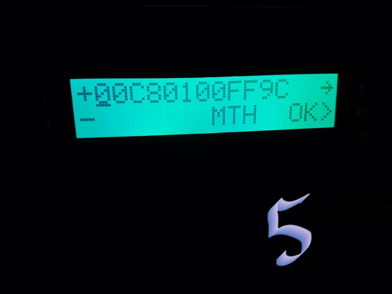

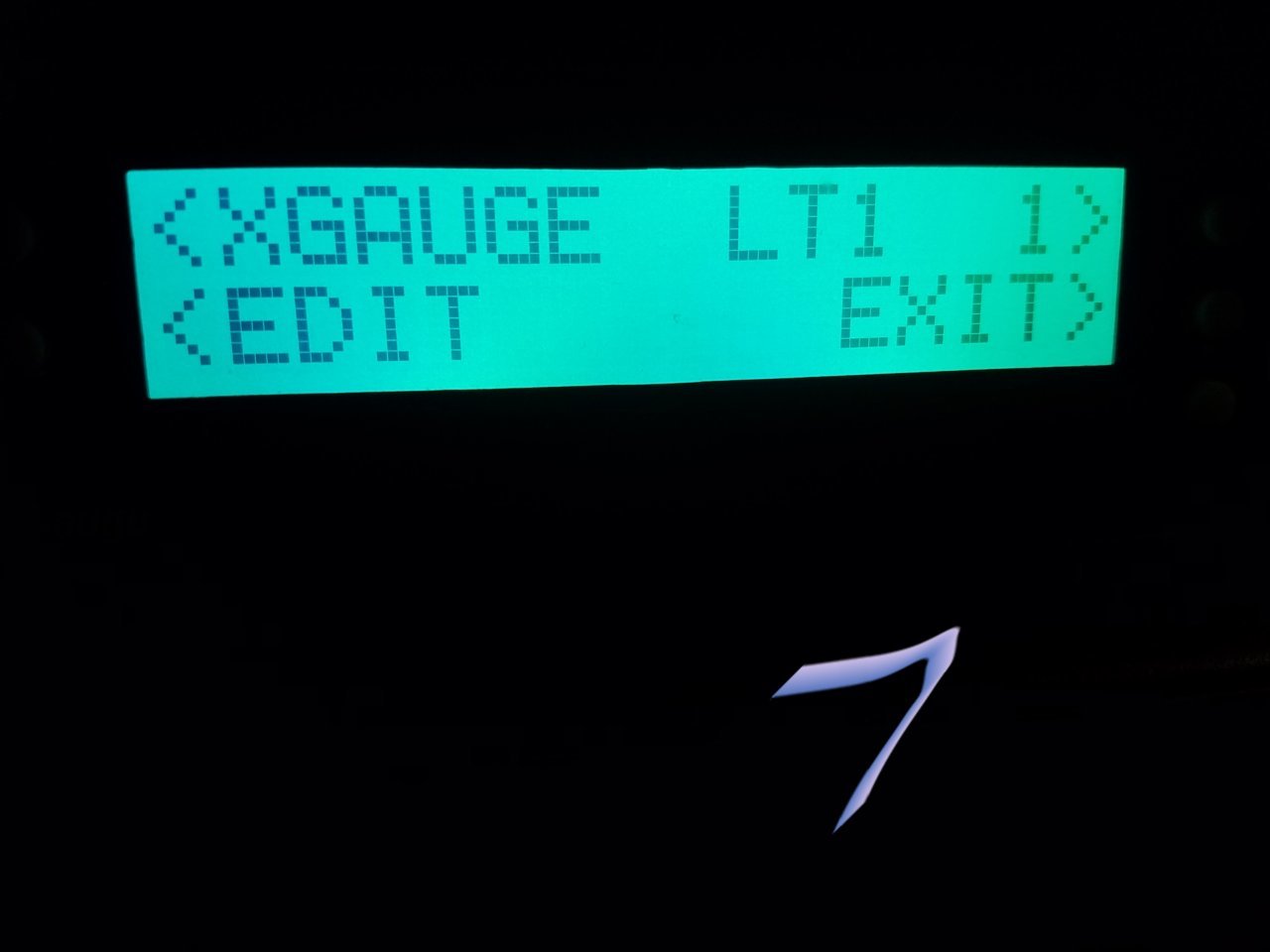

    These are the Xcodes code numbers that worked for me 1997 tacoma v6 for short and long trim info.
