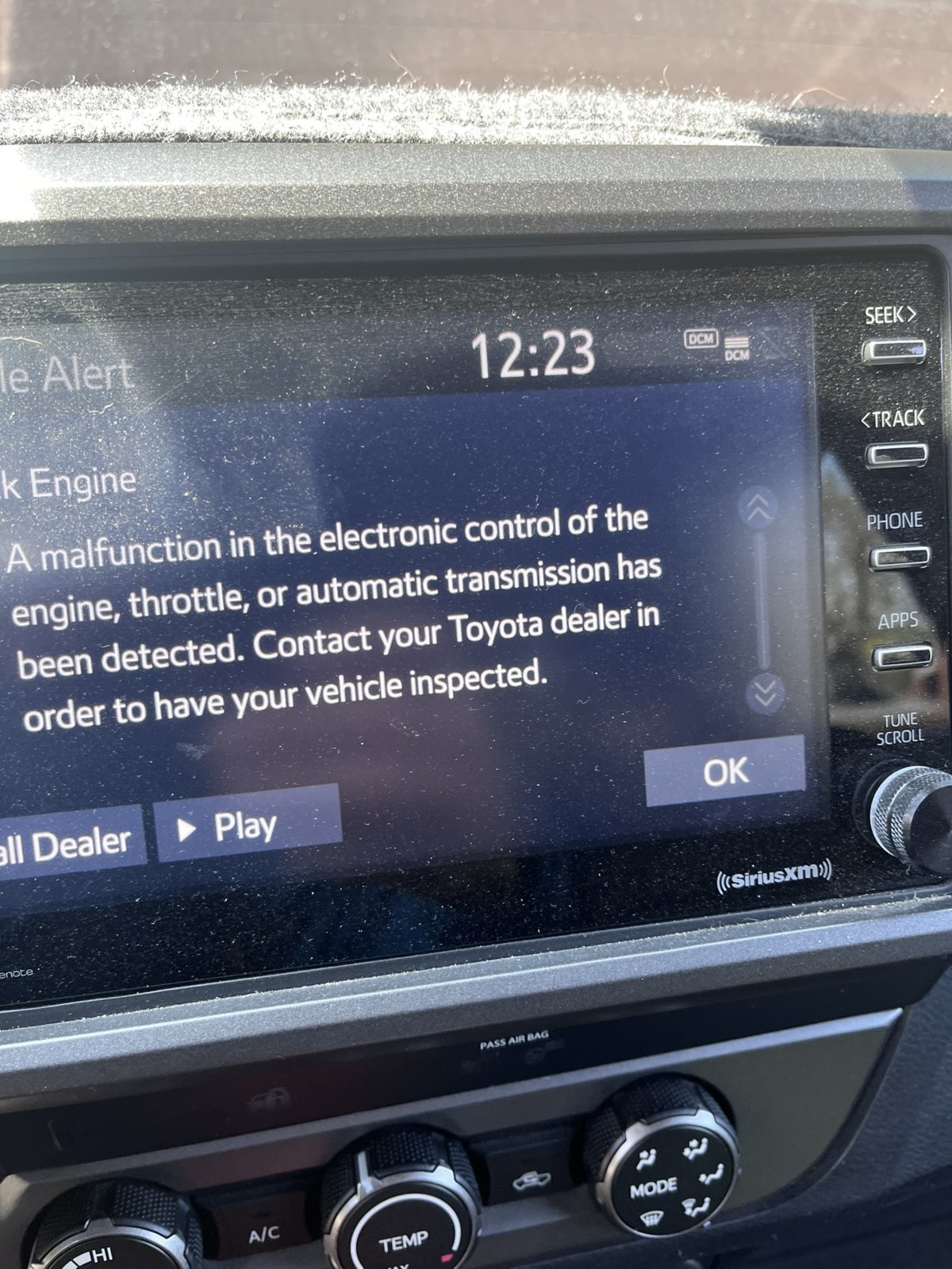

    So, I’ve been getting a check engine light lately and the codes are all about the emissions stuff. I think I’ve narrowed down to a line coming off the fuel vapor canistor that may have damaged while trying to make the drain holes bigger in the bed to fit some drain lines for my tonneau cover. But the question I have is I also started getting this message about the ECU sporadically. Truck is running fine( for now). Would a leak in the fuel vapor lines cause this message?603582B9-9AE3-498C-B046-2CCD55CF0875.jpg

    When you fill up when it clicks of when full do you keep trying to add more fuel by keep clicking the handle?
    That will cause canister issues.

    But would any of those lines cause the message about ECU? As I said I am pretty sure I got one of those lines.

    YES - because a hole creates a source for a vacuum leak (sucking in of excess air).
    You really don't have a choice except to drop the fuel tank. Drive it down to as near as empty as possible - it makes maneuvering the tank a whole lot easier.

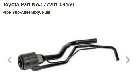

    I would also be sure to advise in advance you will probably need a fuel filler tube assembly. No, you cannot duct tape the hole you drilled. And since it is plastic it cannot be welded.
    This is what I call a "dumb" part - meaning it isn't electrical or critical to the drivetrain. Once they confirm your issue, ask the shop if they will source it from a Toyota Parts warehouse type seller online rather than the dealer. You will save $$$. I would waive any nonsense they tell you like "well, we can't guarantee the work for or standard ## months unless we use a genuine Toyota part". So be it.

    Well, finally got it fixed. Fuel filler tube was needed. $328 later and it’s done. I had a shop I know do the work. He showed me where I got the line.
