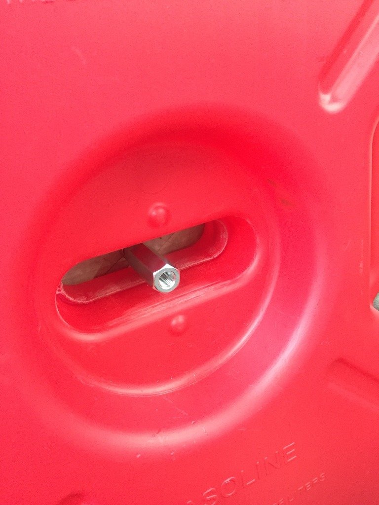

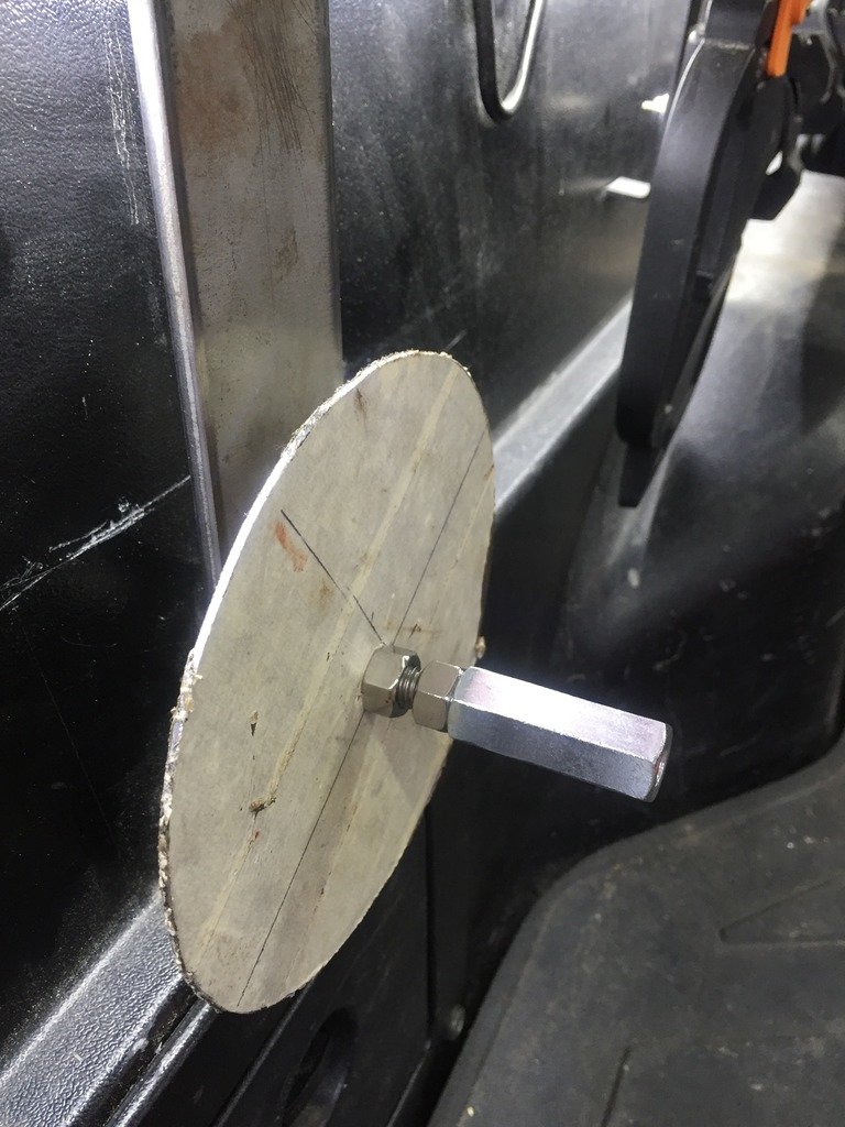

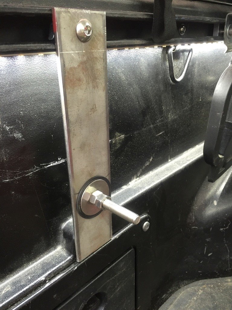

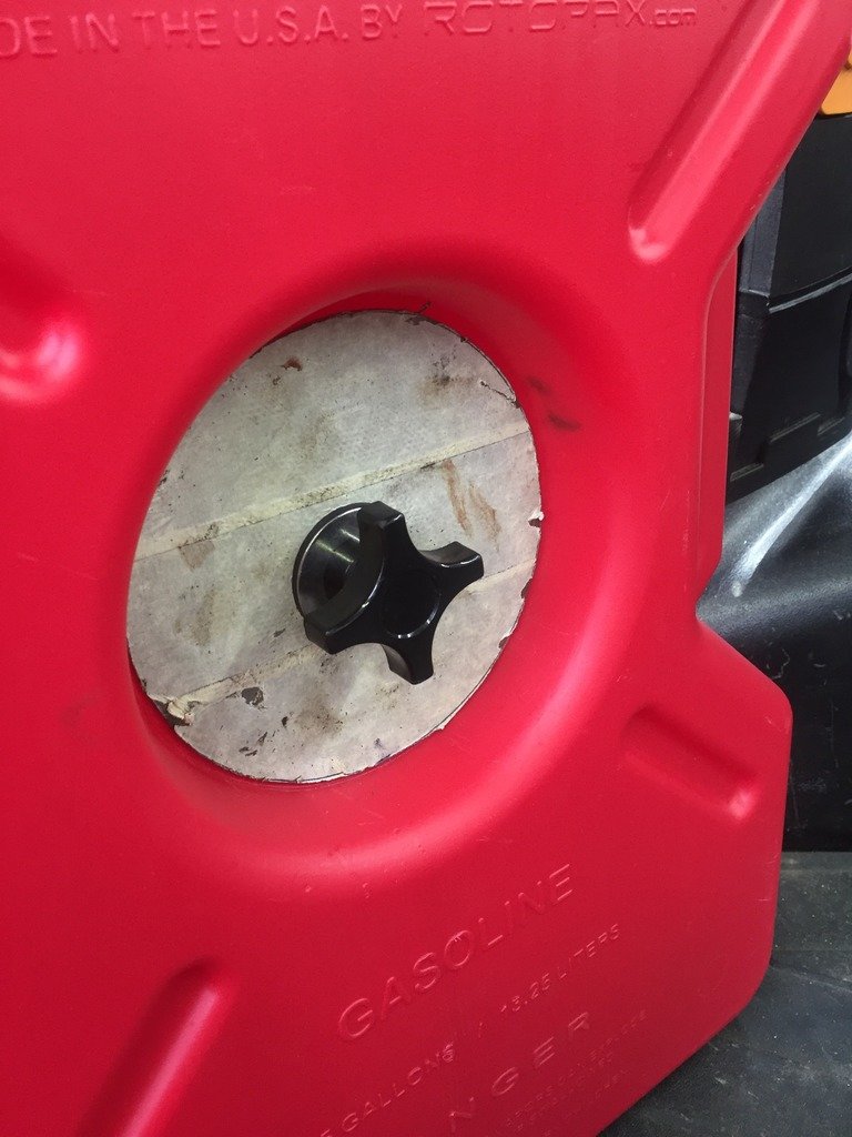

    F30F1CB1-1DB6-46D1-9B0F-9A542CFECBC2_zps_49ce3c22bb5d493b2f8a089ae0f3c0976c779d0f.jpg
    985EAD37-6A46-4812-8535-FB7F1C601828_zps_22cfb79c77ff912107ffd2e58ba1ced44754111f.jpg
    A447CCFF-6018-45CE-837F-A44E8351C24B_zps_7ecf6e1ef898b38aa1fd8c203ef53806fea2c211.jpg
    57442924-DAA1-4E1F-A379-F101E21F1255_zps_30390d28cadba37c67cd173eed435e83ba144401.jpg
    Prototype is done. I plan on adding a nutsert to the bed so I can bolt the lower side of the bracket to the bed, then it needs some paint. I may add one 1" round posts to each side of the coupler to keep it from shifting around, but I dont think its necessary. It currently filled with 3 gallons of gas and mounted. Well see how it handles tomorrows adventure

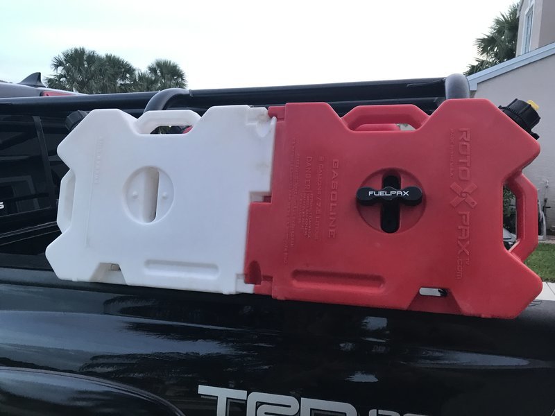

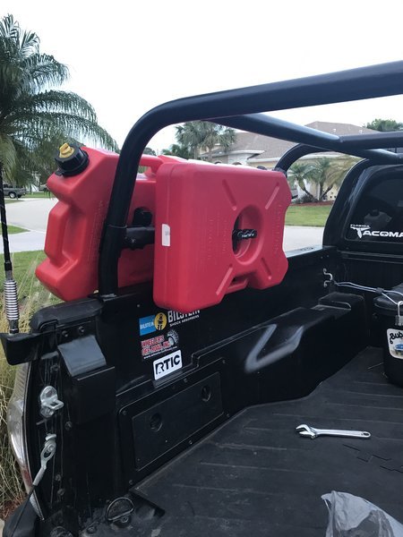

    IMG_1213.jpgIMG_1212.jpg ^^^^ looks good Matt I did this last weekend mounted 2 2 gallons and a 3.5 gallon.
