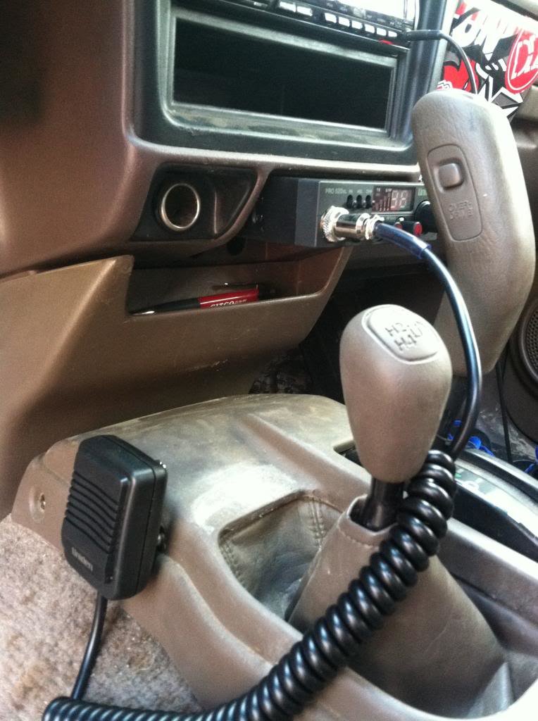

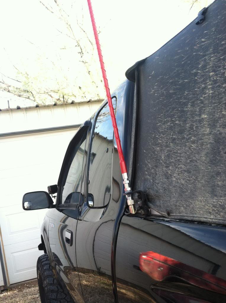

    Got my Uniden Pro 520xl CB installed yesterday!
    Fits like a glove in the ashtray slot just wish it would sit a smidge further back, but the coax cable prevents it from going in any further. Happy with it overall!
    70C3243C-A94C-49F5-8AB1-C3EE0AB75DF9_zps_bb1ac4ada279531fa51c98f3ff04a08dee63fb5a.jpg

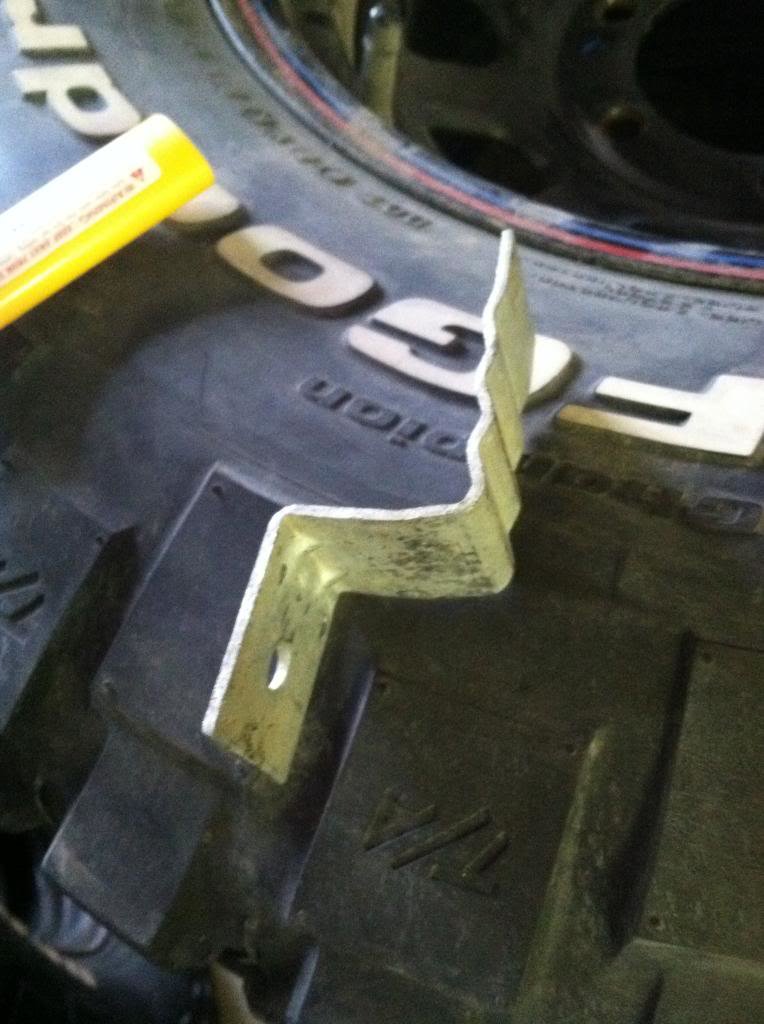

    Mounting the antenna was the most difficult part but i got it figured out in a few hours. I didn't want to order some fancy tailgate mount or have it mounted on the front somewhere so a little redneck ingenuity was required. Found this little chunk of metal:
    981CE791-ED90-451A-A4D8-BA7AA3158E9D_zps_17b29a7d64746605c0d7c97ad99e5de016118fa9.jpg
    Took the hammer to it so it would sit nicely on the edge of the bedrail like so:
    186176E8-BBE4-4067-A68E-14837E525420_zps_6dd6a594f4ee627e61ca0e6057b77431e4365c0d.jpg
    D08345CA-A509-4B9B-9543-B5DE171F6D28_zps_1237dd3613199f136a24c84c07a39b7f1ca9bd30.jpg

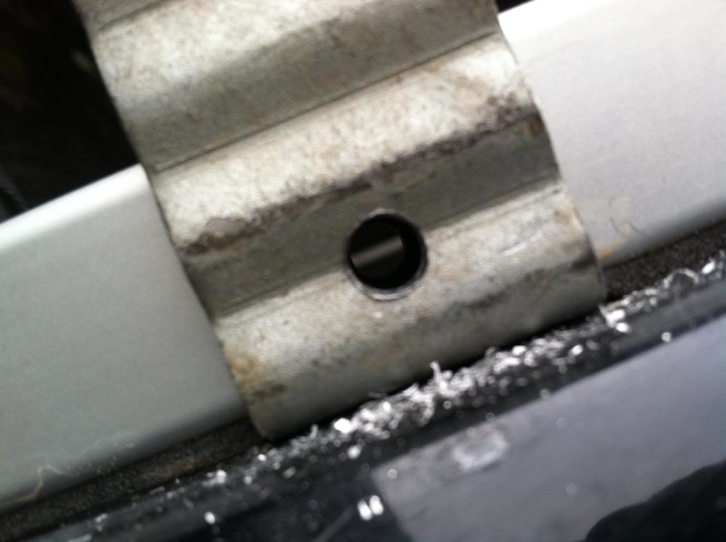

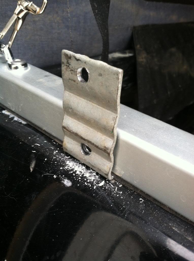

    Drilled out some holes for an antenna mount i found at the local truck stop. Lower hole goes all the way through the Softopper bed rail.
    ED984913-1557-4A99-A692-07A4577E3446_zps_56c32bf98df68fbe073358876de7eddc743ee24d.jpg

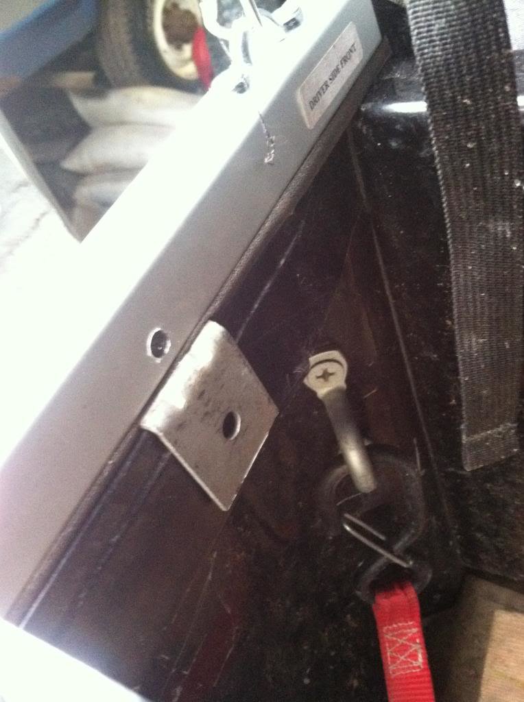

    Had to find a couple bolts to make it work but managed to piece together one long enough to go all the way through both mounts and the Softopper bed rail and a shorter one for the top so that the Softopper could be tucked behind the mount:
    CAB2E8DD-9B38-4972-BB84-091E2E6B5301_zps_b16196e464152f3bbb4d2e0c5844f24308ca97d5.jpg
    All i need to do is stick a few more washers between there so that the Softopper can be tucked in a little bit nicer.

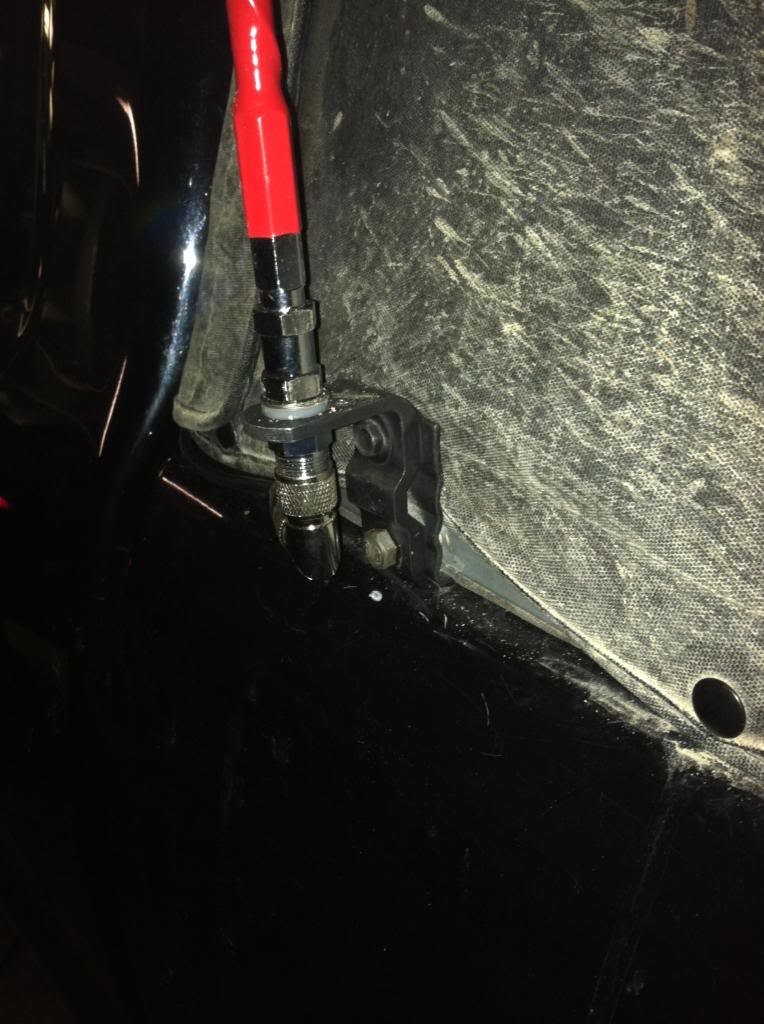

    Gave it a fancy paintjob and ran the cable and called it good! The 4ft Firestik is a bit overkill and will be even more when i put the spring on there so i'll be getting a 3 footer instead.
    287FE2F3-9309-40E7-ACC4-C2E42A4CA2A6_zps_c10137efa65d5ae415d34433bd52f3da911bac25.jpg

    Just stick with the 4 foot. You'll get used to it being out there. Wait till you see Montes height haha.

    Yeah im gonna stick with it for a little while it'll probably grow on me. My dad is planning on getting a CB so if i find that i don't like it i'll get something a bit smaller and trade him the 4 footer. I'm gonna go to town and grab a spring for the antenna it if you wanna meet up soon?
