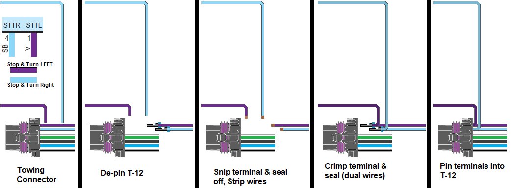

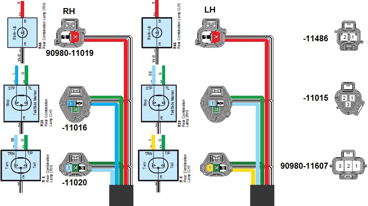

    Original Stop_Tail_Ground provides Tail & Ground.

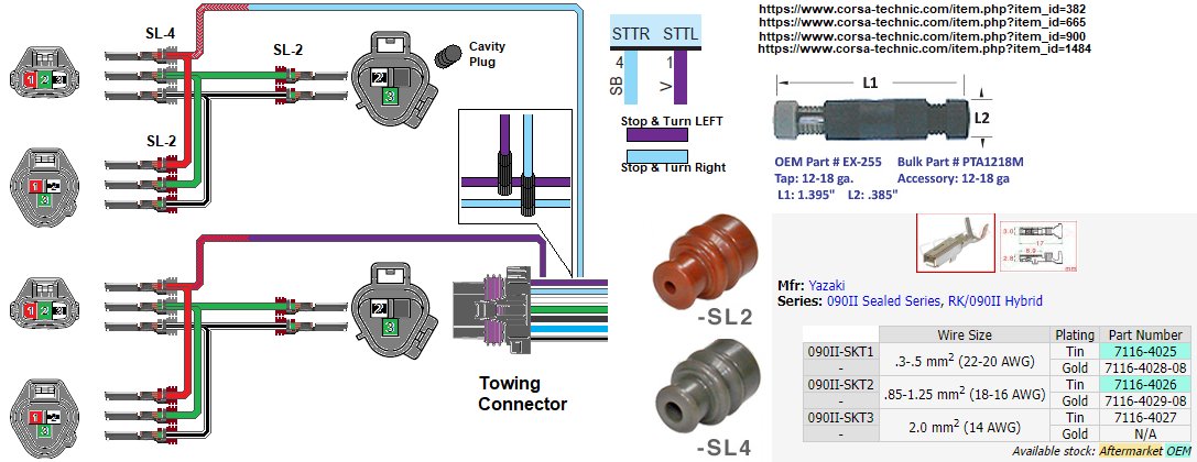

    Posi-tap to T12 Towing connector wire 4 (Right Turn/Stop) and wire 1 (Left Turn/Stop)

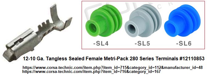

    Also, T12 can be disconnected, wires de-pinned, sniped, stripped, crimp with dual wires and seal. Inserted back to T12.
    Or fancy n expensive, parts can be purchase to assemble a intercept harness. Or even a 5th Wheel T harness can be used.

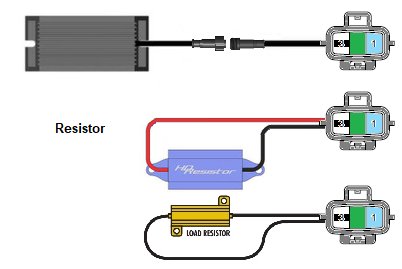

    Original Turn Signal Resistor add.
