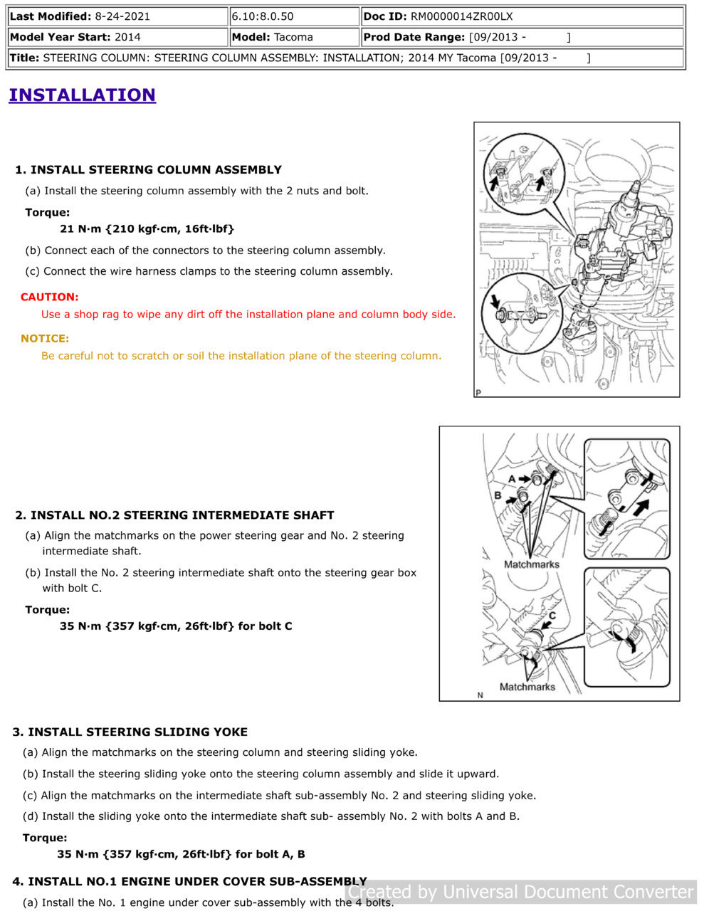

    I suppose I am more concerned about making sure the right torque goes back onto the bolt when done. Good point about the clock spring. Thx.

    Looks like 26 Ft/Lbs
