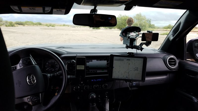

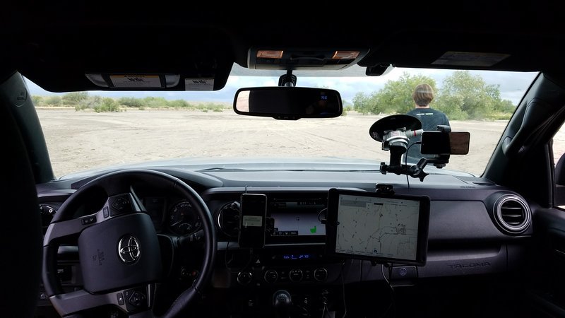

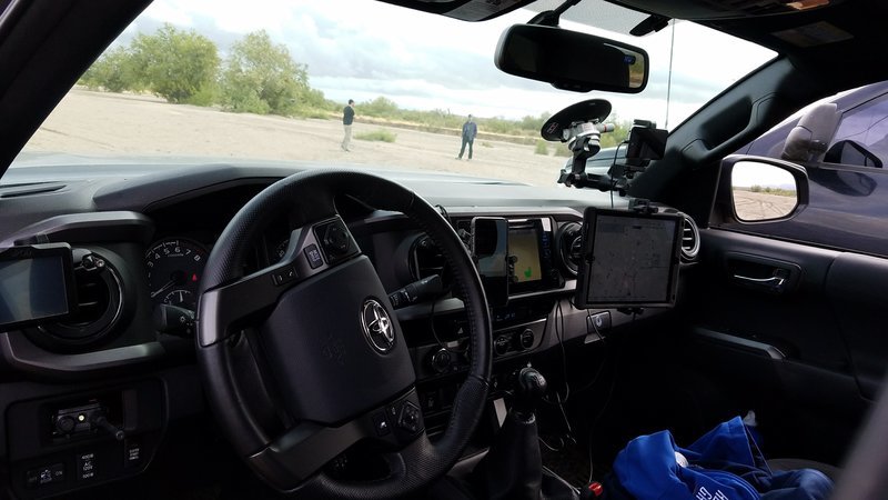

    I'm using 3 of the Hondo Garage Un-Holey Dash Mounts that clamp inside the vent rings. The leftmost vent houses the sPod Touchscreen which conveniently has a RAM ball on the back of the screen, and easily attaches with a short arm Ram mount to the Hondo Vent Mount. I ran the sPod network cable through the firewall and high enough between the door and dash so that it would not get squeezed when the door was shut. The other two vent mounts are being used for Hondo Perfect Squeeze Phone Mount (for my smartphone) and the Hondo Big Squeeze tablet mount for navigating with Gaia GPS and/or Avenza Maps, both of which have proven to be extremely useful as well when out of network service areas. By the way, these vent mounts combined with the 3rd Gen OE vents are a STOUT combo - this is truly the most robust way to mount some weight from the Tacoma dash without modifying the dash or feeling like the dash is going to rip apart on rough-roads at higher speeds.

    A lot of people prefer the positive feel of "actual switches," and I would probably agree if I had front/rear air lockers on my rig in which case I was flipping switches on and off often, but I am perfectly happy with the Touchscreen for my application, especially given the convenient location of where I mounted the screen: it's so easy to see the buttons without taking your eyes off of the road (and most of the time I'm not using the buttons on the sPod while on the road, the compressor and Fridge are occasional-use accessories).

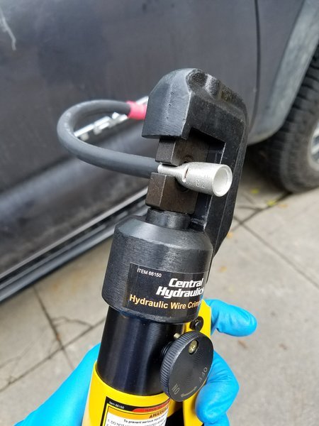

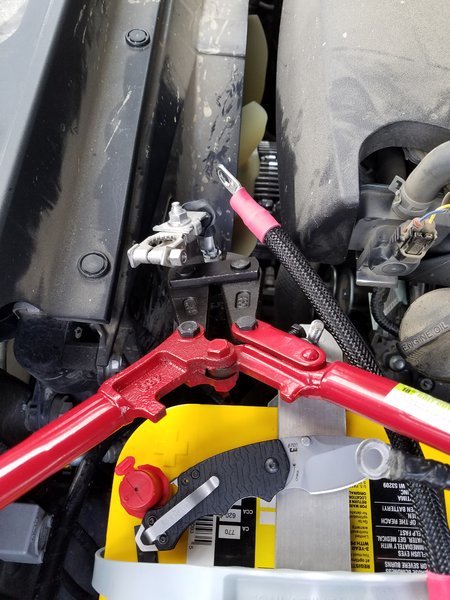

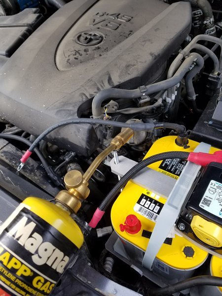

    I drilled a few holes in the lid of the OEM fuse box to mount the sPod per the instructions, I was hesitant but this really was the best/only place for me with the ARB twin compressor and 1-Gal air tank in the passenger firewall corner, and the twin Optima's in the driver front corner. The off-grid engineering dual battery kit is 100% complete and robust. I also emailed Matt Carter at Off-Grid a few times before the purchase, and he was extremely helpful as well with the wiring setup. I went with two Optima Yellow Top D35's despite some public knowledge of Optima quality degradation, I have always run Optima battery's in all of my off-road rigs and my daily drivers without an issue, so I stayed true, and so far they have been great. Note contrary to many other setups in my picture below I actually have the battery on the left powering everything in the entire vehicle; it is the starting battery and the accessory battery. The main reason I wanted two batteries was for emergency starting, so the battery on the right is always isolated and protected in the case of emergencies, yet it sees a charge from the alternator to keep the battery healthy thanks to the Blue Sea Automatic Charging Relay.
    The Off-Grid Install was easy with the right tools.

    Nice write up, how did the tablet fare while off-roading? Any Vibes?
