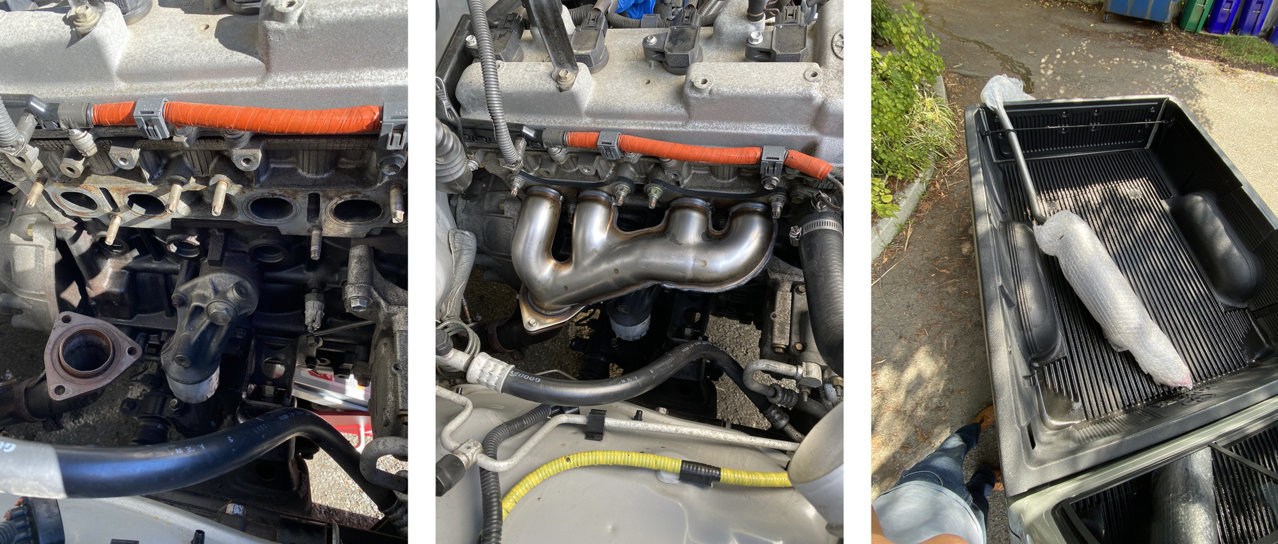

    Bay Area, California
    2002 Tacoma 2.4 5 Speed
    Rims, 4600 Bilsteins, K&N filter
