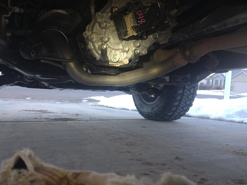

    Do you have pictures of this? I'm having a hard time understanding what you mean.

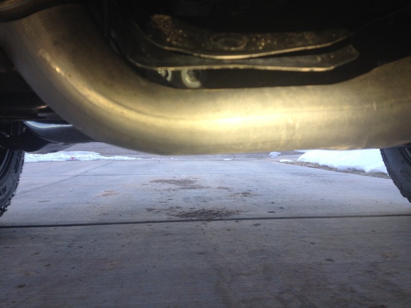

    Toyota smashed the top and bottom of this driver side pipe to fit under the transfercase now you can get a skid plate to work with it but it has a huge hang up spot on the skid plate but if you want a flat belly that pipe has to be rerouted behind the transfercase so we are gonna go about 4" behind that black plastic box on transfercase so it doesn't heat it up and melt it that driveline section right there in the pic is a mid section it doesn't move up and down so it won't hit the new pipe

    Very nice that's the same thing I'm gonna be doing idk why they smashed all the stock exhaust up they didn't mandrel bend anything hopefully it will flow nicely maybe pick up a few horses with that straight thru muffler and mandrel bends if not oh well it will sound good
