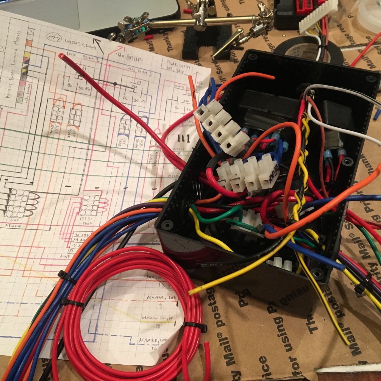

    I put 2004 Double Cab Limited door components and wiring into my 1997 PreRunner SR5.
    I had to make a whole custom retrofit system to adapt to the factory door harnesses.
