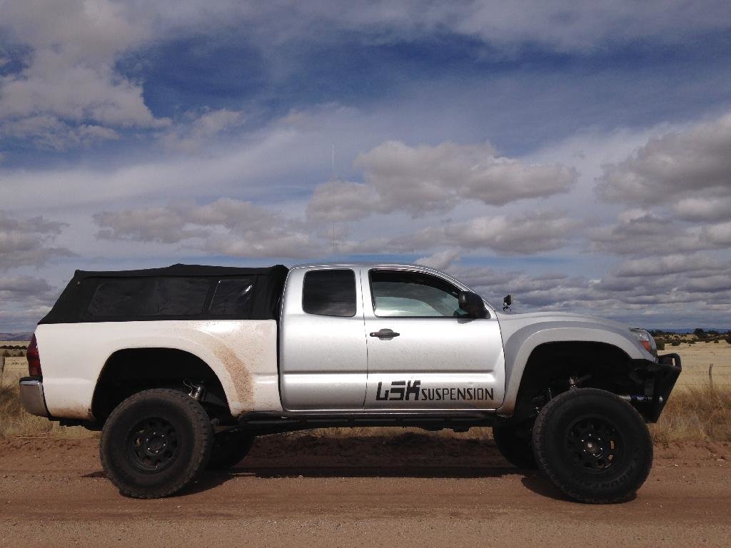

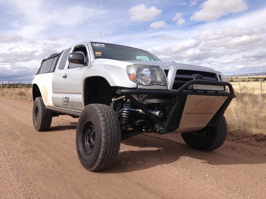

    Id go LT if you don't mind checking the bolts every few weeks for torque specs, dealing with a wider truck, ect. It costs a little bit more in the end but its worth it and complements rear LT very well. With a mid travel set like Tom's (Airdog) you get way better dampening but you only gain an extra inch or so of actual wheel travel (8-9"), with long travel, you will run from 14-16" of front wheel travel. I will say, it is a pain to get glass, mount it, paint it and remount it but the end product is amazing. Im still currently in the process...

    And the installation is pretty much the same minus getting glass and getting it painted. Full MT has uppers, lowers, bumps, bypasses. IMO you are really just choosing how much travel you want, if you can handle a wider truck and if you don't mind buying fiberglass.
    Granted, it also depends how hard you drive your truck. As far as maintenance id say LT is a little more expensive but not by much and that's only considering you utilize your LT to its fullest extent when you go out.
