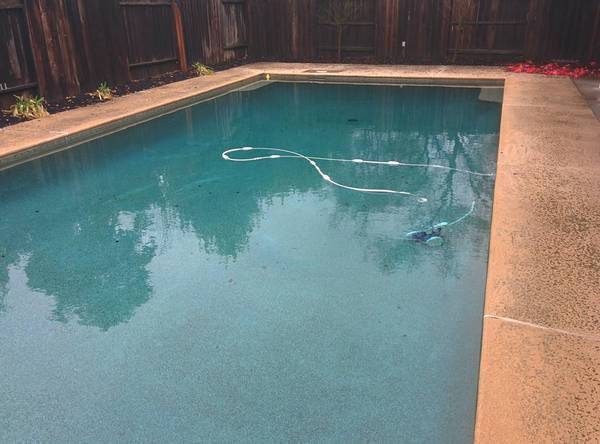

    I just bought a house with an underground pool and the recent rains have brought the water level to the grout line where the tile meets the concrete deck. Do I need to drain the pool of water with more storms on the way, or can I just let it be? Any harm in not draining the pool? Do I just run a hose to my garage sink, or the street?

    Drain it! You should have a valve near your pump... If you're not sure about it, call a pool guy to help you.

    Just don't drain it dry! You need the weight of the water to keep the pool in the ground. Saturated ground water around the outside of the pool can make a pool react exactly like a boat. The groundwater will push the pool right up. You definately don't want that to happen.

    No intention of draining it dry, just wondering if I should drain off 4-6 inches so it doesnt overflow. Is there any harm in it overflowing from rain water? Had the house for about 3 months and the water level slowly went down due to evaporation due to the drought here, definitely not filling the pool with an auto feeder. This is our first real storm of the season.
