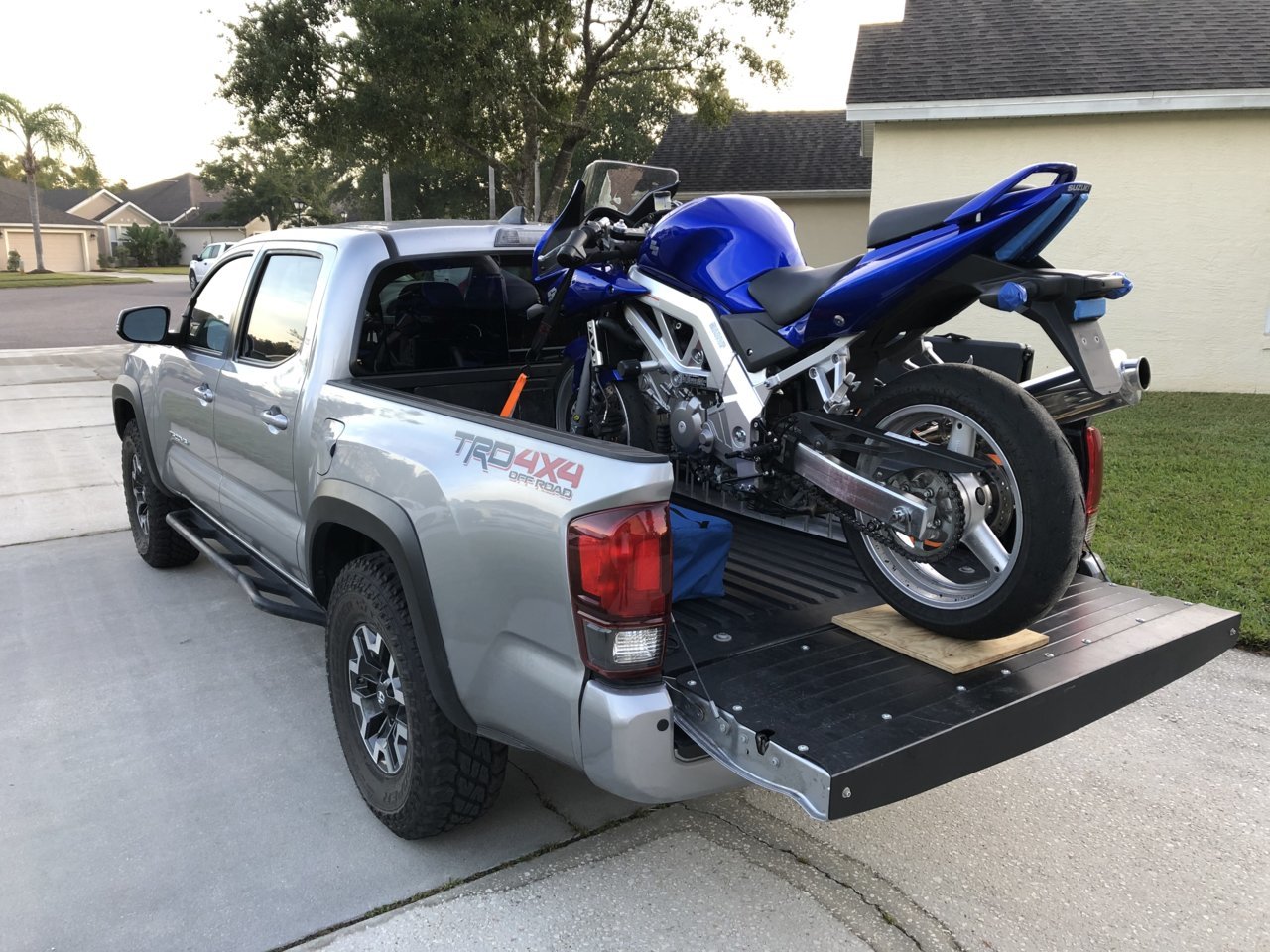

    I use this to haul bikes in my truck 2 tiedowns to the chock to hold the bike up and 2 more to the eyes in the front of the bed to keep it from sliding out of the bed. I also leave the bike in gear

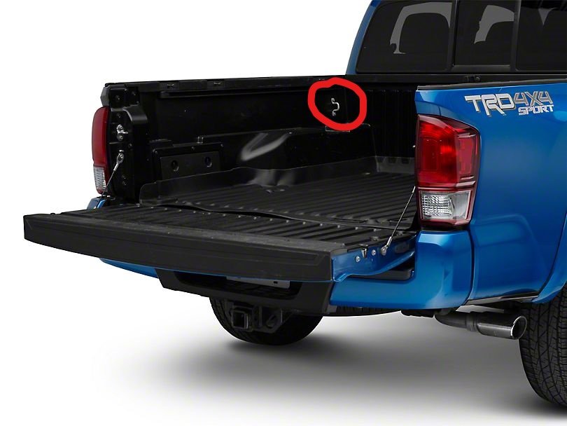

    I haven't used the tiedown points circled in the pic much, yet, but I've tied down 500# bikes using the mounts on the channels and the D-rings on the bed by the tailgate. I think if you tie to four points you'll be fine.
    Honestly, though, I thought those galvanized tie downs bolted to the side of the bed were something the dealership did until I started seeing them on almost every truck. They look like a cheap afterthought and I'm not sure how much I trust them by themselves.

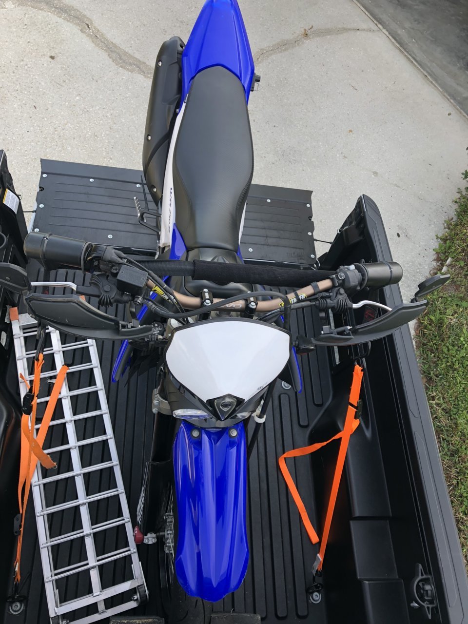

    Those mounts only go through the composite bed. Buy two d-rings and replace the two front bed bolts that go through the frame. I’ve hauled all my bikes that way with a cheap home made chock to keep the wheel from turning. Two straps and some canyon dancers is all it takes.

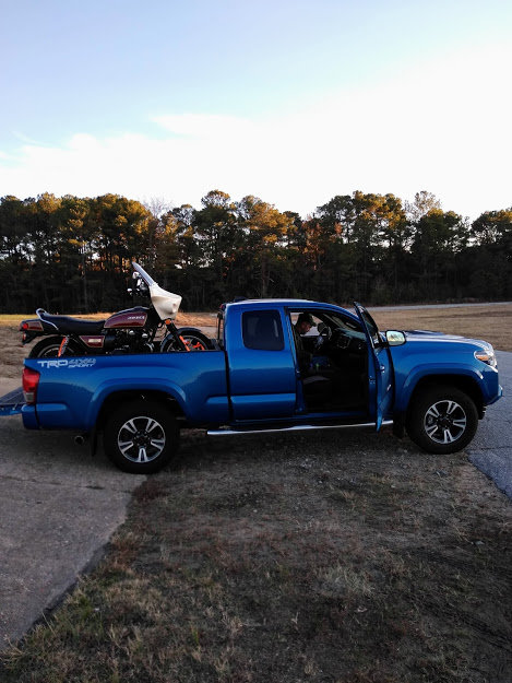

    600 miles using the tie down points in the front corners and the ones on the floor at the rear of the bed. Suzuki GS850G at close to 600 pounds. Drove from Ft. Story in Virginia Beach to southern Ohio, bike and truck did great.
