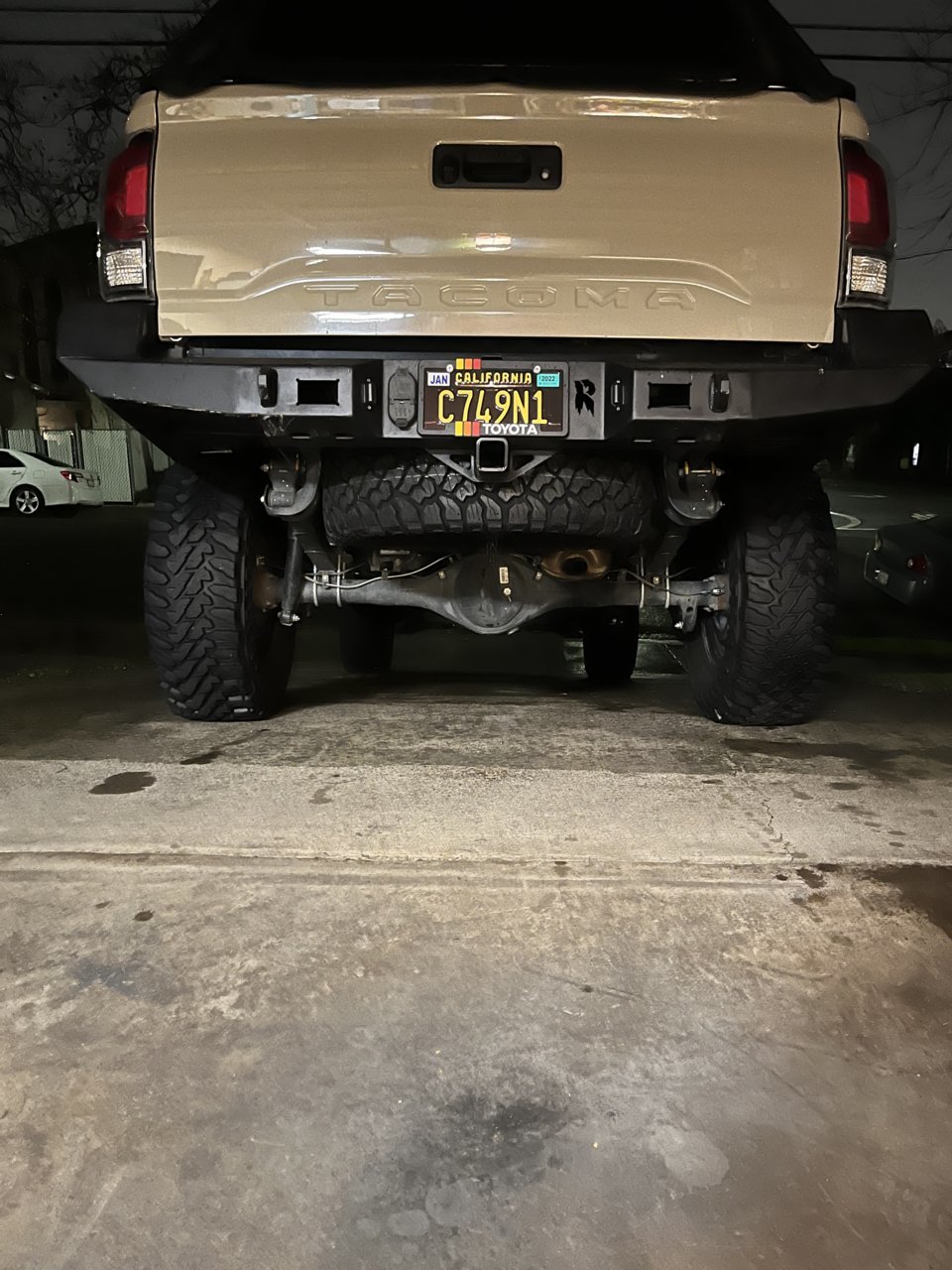

    You can technically run a 35 in the spare spot with a little work. I run a 35x10.5 in the spare location because it doesn’t hang as low as a 12.5 inch tire would. I leave it aired down and in the event I ever need to swap it I have a compressor. Also I have an aftermarket bumper, idk if it would work with stock.
    Not for everyone but it is an option

    The skinny 35 is a good call for the spare. My biggest concern would be the exhaust being so close to the tire. I cut mine to dump over the axle, so I dont think it will make contact, but the heat will be beating on the tire unless I reroute it or something.

    Ya I have the AFE rock basher which dumps before the axle
