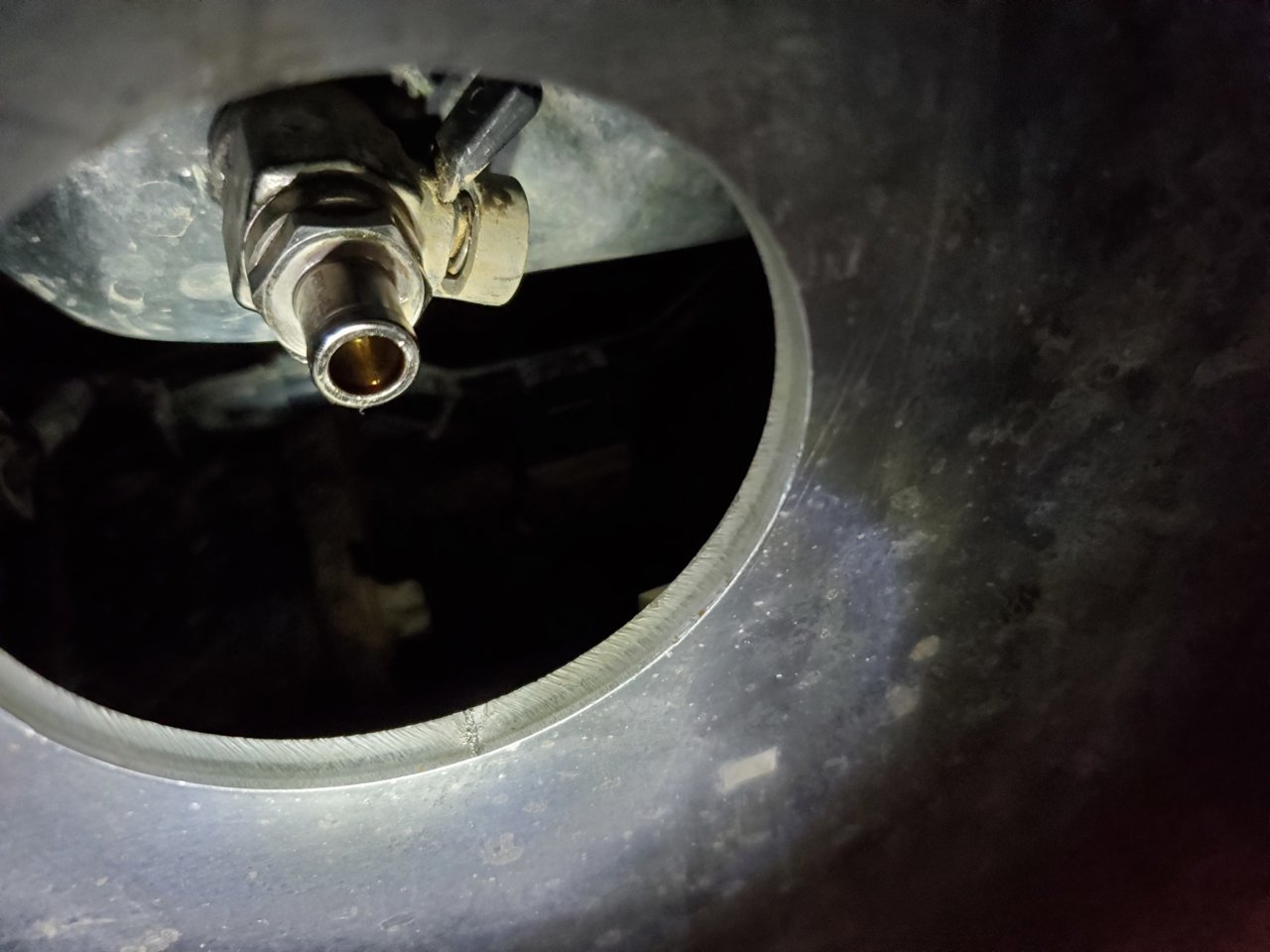

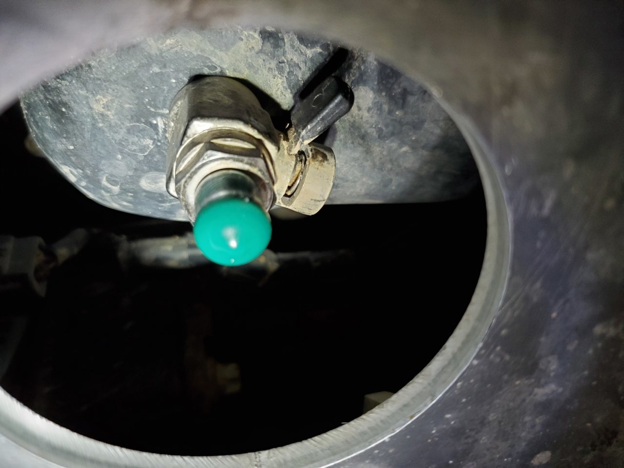

    I second the idea of a fumoto/ez valve. Makes oil changes much easier. Stick a short hose on it and flip the switch. I keep a small vacuum cap on mine to keep dirt from clogging it up, works flawlessly.

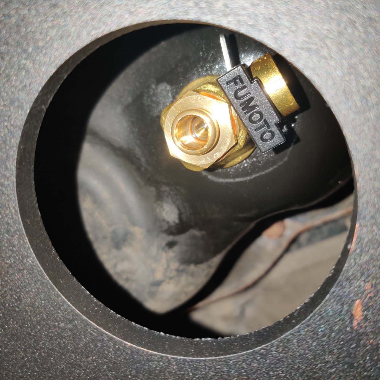

    Thanks for the vacuum cap idea; I just installed the fumoto with the RCI skids. Wanted access to the oil filter without having to take out the OEM skids.

    Cheap insurance for ~50cents

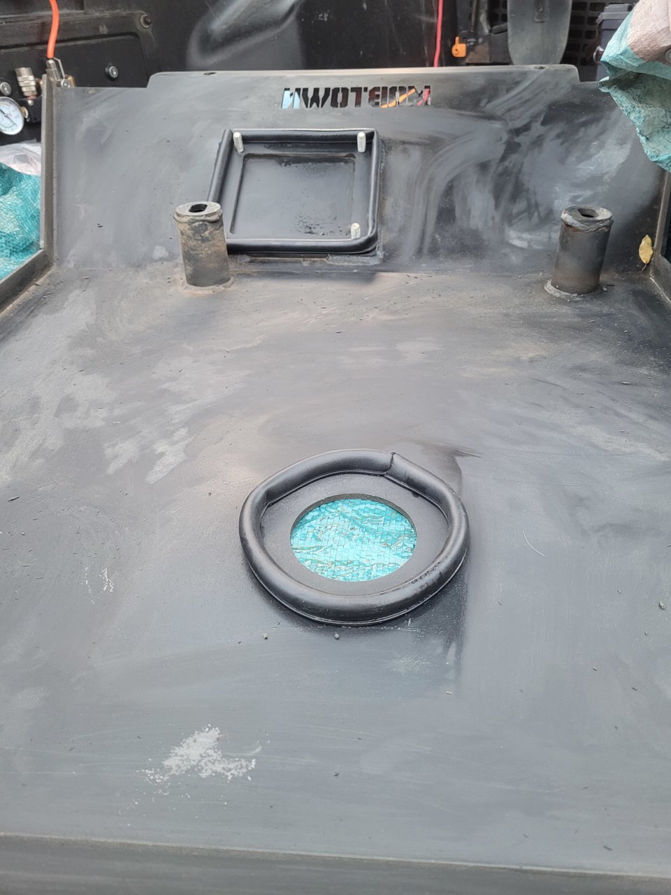

    With a skid, I doubt anything could get to it to damage it where it is dumping oil. I had one on my truck and recently went back to regulate plug. It started to leak on me and the time it takes to drain is significantly greater.
