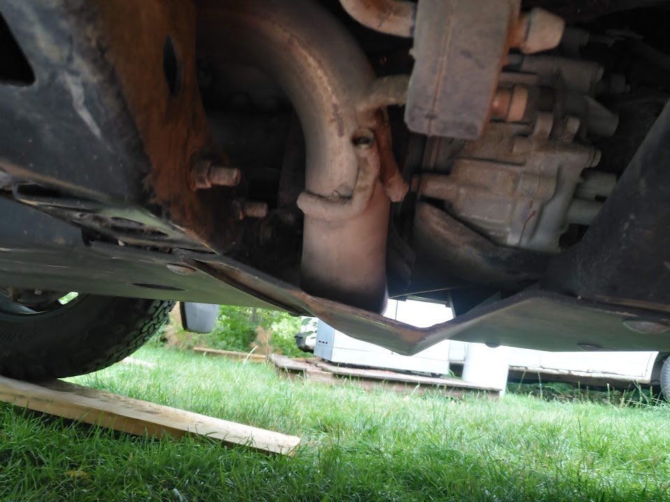

    Slight shift in topic...regarding exhaust cross-over pipe and skids. I have a question about RCI skids specifically and it may apply to skids in general.
    If the skid fits OEM configuration of exhaust (cross-over not re-routed/raised) what's the point or fixing/raising the exhaust if the skid will be low enough or formed to have cleared it anyway?:notsure:

    RCI sells two skids. One completely flat one for those that have rerouted and one that protrudes down for stock exhaust config...HTH

    The flat skids are preferable to the dropdown for the exhaust crossover because it creates a completely flat bottom skid surface, which makes it much easier to slide off of rocks. The exhaust crossover and bump out in the skid plate give a point for you to get stuck on a rock. I have plenty of gouges from the front of my engine skid to the flat rear transfer case skid and have never gotten hung up, but I'm sure it would have happened if I didn't reroute the crossover. The crossover is also the lowest point underneath the truck, minus maybe the differentials, so eliminating that low point is a bonus offroad.

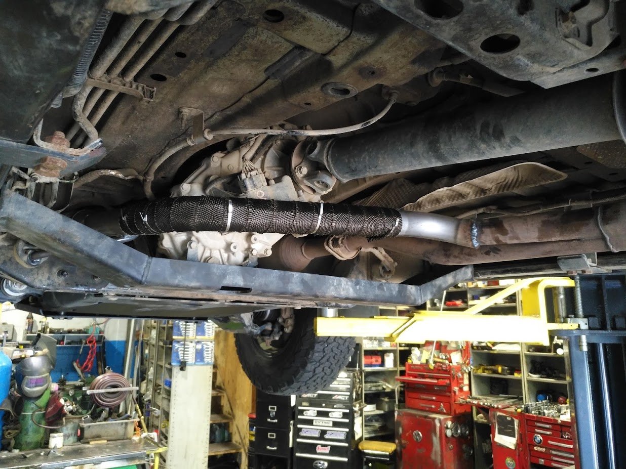

    Who can and how much for exhaust re-pipe?

    Ask a regional forum on here- if you’re in the GTA (Ontario) Sumin Auto will do it, and do it well.

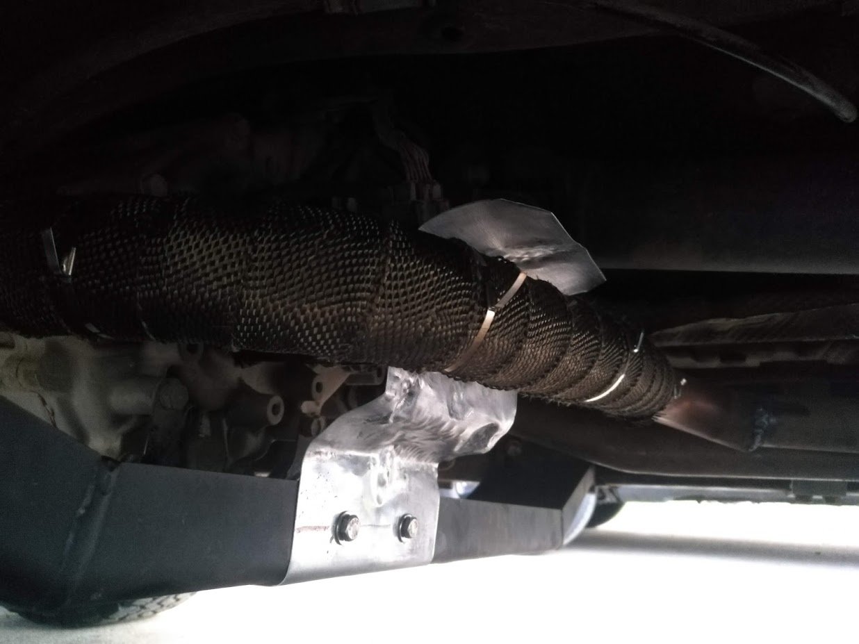

    It protects your stock exhaust. Can't hit it and tear it off if you move it out of the way
    Garfab wanted to make a Weld-it-yourself kit, dont think he ever did one of those.
    mine was a little close to the box, so we just wrapped it in heat tape and i bolted a piece of metal to act as a reflector. pretty sure that reflector is long gone by now

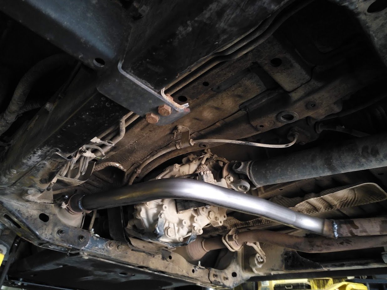

    find any exhaust shop, tell em to make it look like this:
    super good enough
