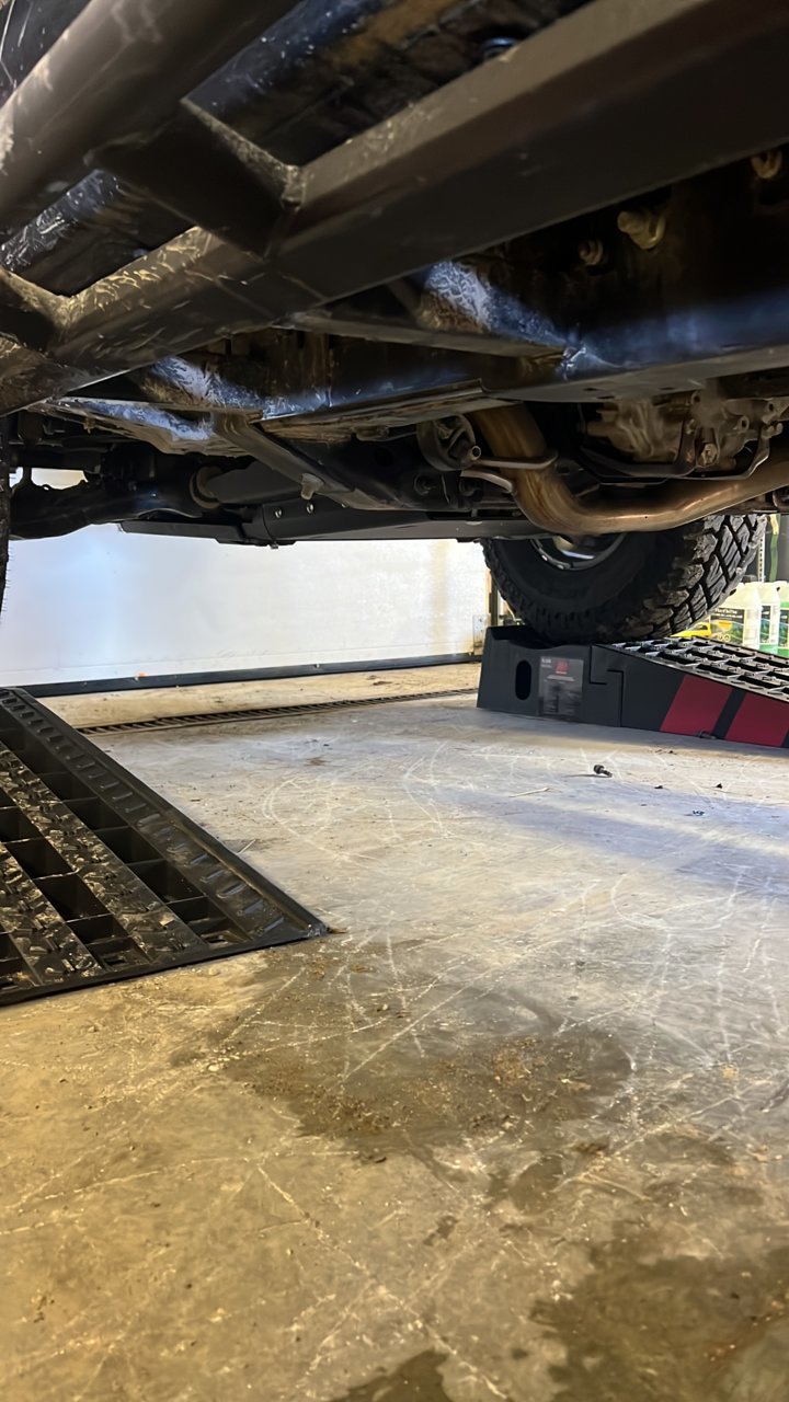

    Also- RCI Transmission skid is installed now. I will keep this updated if I have heat issues, but I doubt I will.

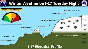

    I've never overheated with my full set of mobtown steel skids. When i travel up north from Phoenix to Flagstaff I leave it in S3/S4 holding 70mph+/5k RPMS for 15 minutes straight in 120 degree heat up a huge grade (see chart below) with 33" and a ton of weight and never had a problem

    There is a sign on I-17 just before that upgrade ... "TURN OFF AC TO SAVE ENGINE".
