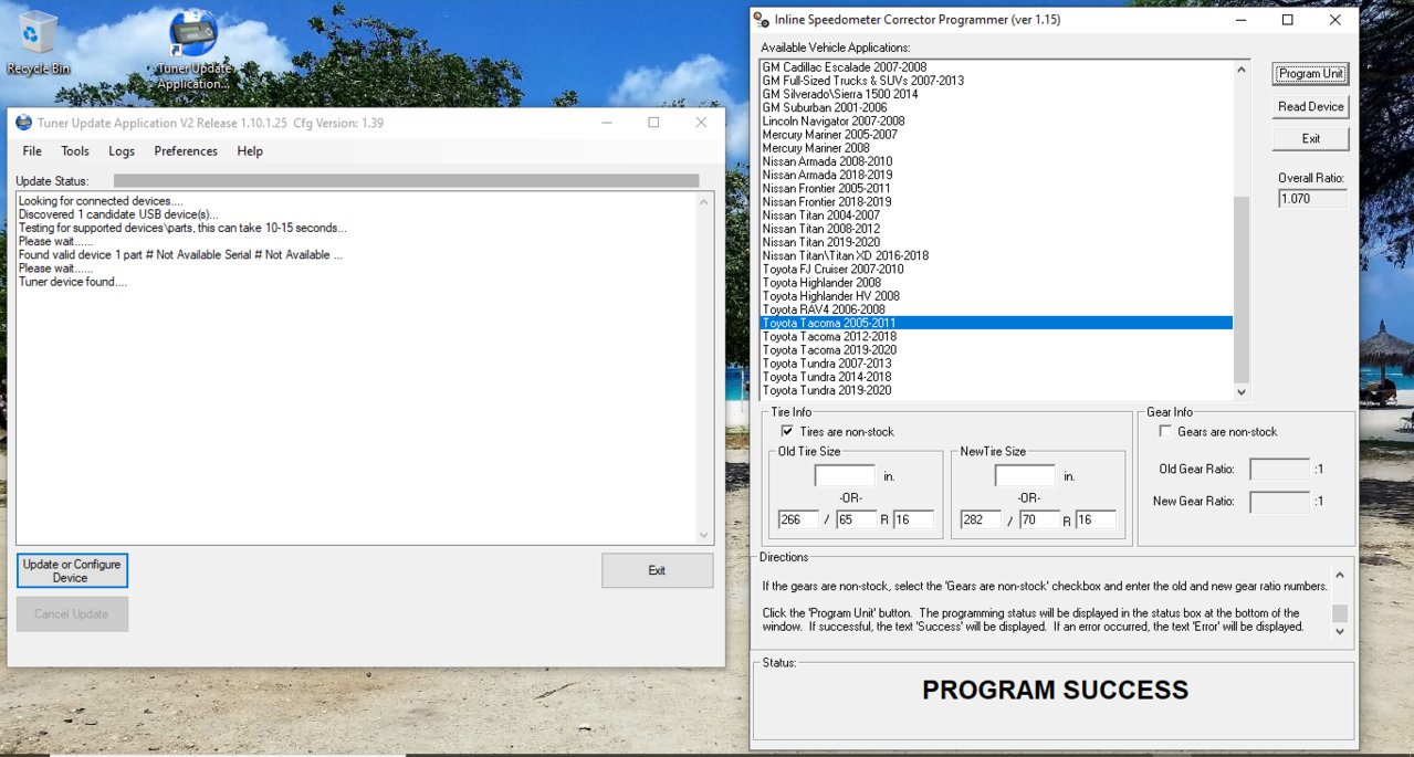

    I recently purchased this and here is what I had to do to program it

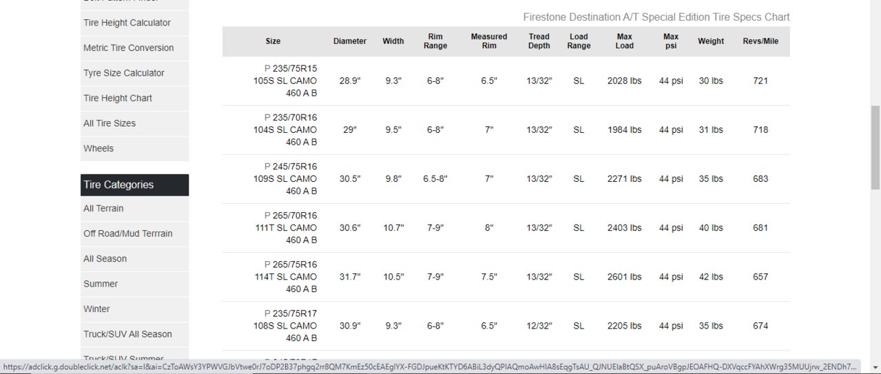

    my previous tire was a 265/70/16 firestone dest at2 camo with 681 rotations per mile

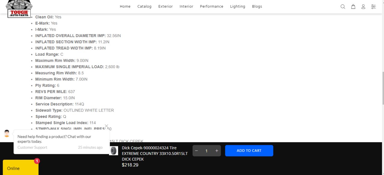

    my new tire is cooper at3 xlt 285/75/16 with 637 rotations per mile via same size as Dick Cepek 32.56 in tire
    681 / 637 = scaler of 1.069 difference

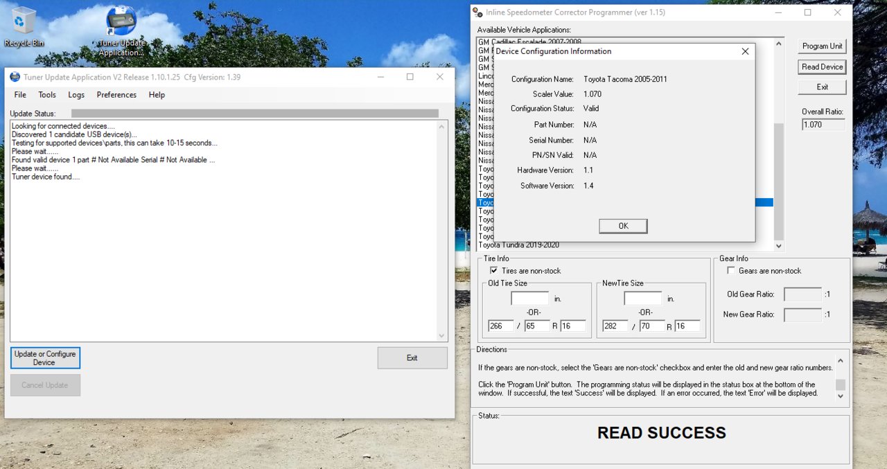

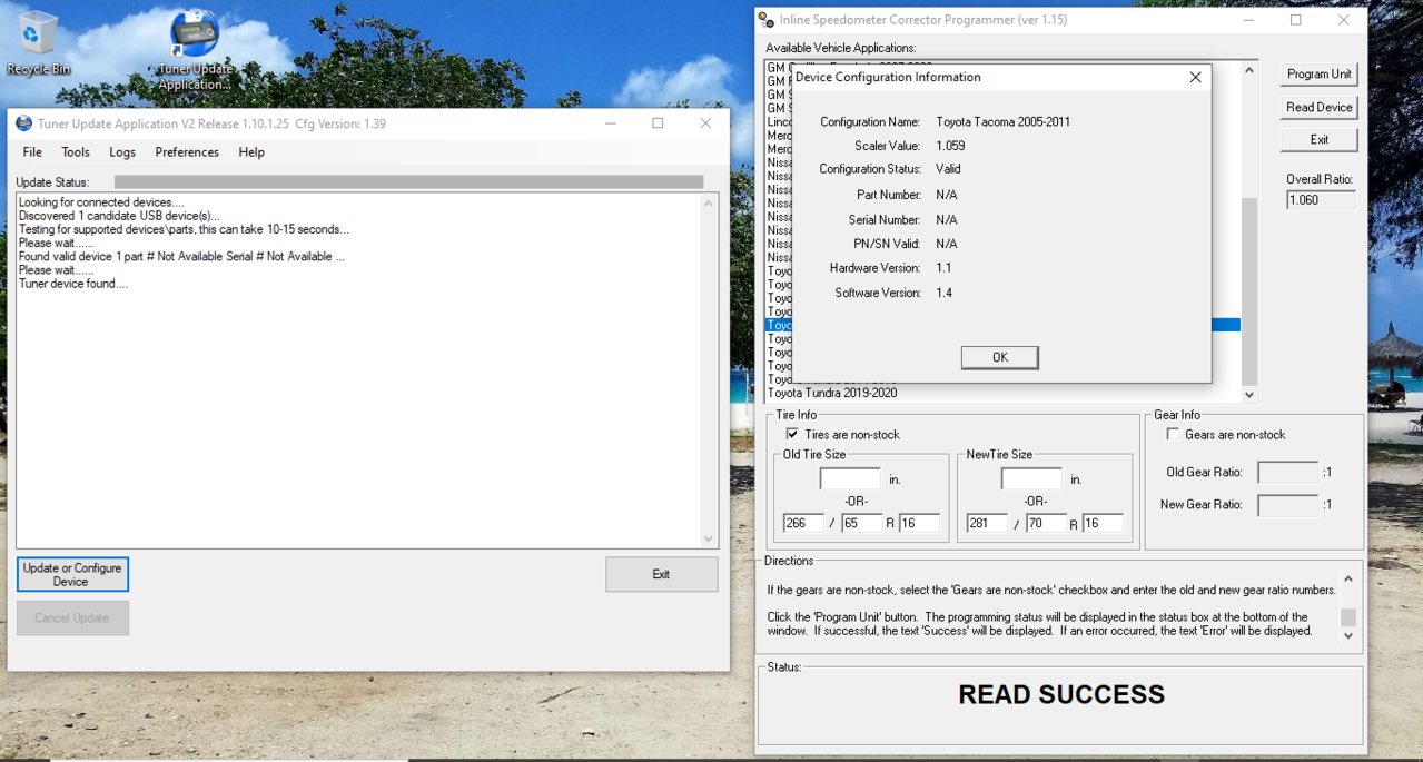

    I was able to modify the size of the tires to get to either a 1.059 or 1.07 scaler
    I went with the 1.07 scaler as its closer to 1.069
    I imagine it will show me a slightly better MPG and Speedometer should be slightly faster.
    Will be installing over the weekend so I will get back and update but does this logic of measuring rotations per mile make sense? I'm open to ideas and criticism if I should be doing it another way
