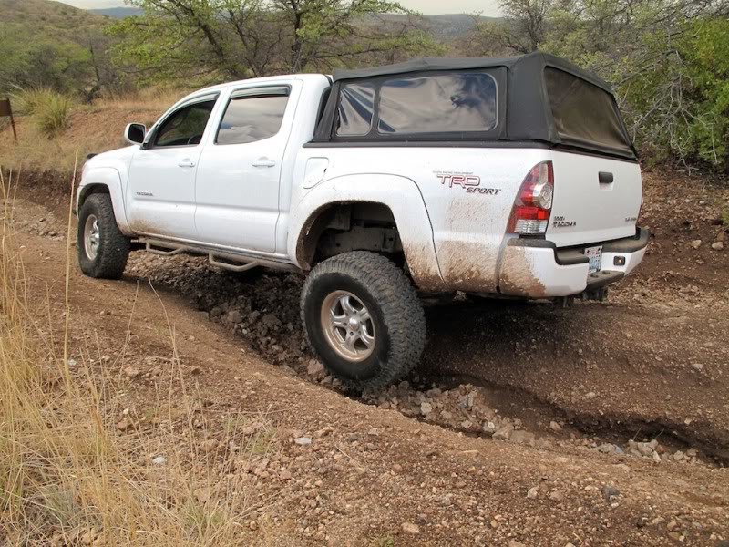

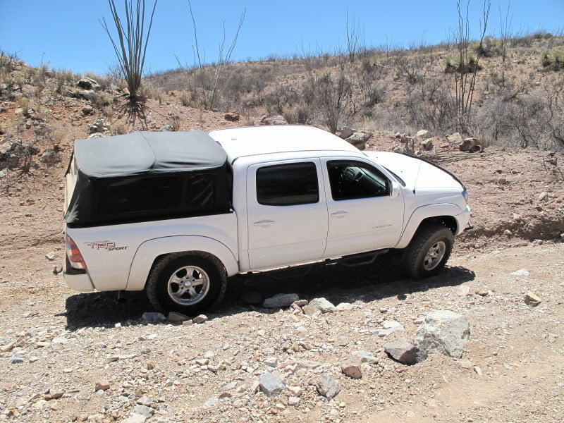

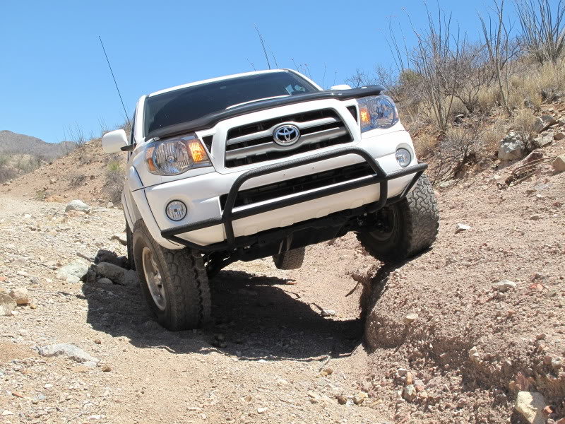

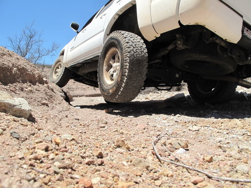

    I already have a bit of travel/flex out back. I am currently running 4 leaf pack TSB + Toytec AAL and 5100's but I think I am maxing out my 5100's. Talking with a couple shops this setup would give me even more articulation and another 1.5" of lift ontop of the 2.5" I have already. So by switching to the expedition leaf pack would be about 4" of total lift or about 3-3.5" with an armored rear bumper.
    Here is my current flex:

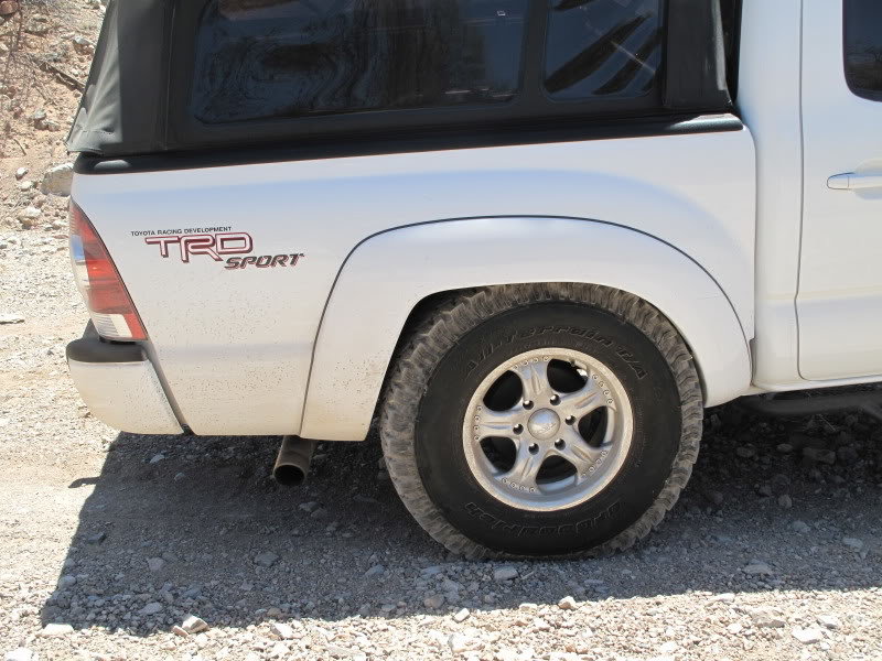

    They are starting to come off. Both of my rear fender flares have worn through the plastic around the bolts and have started popping off around the front arch and my front passenger flare has popped off the first two forward tabs.
